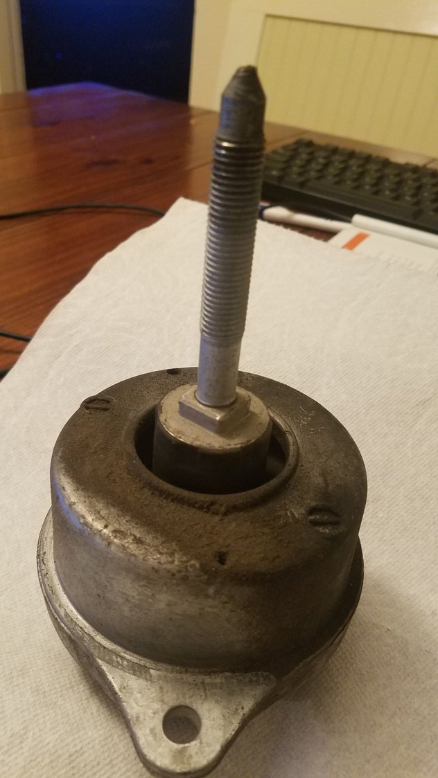

I assume you are talking about the 18mm (16?) nut that goes on this?
Here a pic of a 997TT mount.. maybe the entire part of the mount is spinning inside the outter casing? See the square indentation at the top? (bottom in the pic) That should sit into a cutout on the engine carrier to keep the mount in place.. Near as I can tell, the shaft of the mount is the same part as the square mounting.
Maybe when you undid the top-side bolts, could the mount have lifted slightly out of the indentation, allowing the shaft to spin?
Might be worth checking..
OP, this is exactly what's happening. The engine carrier needs to stay tight against the underside of the motor mount with the squares engaged to be able to loosen the nut. Hopefully, you haven't bent or rounded out the square in the carrier or its going to make this job a challenge this and future times.
