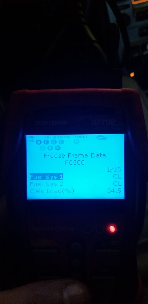

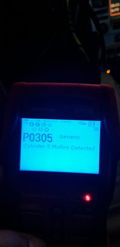

Hello everyone I've been having an issue with the CEL flashing My cheap reader shows me P0 300 P0 304 305 306 I have replaced all coils spark plugs new injectors and all new solenoid on bank2 Took it to the Porsche dealership or they could not find any issues with the car Any thoughts would be greatly appreciated

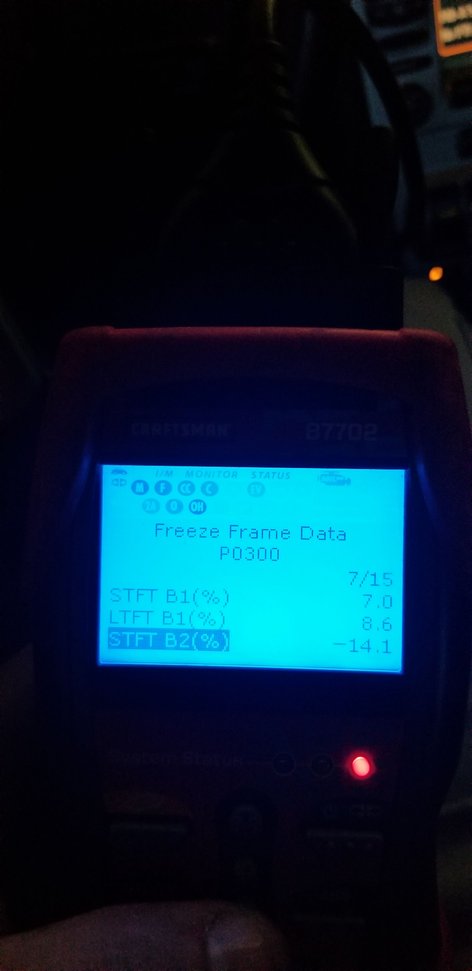

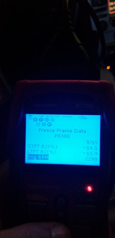

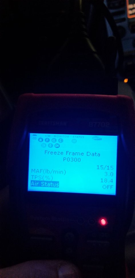

Thanks for your response. The car is still at Porsche thy want to keep the car for a few days to see if CEL will come back on. It takes about 3-4 times to Flash for about 4-6 sec each time before it stays on.
can a bad catalytic converter cause the whole bank 4,5,6 to Misfire? When the light flashes no symptoms or power loss with the car. When I took the car in my cheap OBD reader had codes p0300 p0304 p0305 p0306, after thy did a Diagnostic and running test they can't find anything wrong with it. I dont have much info about the car all I know it was sitting in the garage for 3 years I was hoping after everything was changed out on bank 2 it would work but we're still having multiple misfire

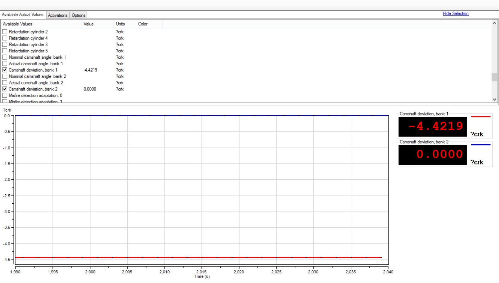

They need to focus on items that are specific only to Bank 2, such as:
  1. Intake leak at the plenum or intake manifold on that side (might get a rich or lean CEL with this one too as well as the misfires)
  2. failed catalytic converter on that side (unlikely or you'd get O2 sensor errors too)
  3. Bank 2 Camshaft Position Sensor (this is most likely the culprit - just changed mine on Bank 2 last month for the same reason)
  4. Variocam Plus Sensor for Bank 2 - also a possibility. If the CPS sensor on Bank 2 is reporting data, look here next.
They can easily check if the Cam Position Sensor is bad, by tracking live values with Durametric or their PIWIS computer and looking at Camshaft Deviation for Bank 1 and Bank 2. I bet Bank 2 shows all 0s like mine did, which means the sensor is no longer picking up the camshaft revolutions and reporting the position to the DME, which controls spark timing and why you're getting misfires.
See how Bank 1 is reporting but Bank 2 is not...
BTW, the flashing CEL is only a major issue if it stays flashing, not if it flashes at first and then becomes solid. These are also usually yellow warning messages - if you ever get a red one, that's a different story.
