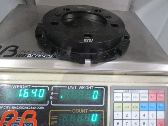

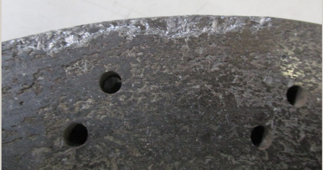

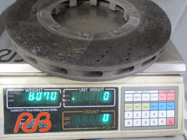

Here are some pictures of disc, hat and hardware weight. OE hat is of stainless steel.
Chipped edges
