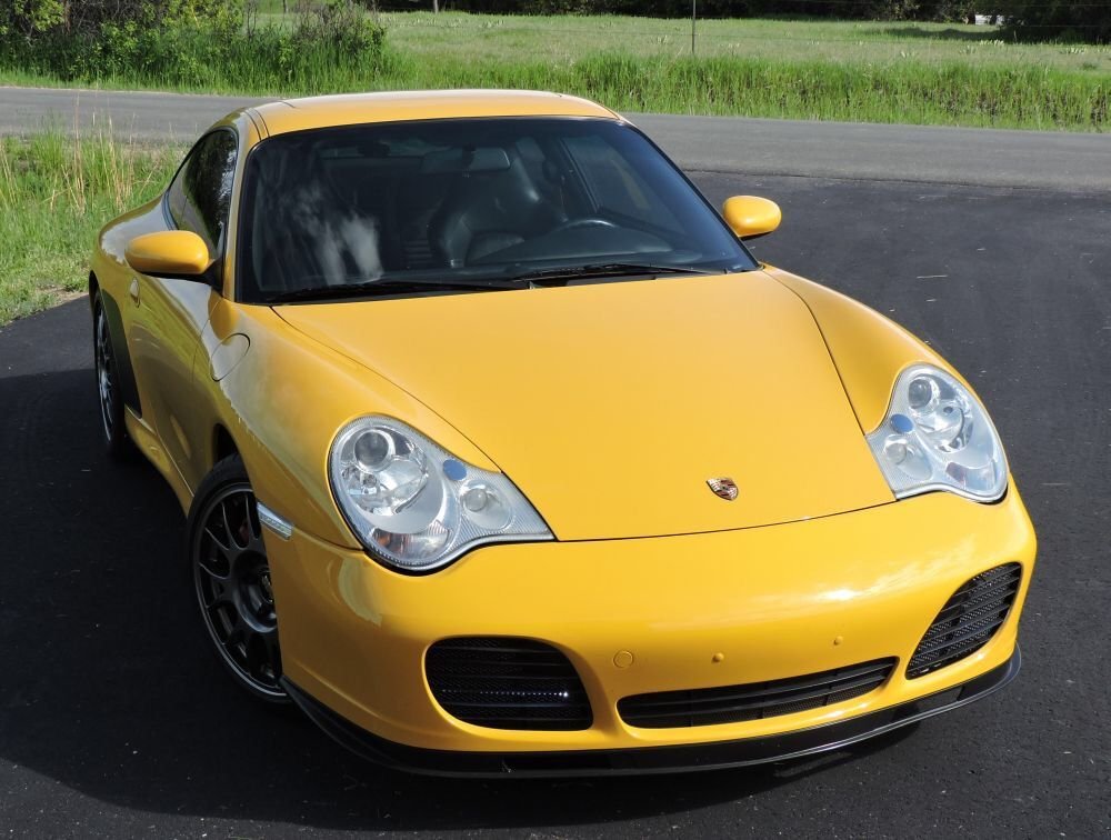

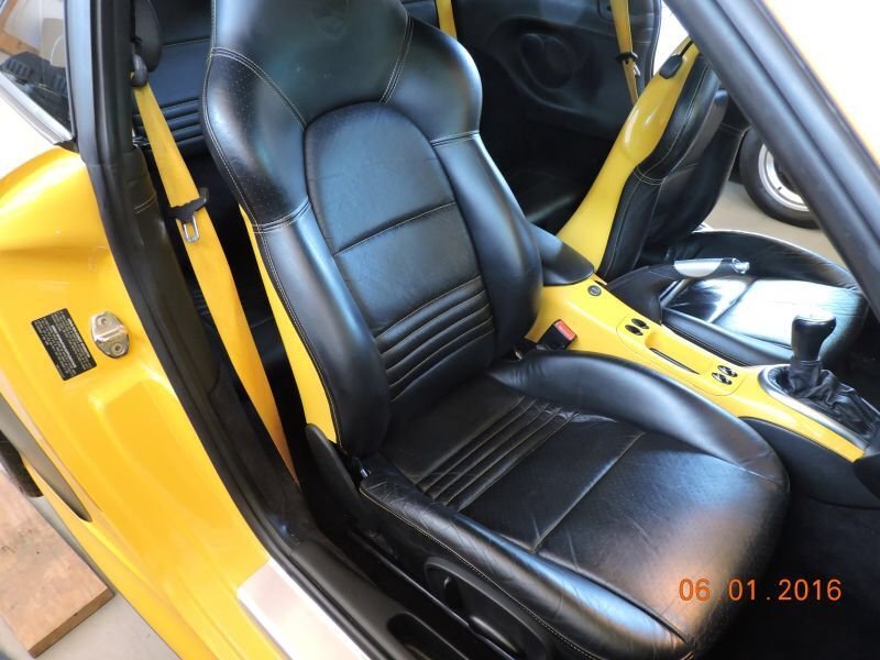

I made my brief introduction to the 996 forum when I purchased by C4S from Colorado a few weeks ago and drove it back to Charlotte. I thank those who helped me along the way. It was quite an adventure and a great way to learn about the cars capabilities. For those who didn't follow the thread, here is my car as I know we all like pictures:
