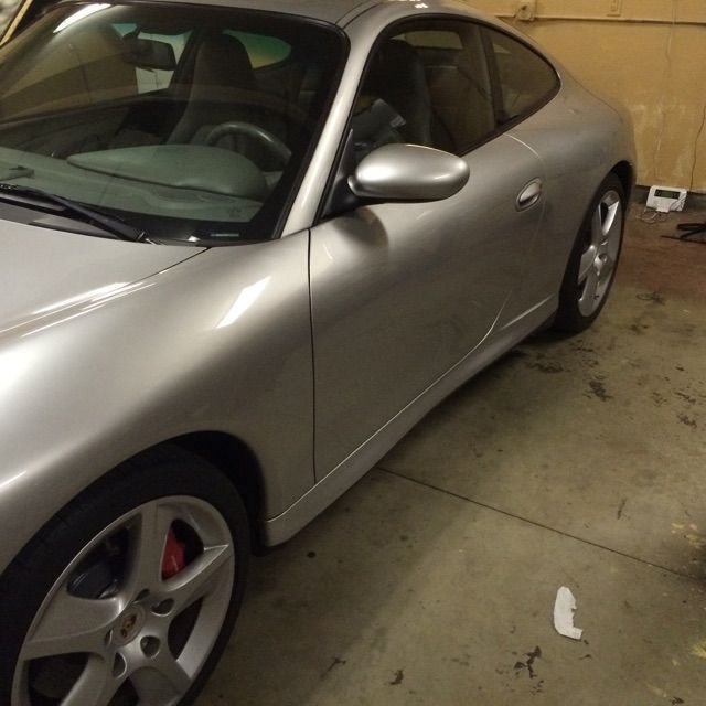

Here are a couple of pics I took... the one from the distance in my garage is "A winter to remember". I took it out today for a nice 30 minute drive to nowhere... The speed is intoxicating... I am really enjoying this car!!!

^^^ Don't forget to post your pix in the "Show Us Your Grey Car" thread. That way, you can see a whole bunch more cars that look exactly like yours, and they can do likewise.
