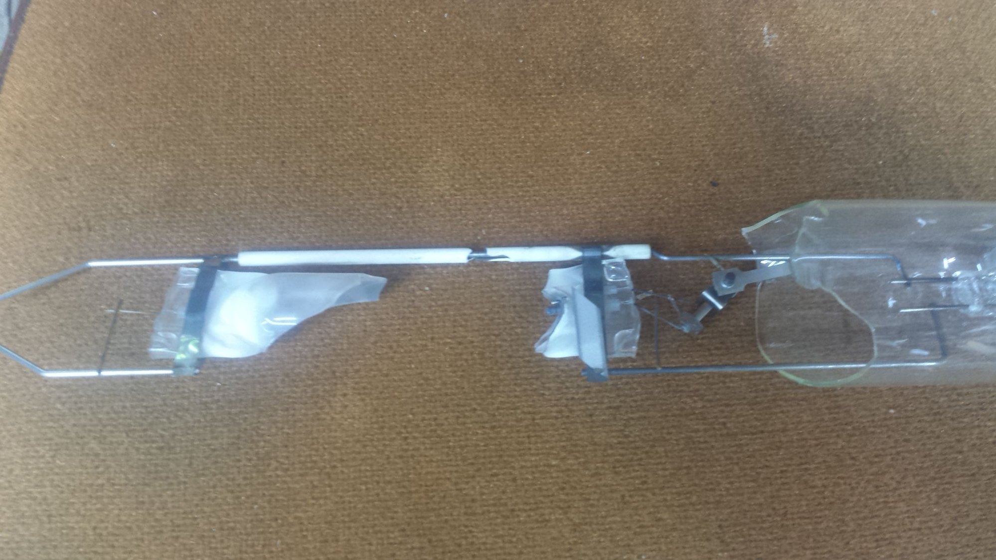

I also have T5 HO in my garage (54W) alone with 8' HO T12 fixtures switched separately. It's hard for me to tell the difference between the 48" T5 and the 8'- 115W T12 HO. I wanted to mention about 400 W Metal Halide failure. Sometimes the arctube will rupture sending the glass fragments outwards and break the outer glass. It's a rare occasion but I've seen it more than a few times. You can purchase the lamps with the protected shield. They have a shroud around the aretube to contain the fragments in case of an explosion. Attached is a pic of one lamp I saved that had nonpassive failure.
Also you pull the same power from the metal halide fixtures weather they are wired 110 or 220v. The difference is that on 110v, you my be pulling 5 amps and on 220v you may be pulling 2.5 amps but you are pulling them on both legs. Just wanted to put this in because I admire your work and hope to meet you someday.
