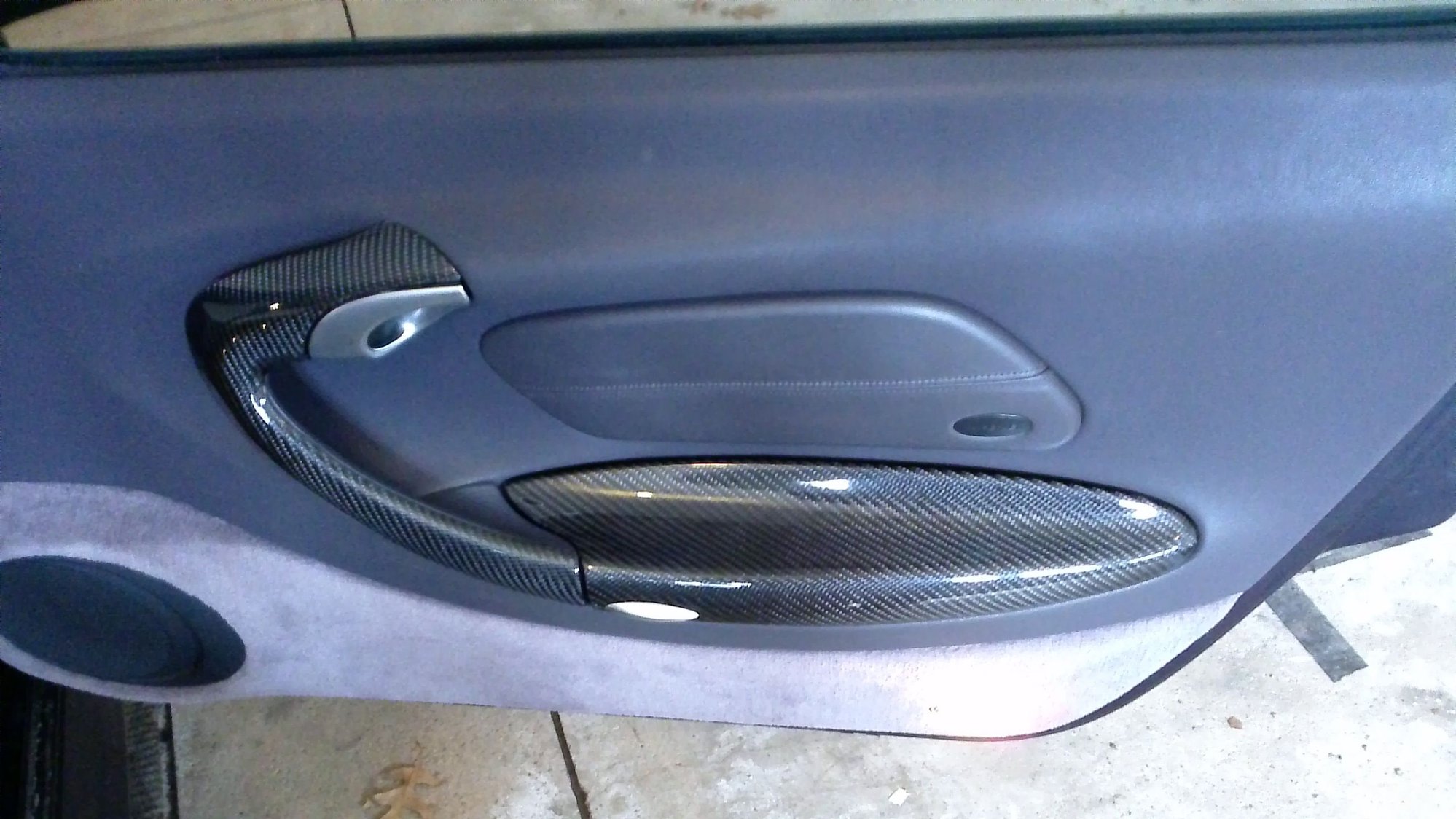

I finally had an opportunity to do a couple of projects. First is the installation of Carbon Fiber door pulls and map pocket lids. A rather easy project that didn't require and shedding of blood. I'm very pleased with the fit and finish and makes a nice upgrade to the grey interior.

Looks great. The carbon fiber should add at least 20 hp at the rear wheels (just like a motor mount swap).

Those look nice! Do they have parts for the dash as well? Expensive?

They do have CF pieces for the dash, but they ain't cheap. Oddly, mine came with CF dash and aluminum door pieces. Not terrible, but not what I would have chosen.

You are correct, they are not CHEAP. I was lucky to find these from a Rennlister at a reasonable price. My goal is to also do the stereo surround, the gear shift (may do alacantra for the gearshift) and the center console.

RDL: How did you get the radio out? The doors look great, hopefully you like the BT!
