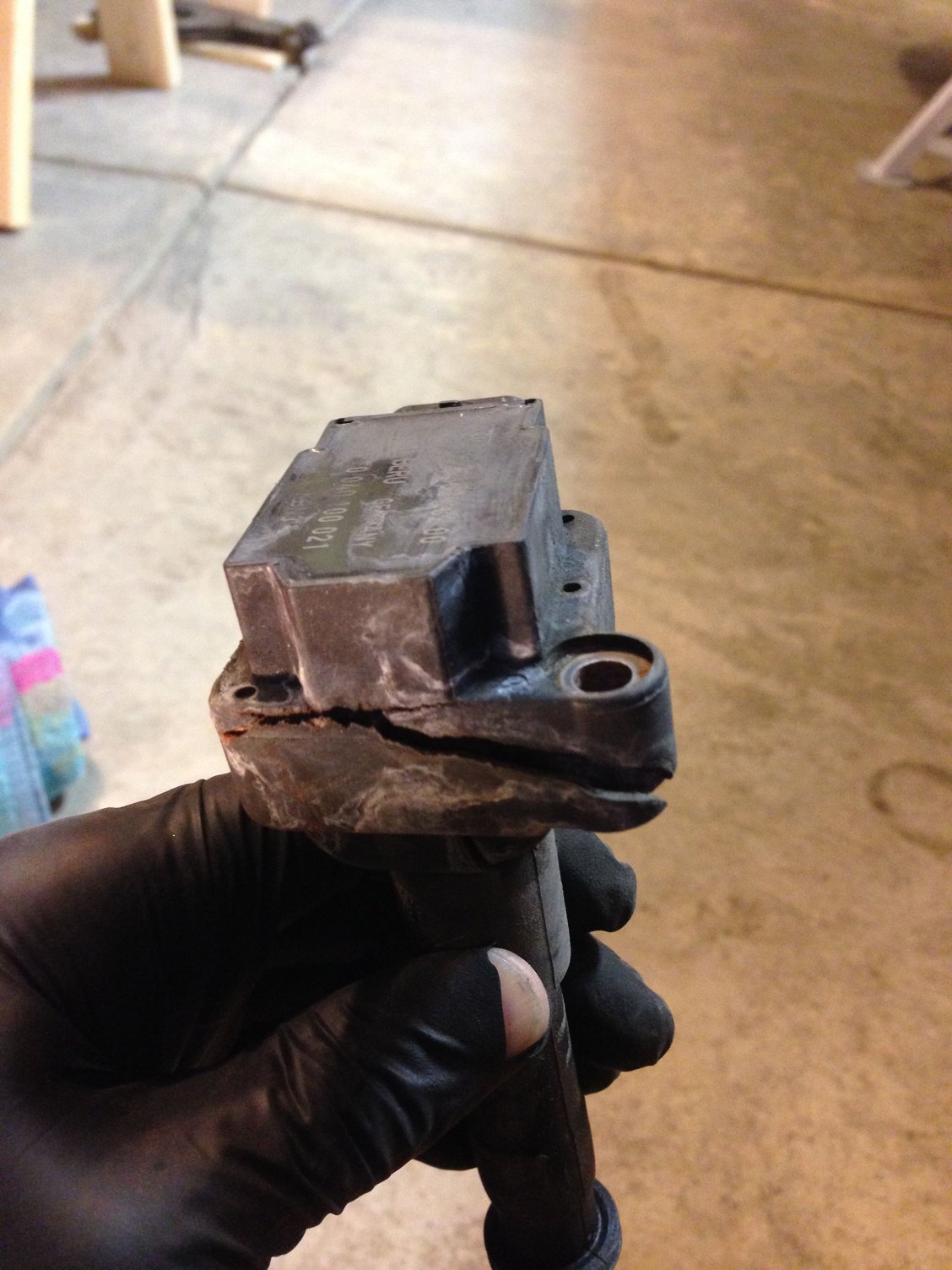

Sure enough - no surprises. 2 codes - misfire and misfire cylinder 1. Right where I was soaking the car with water.
I've dropped the mufflers and have plugs and coils ready to install (tonight if possible). The coils on the car look horrible - cracked, split, they look original and old/worn. I'll post some pictures for those who may have a similar problem down the road.

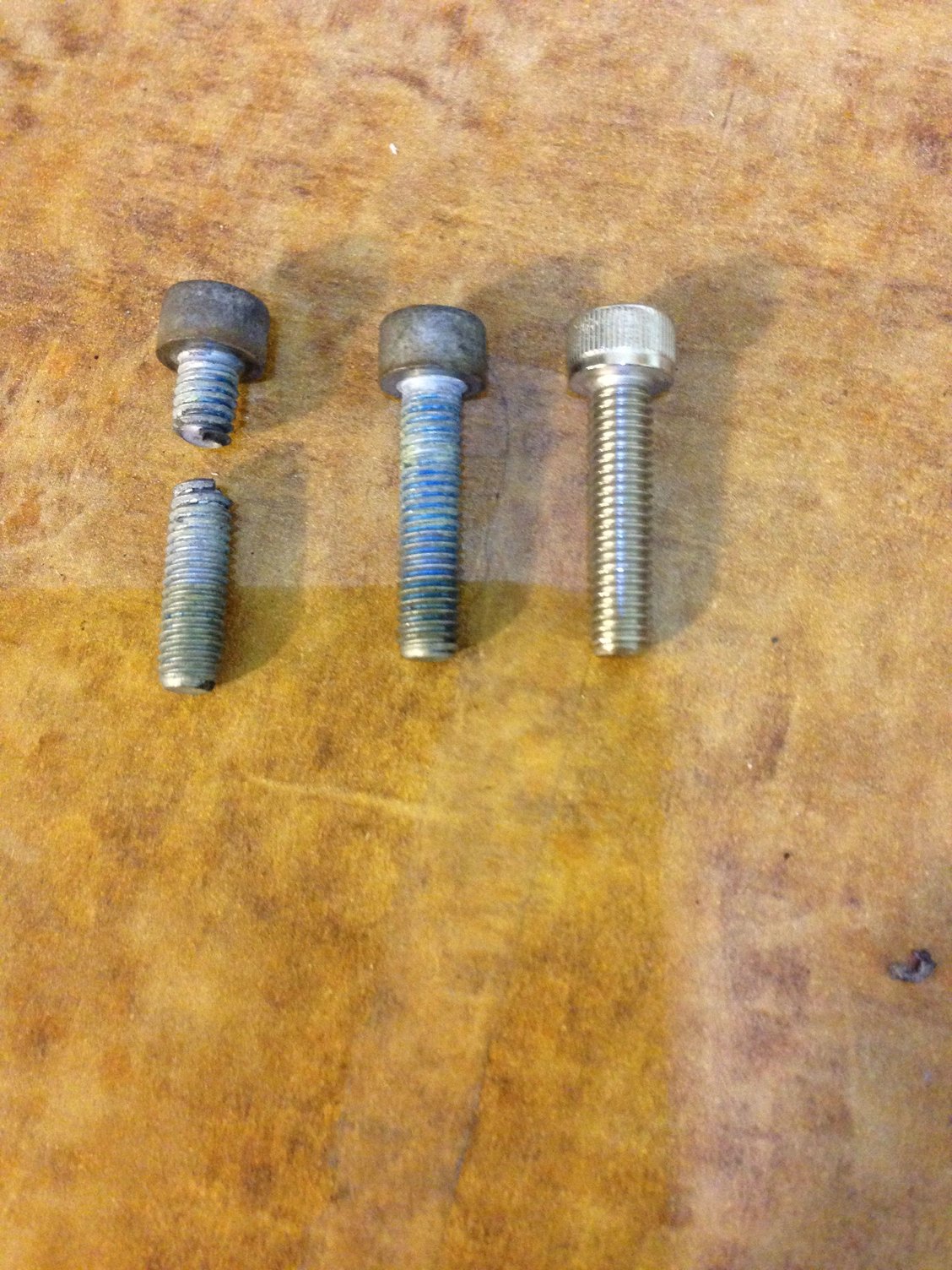

This isn't that bad of a job - actually one of the easier late model plug/wire jobs I've done. The only tricky part was getting the wiring harness back on the cylinder 4 coil properly. There isn't much space for hands/fingers.
Ran into one minor issue - when removing the top hex bolt from cylinder 2's coil, the bolt snapped in two. Was worried that I'd have some minor surgery to remove the remnants - but was lucky that the bolt head sheared where I could grab it with my finger tips and work it out. Found a replacement bolt at Ace for $1.93.

Cracked and tired coil before removal.
I wonder where the misfire came from? Check out that crack:
Cracked and nasty - ready for the trash can.
Now to the broken bolt - check the broken one on left, OEM in the middle, and "ACE hardware to the rescue bolt" on the right:
broken hex bolt - ACE to the rescue.

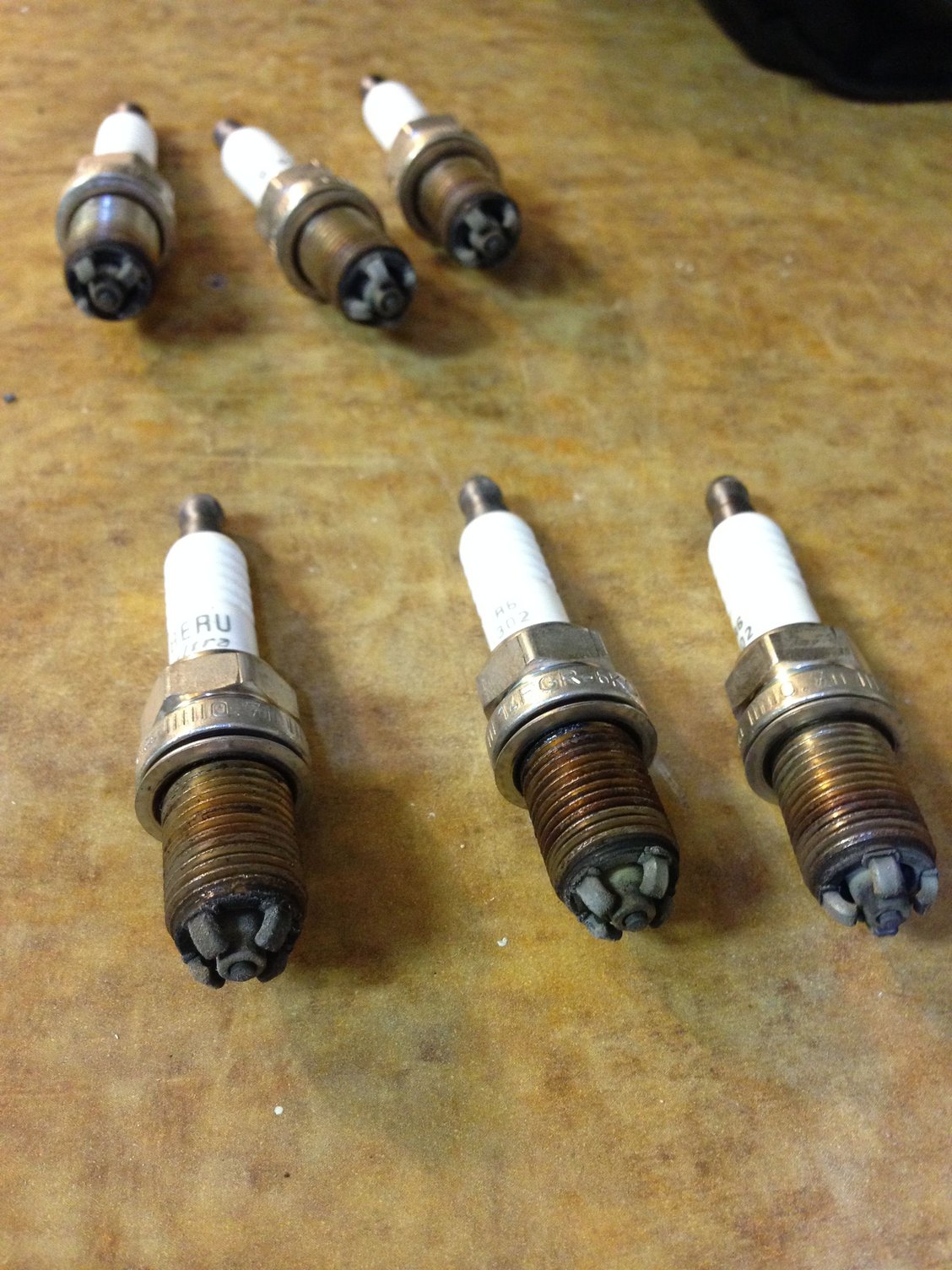

6 used plugs looked great - nothing out of the ordinary or troubling:
All used plugs look fine - no issues.
