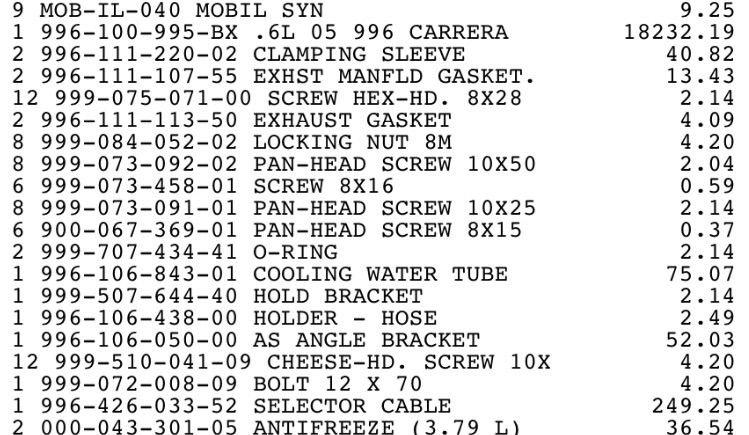

To provide some additional information, the invoice for replacement specifies a part number of 996-100-995-DX, description 3.6L 05 Car 996. This was done in 2011, but seems like a 2005 motor based on the description. I've found different people saying their replacement came with accessories, etc. all brand new but others are stating most (including belts) were moved over from old engine to the new one during replacement, which seems a bit odd to me.

This was mine

I had a crate engine installed in 2013 and it was complete with the exception of the A/C compressor. No new motor mounts. Then engine and all accessories covered for 2 years unlimited mileage.
I recently had a charging issue which turned out to be a bad cable, that was 100% covered by the replacement engine warranty.
I never received an itemized bill, simply stated a Porsche remanufactured engine, the labor charge, and coolant. The engine was "donated" by Porsche.

Just got a call back from the service department which did the replacement and "there's no way to know which bearing" this engine contains without pulling it apart to visually confirm, they don't know when a crate engine is installed, only Porsche knows when it is assembled (good call Macster!). Based on the date of replacement, he believes it has the newer non-serviceable IMSB. I will try not to think about possible failure due to such low failure rates and given it cannot simply be replaced (based on the info I've found) preventatively.
Also, I was told the crate engine includes just about everything: water pump, plugs, etc. but not the serpentine belt, so I will go ahead and change it out to be on the safe side since I believe it is original. Thanks for all the information/advice everyone!
