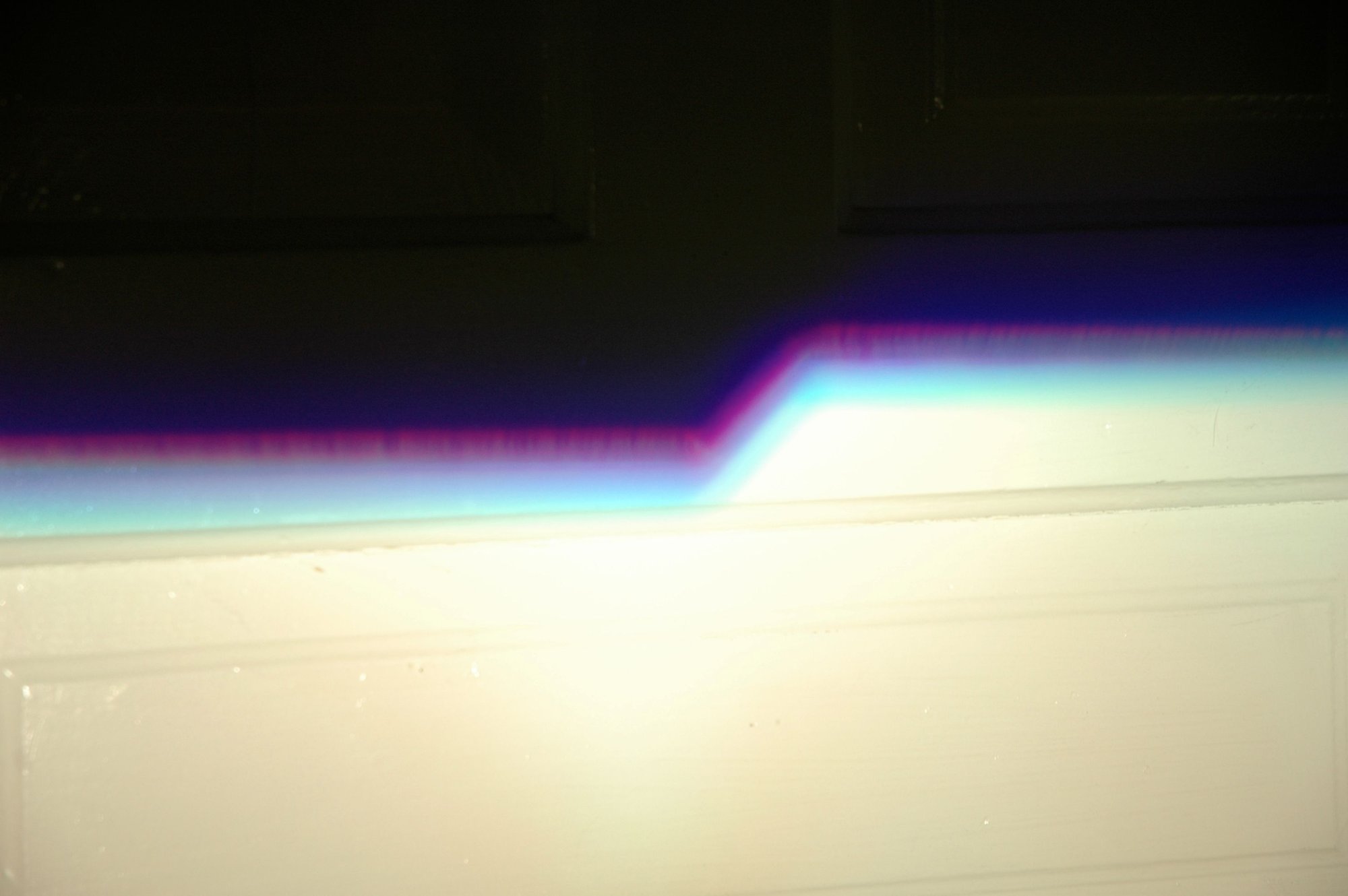

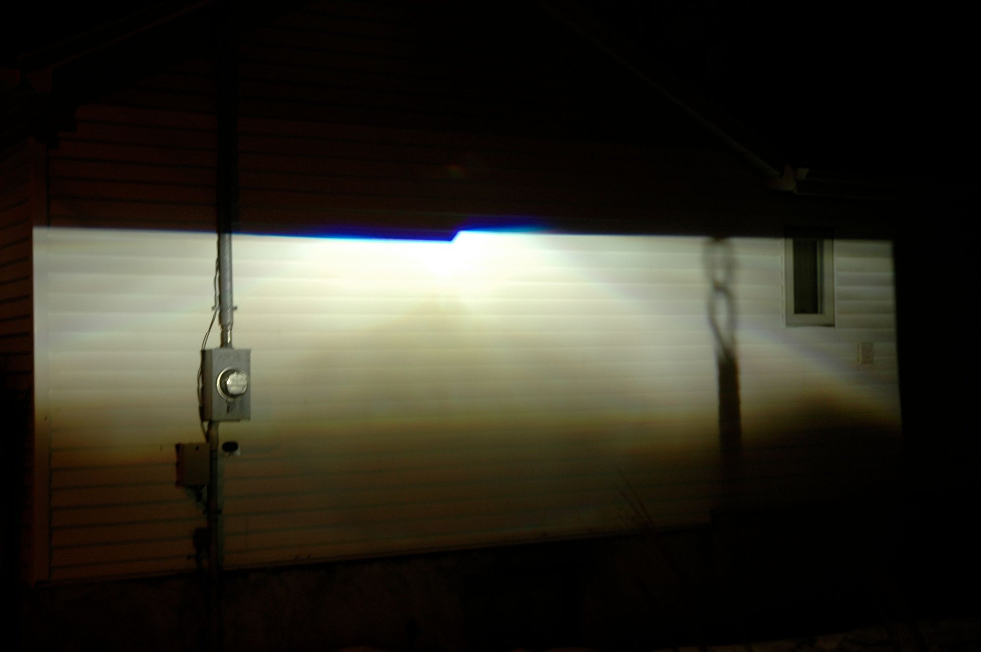

Well you may be right about the reflector style OE Porsche headlights. I've never opened a set up before and typically the reflector holding points are not made to hold the added weight of a projector....but it can be done. I'm assuming everyone using these kits https://rennlist.com/forums/996-foru...and-986-a.html are utilizing the reflector pivot points with no failures to date according to the seller. I thought clear lens projectors had been banned by the NHTSA so I stand corrected. In any case, to me, a sharp cutoff is beautiful and I think I'm going to open my current headlight up to change the diffused lens to a clear one.
Something like this a retro I did on my wife's Sentra...
