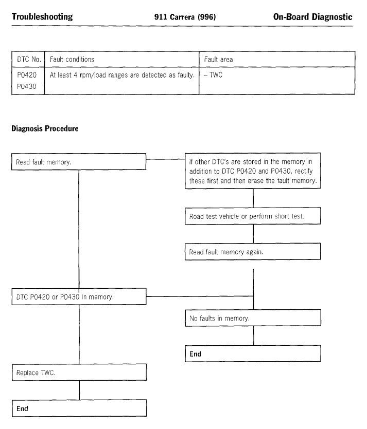

One very important part deals with sensors. If there are any sensor errors, and these may not be active but pending, these should be dealt with first. Only then if the converter error comes back then the converter should be dealt with.
I know of no tests one can do to confirm the converter is bad. The DME is pretty good at catching a bad converter. Emission rules/regulations require proper converter operation and automakers strive to monitor converter operation in order to keep them operating efficiently and to also catch any problems that might damage the converter, since these are covered by an emissions warranty over and above the new car warranty.
