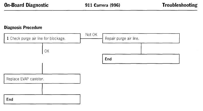

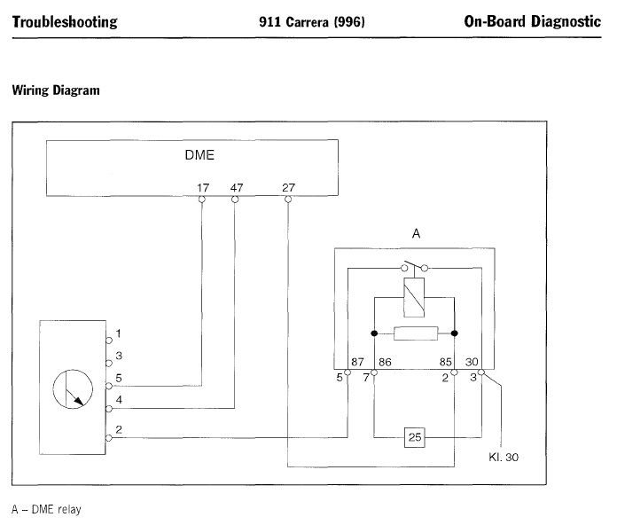

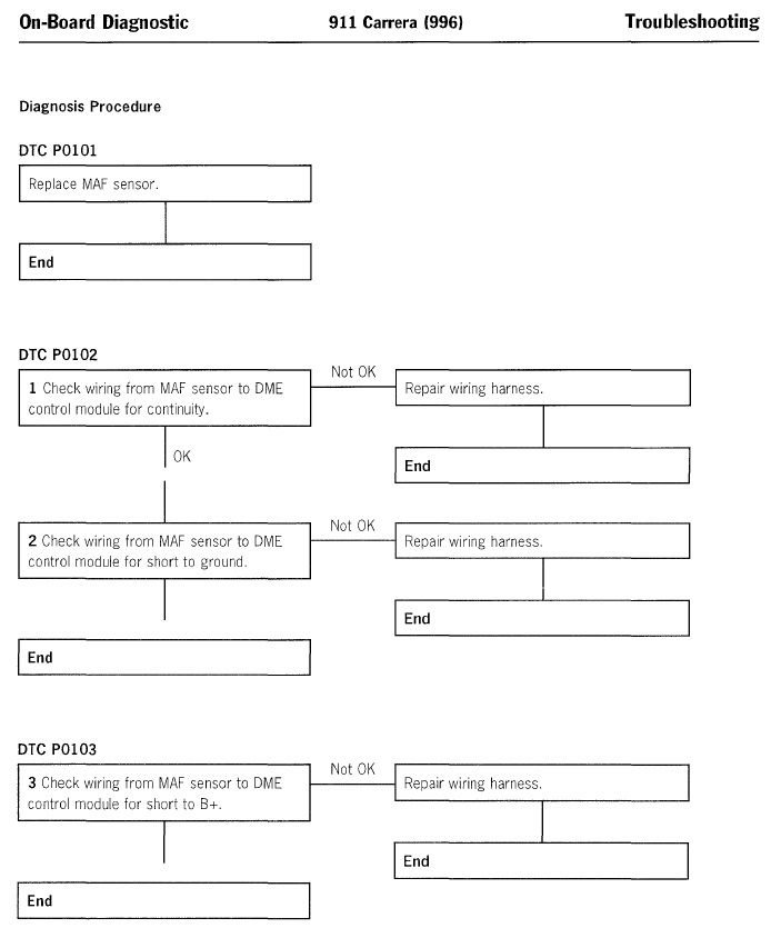

I was hoping there might be something I could check before digging it to procedure Porsche recommended for this OBD code.
Here's what the Porsche OBD manual says. Just dig into it I guess? Can I get around not having the special tool?
P0102
P0446
