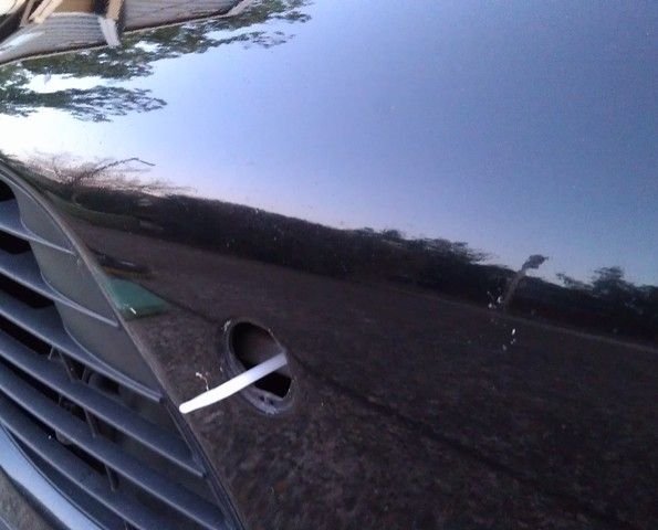

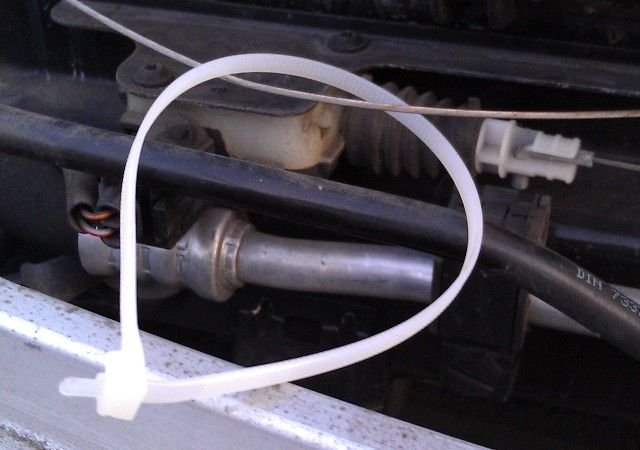

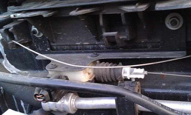

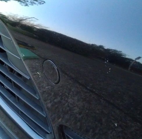

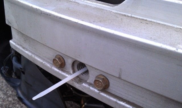

Find zip tie
Locate manual cable

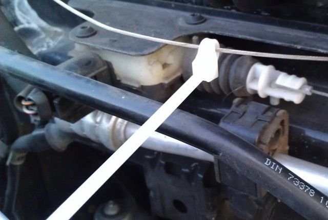

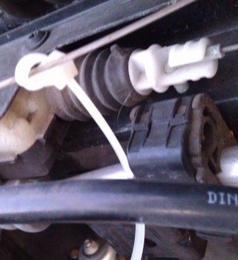

Wrap zip tie around it
Tighten
Tuck behind this hose

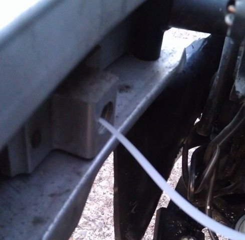

Fish through back of bumper
Through tow hook hole
Test by tugging zip tie
Reassemble bumper cover
Hide behind round plug
Wash car before taking photos.
Anyhow, hope this helps someone the next time a battery goes kaput.

Also there's some slack on other side of manual cable ie it's not fixed. Have u tried pulling it and making sure it does with bumper installed and hood closed? Also with that ziptie inside tow hook area how u put a tow hook there unless u plan to push it all the way in which would negate what u done. I probably would use two zipties and 2nd ziptie looped to 1st zip with 2nd ziptie loop small enough that it passes thru tow hook recess- just use a wire hanger that's make to hook the loop and pull it. Just a thought. Mike

I punched a very small hole in my pass side radiator shroud and fished the (looped) end of that same wire through it. I can now reach deep into my pass side cooling air intake and yank that wire to open the drunk. I had to do it once... worked a treat.
