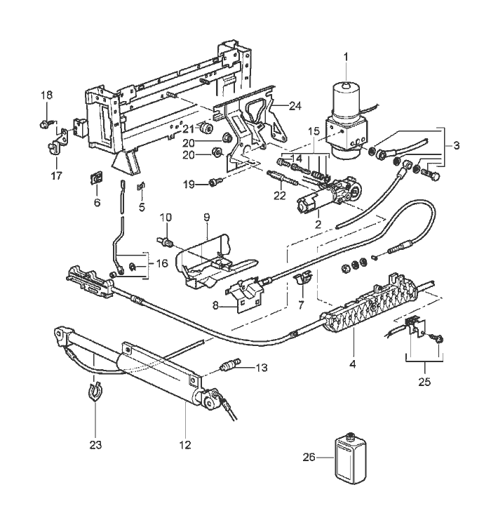

check the micro switch on the clamshell actuator. It's right in front of the hydraulic pump, on the top of a black plastic housing with two thick bowden cables coming out of it.
Part #25 on this drawing. It gave me some trouble when I was having issues with my clamshell.

I did check micro switch #25 out for continuity and it was good. Putting some more thought into this, I have a spare flap (passenger side) and it was giving me problems (slow and now not opening) so I'm going to change out the flap, re-assemble and head to the dealer to re-program. The manual highly recommends going to the dealer once you have crossed into the emergency / manual mode. Any tech savy members know of anything else I should check out?
