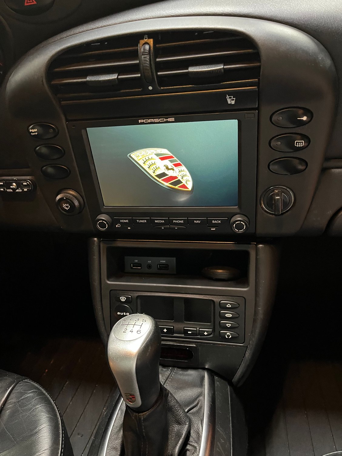

Unhappy 2004 996 C4S moves HVAC and now no cold AC
Hello everyone, I have learned a lot from reading all of these posts and wanted to thank everyone for contributing.
Question for everyone:
Just installed the PCCM + in my car. everything with the PCCM is working great, it actually does just shut off sporadically but trying to figure that out as I go. When installing the PCCM + I had to relocate the HVAC unit to the bottom and rerun all the wires in the back. Total PITA.... after moving this unit my AC blows cold for about a minute and then blows warm air. is there something that I need to do to reset the HVAC and or condenser in the car? Does anyone know anything about this?
