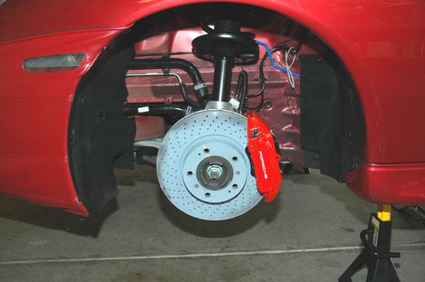

Just about to venture into the Caliper paint mod and while I'm in there I'm going to redue the hats. What have you guys been using for paint? Dupli-Color Caliper Paint for the Hats too? I plan on brushing everything to keep the mess down! I'm painting the Calipers Red and the Hats Silver. Any recommendations appreciated.

use a hi temp engine paint, and recommend always spray painting on a car, use a brush on the house

I used Wurth wheel paint (silver) it holds up well. I also I believe it only comes in a spray.

If by brush then yes Dupli-Color Caliper Paint

Plan on brushing it on due to the time required to prep for spray. Hoping less mess too!! Thanks guys.

I just use light grey primer, works like a champ.
If you remove the rotors to spray them, that is the easiest, but it you want to do it on the car, just mask of the front of the hub and the caliper. No need to worry about masking the rotor as the first time you step on the brakes, all of the rotor overspray will be cleaned right off, and you will have a nice cut line on the hat.

Hats? I used Rustoleum and a brush. Worked good : )

I used Rustoleum hammered silver (brush on). Lasts and lasts, and is easier than masking the whole front end for spray!

I did the same as Andy - followed his recommendation and have had the same experience - looks great and is lasting really well. It's easy to brush on, requires little masking and levels out to a nice finish without brush marks.

I prefer VHT flat black engine paint (see avatar), but my wheels are black.
Make sure to scruff them up a bit with sandpaper before painting.

I used the rustoleum hammered silver as well, still looks as new after a few years, but it probably only has 4-5k miles, and nothing real aggressive that would generate significant heat either.

I recently changed my rotors, but they still looked like new after 2 years. I would highly recommend this method.
