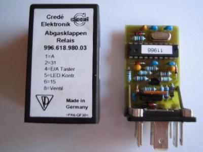

there is a pink/grey wire that connects to the pse relay from behind the relay carrier... disconnect it from relay carrier and attach it to one side of the switch (I used a small toggle switch that I mounted to the relay carrier, by the clutch area). Attach another wire to the other side of the switch and connect it to the relay carrier where you disconnected the Pink grey/wire.
In other words... the pink/grey wire is the speed signal that goes to the PSE relay. Use a toggle switch to open/close the speed signal (pink/grey wire) to the PSE relay.
