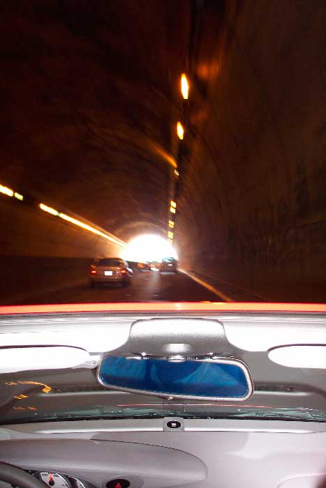

Don't mean to be redundant (I posted this on another topic), but I just used a targa switch and sprayed clear on it. In the photo the colors don't match but in real life the match is excellent.
Tom
