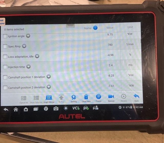

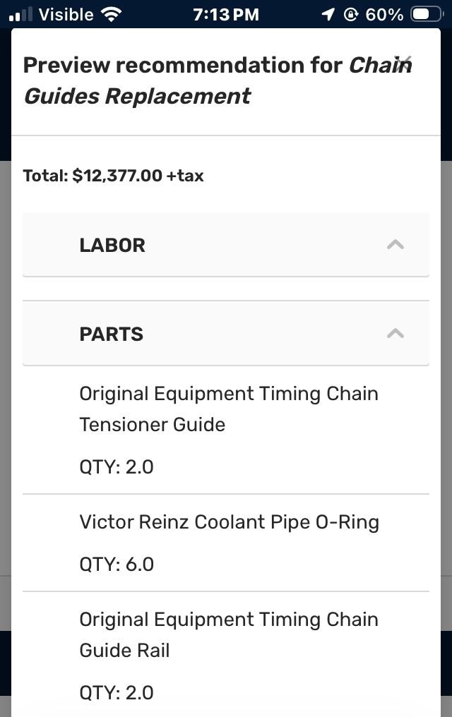

After gaining the knowledge from this great forum and its members, I was able to get readings off my Durametric for my recently acquired 2000 996.1. Of concern was my cam shaft deviations of -8.33 for #1 and -7.64 for #2. I took it to a local “German” shop where they hooked it up to their computer and got similar readings of -8.25 & -7.61. I asked for a quote to replace all of the cam chain guides, replace the small chains, and rebuild the varios with all new O-rings. They said (depending on any additional items they find) that job would run me $12,377! Add to that the fact that they’re slammed a when they can get it into their shop, minimum of 4-6 weeks to get done. I’m at a loss. I have quote requests in for 2 other shops in my area. I am mechanically capable of most tasks but have never cracked open a motor and feel that timing stuff is best left to professionally trained people. Also, I don’t have a garage big enough to comfortably work in. The car is running smooth as butter right now but I cannot afford that kind of money for the repair. Also, I know it needs new plugs and coils and a few other maintenance things. At 145,000+ miles, it is a driver and not a collector grade vehicle.
Please share your thoughts as to if the quote is reasonable, what you’d do if you were in my shoes, and if I go to sell it, disclosing what it needs and what you think it’s worth. If anyone has any input how/where to sell it, that would help as well. Thanks in advance.

I got a quote for about $7k for the same job last year from a reputable shop in Atlanta. $12k seems a little excessive unless it included replacing items while the engine was out of the car.

I had mine done for $6k here in Houston. Don't let them tell you the motor needs to come out because it doesn't.....that's just a money grab.....mine included having the RMS replaced, throwout bearing, and a bunch of other things (as long as your in there) done. $12K is nuts. Thats half the vale of the car! . I would assume it feels fairly sluggish? I don't want to scare you but remember if you drop a valve, you have your self a 3000 lb. paper weight in your garage. You could ship the car to Texas have it down and return for less then $12K!

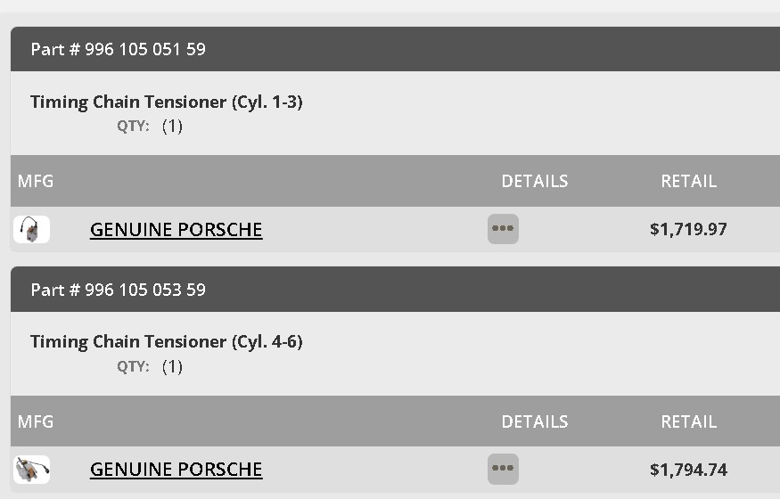

Here is some more quick math: Each of the cam variator in a 5-chain engine runs $1,500 now. Dealer item only. Mechanic who are busy do not / will not offer the rebuild option for the variator only to have it fail at their expenses again.
Shops usually use the listed retail price, especially on Genuine parts due to low margins.
