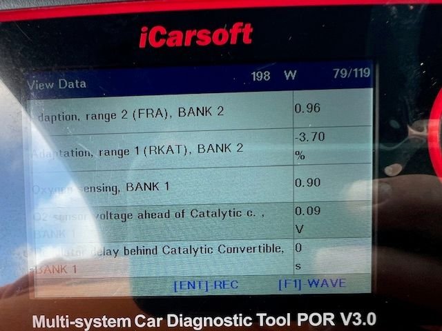

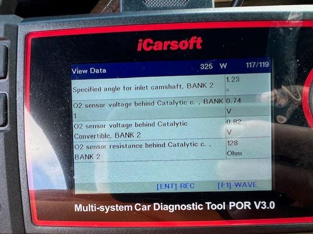

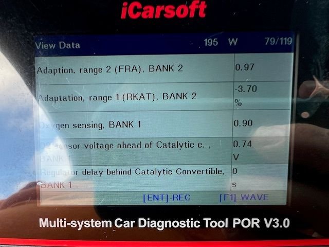

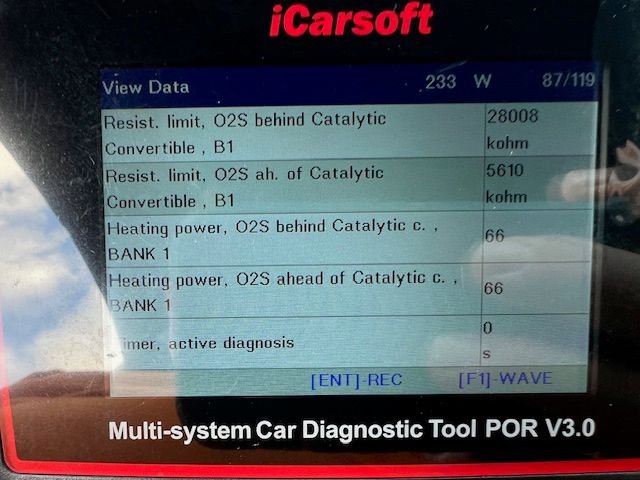

I am including the screens from my iCarsoft reader hoping someone can spot something obvious.
Thanks!
idle
idle
medium rev
medium rev
high rev
high rev

The biggest warning sign shows up in your 5th image. The MAF value of 12.7 kg/h is a lower than spec (I assume this value was taken with the engine idling). I would start my investigation here to see why it’s not roughly 17 kg/h.
