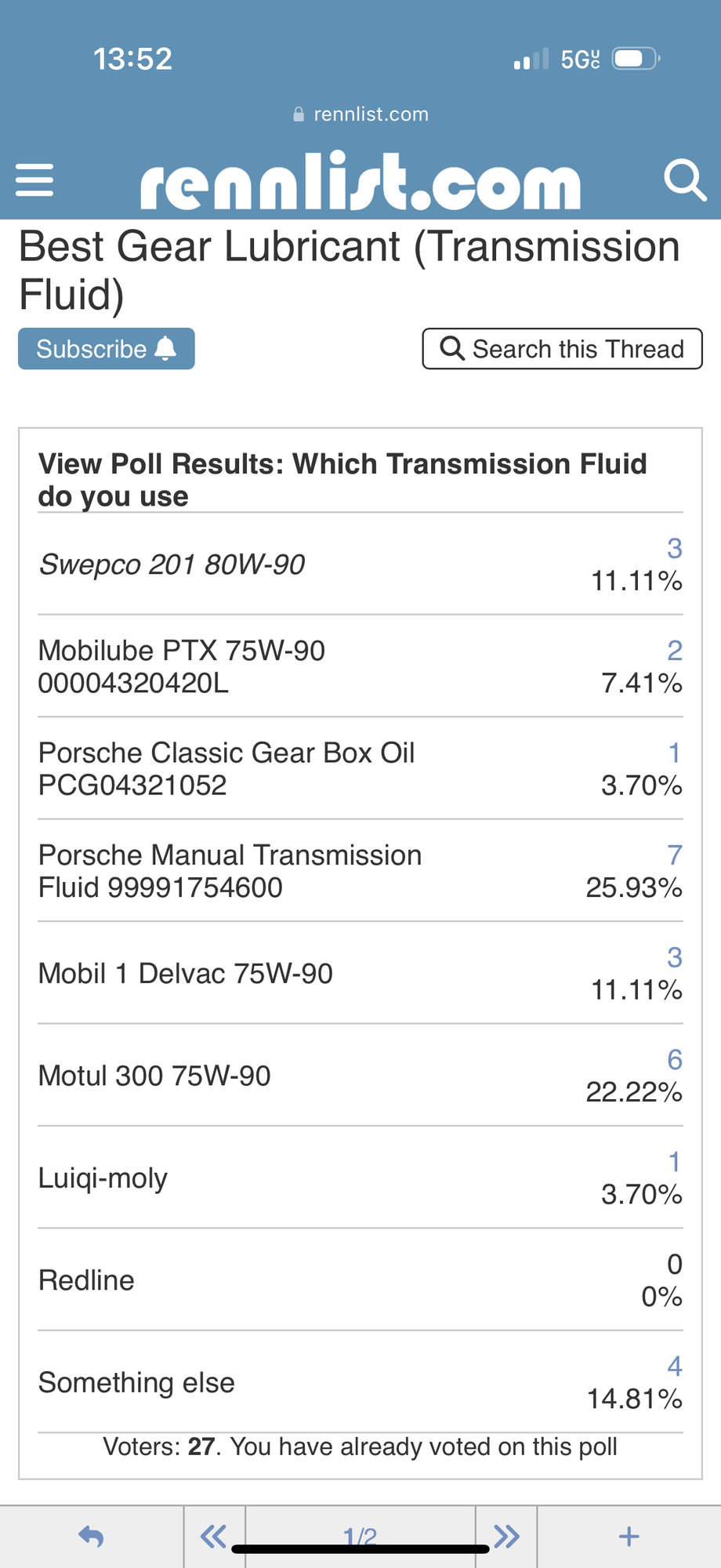

I did a poll on this and spent a bunch of time trying to figure out what was best. Porsche is the most popular. I chose swepco since LN engineering recommends it and it is in the 101 projects for you 911 guide (996 version). They don’t name it, but have a picture of it in the front.
