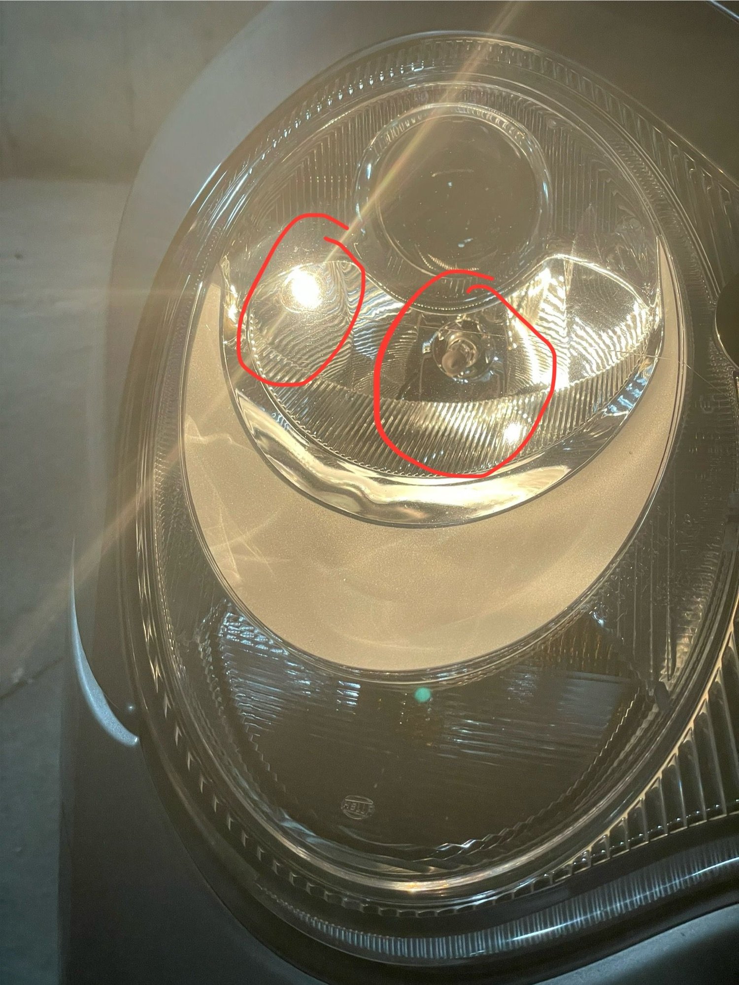

Can you all kindly help me identify which bulbs these are referred to in the manual? I want to replace all 4 myself (both sets, L and R headlights). My preference is to replace them with a white light bulb, and not yellow as shown, but I need to get the wattage correct. For example, I don’t know if I have bi-xenon headlights, so for the high beam bulbs, the watts could be 55W or 65W. Relying on this community’s expertise!

The little one on the left is the parking light (H6W) and the one in the center is your halogen high beam (H11).
You should get the Hella brand because it has the small glass enclosure that will fit through the hole.
Amazon Amazon
The H11 are very common.
Amazon Amazon
