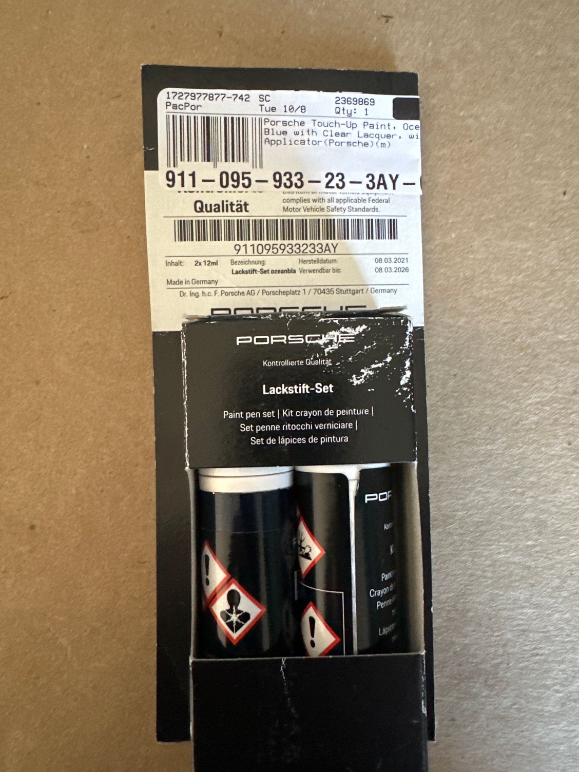

Dumb question I know. I bought the Porsche touch up and clear coat but it doesn’t come with any instructions. Anything to be mindful of?
