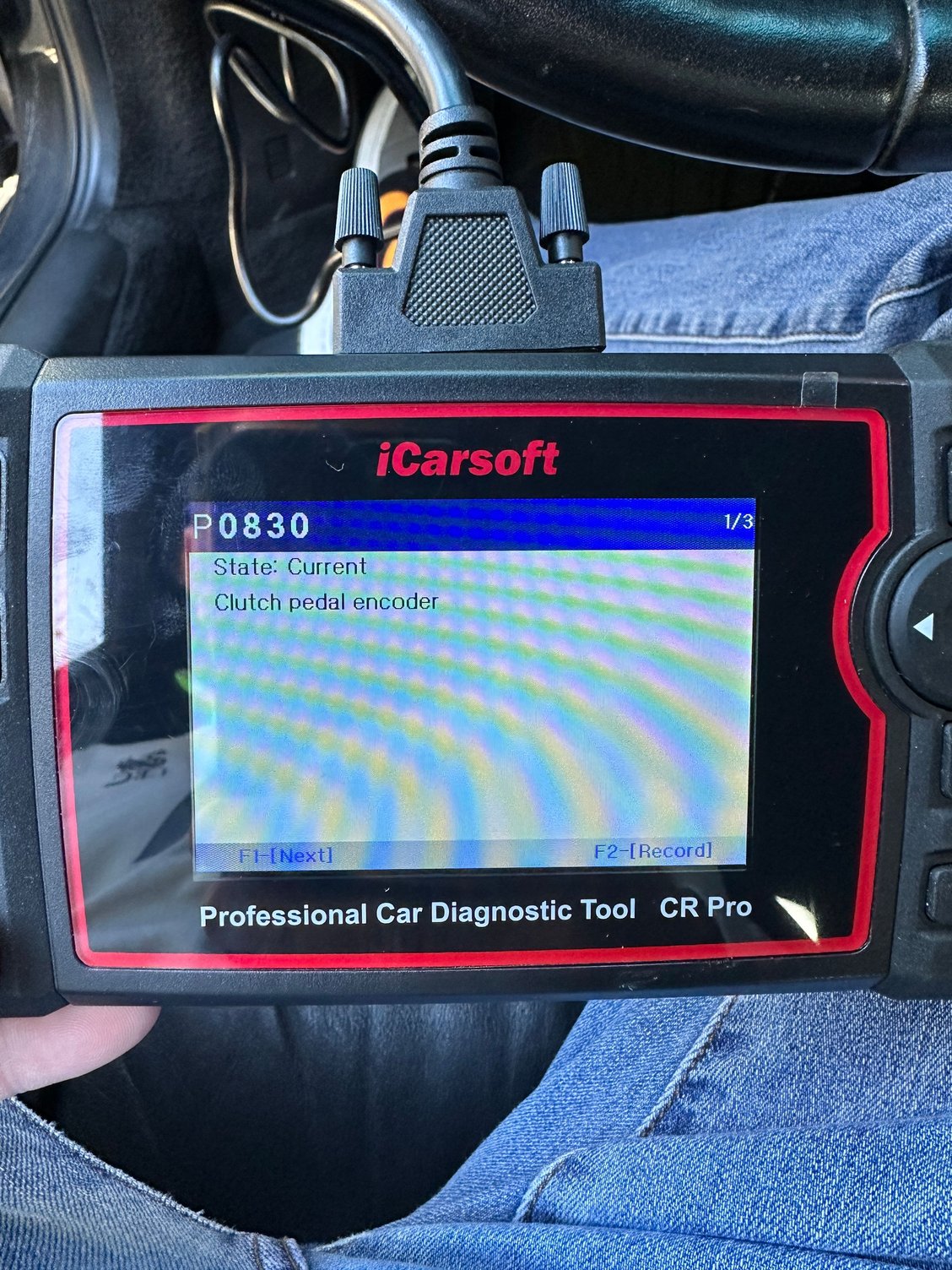

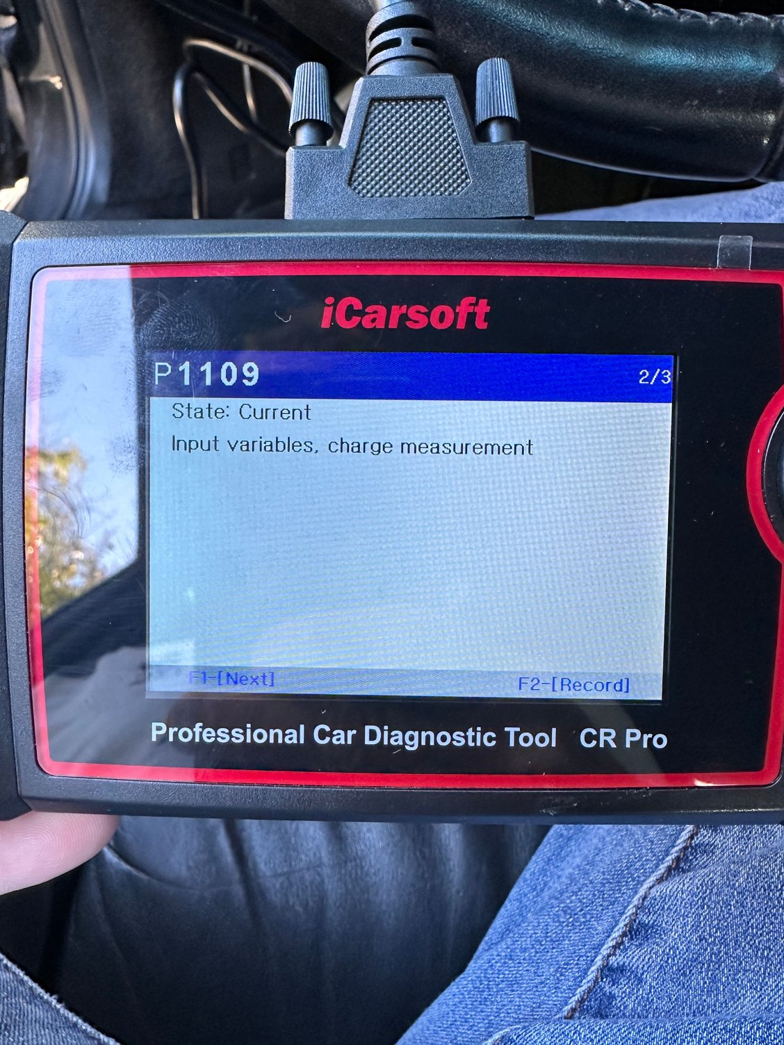

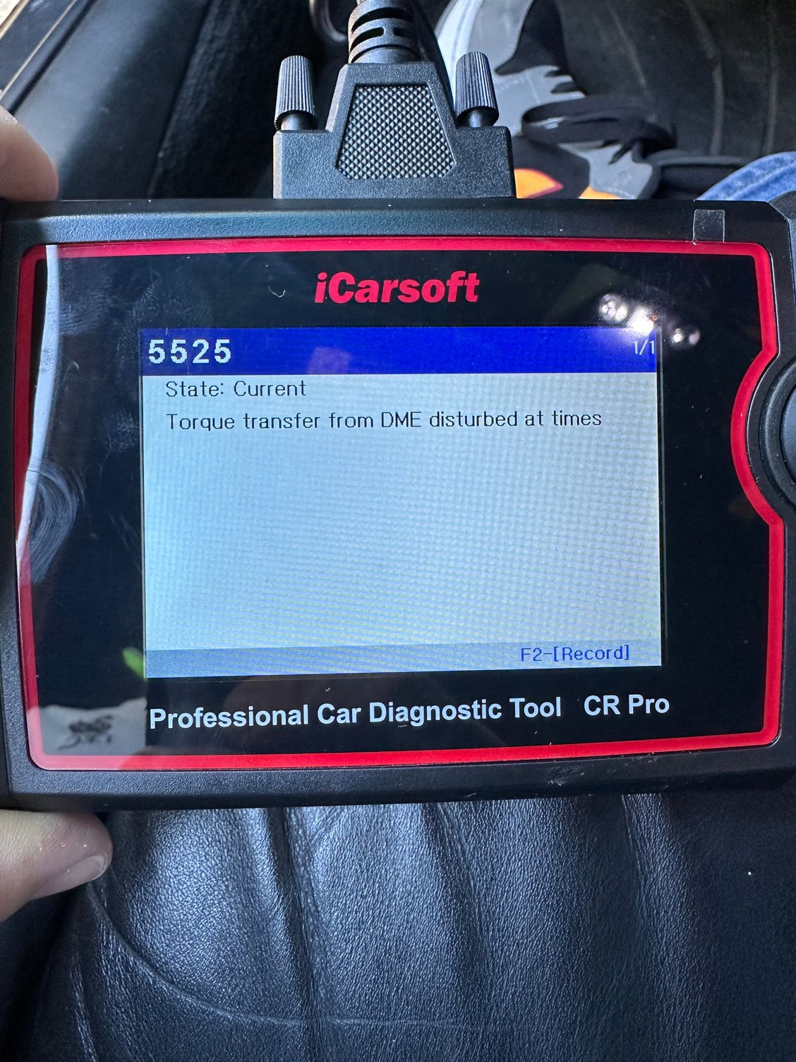

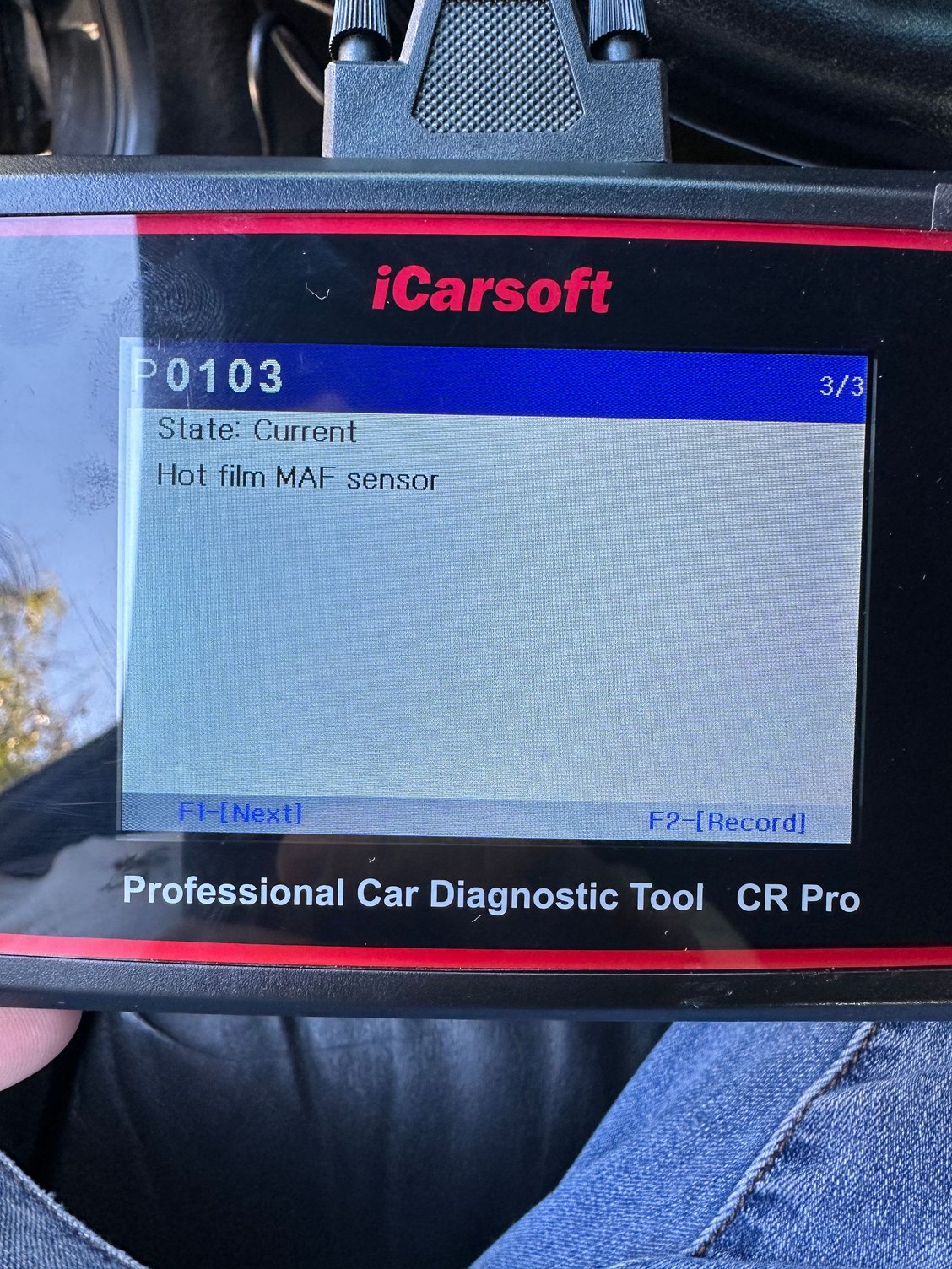

Mine popped on randomly and I just happened to have a scanner in the car last time it happened, and managed to pull the following codes while the error message was still on; cleaned the maf sensor and they haven’t come back since…
not saying that’s what fixed it….but it’s promising so far.

MAF issues cause the PSM error because the PSM calculates engine torque from the MAF. If the engine torque does not match what the PSM calculates it throws that code.
