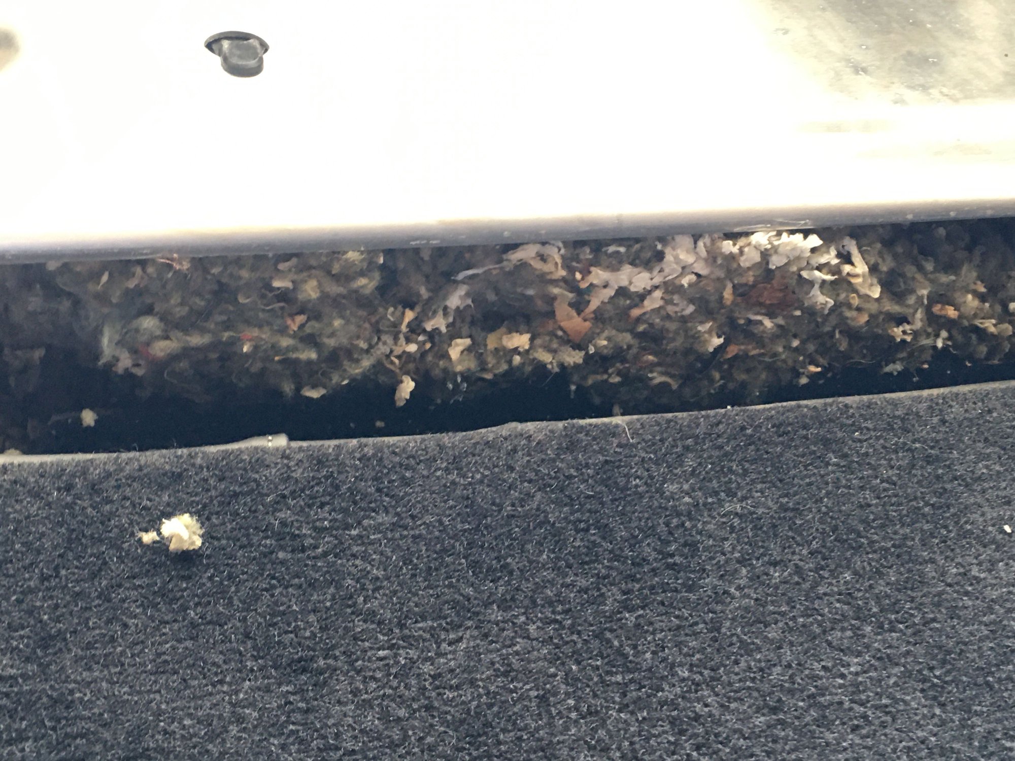

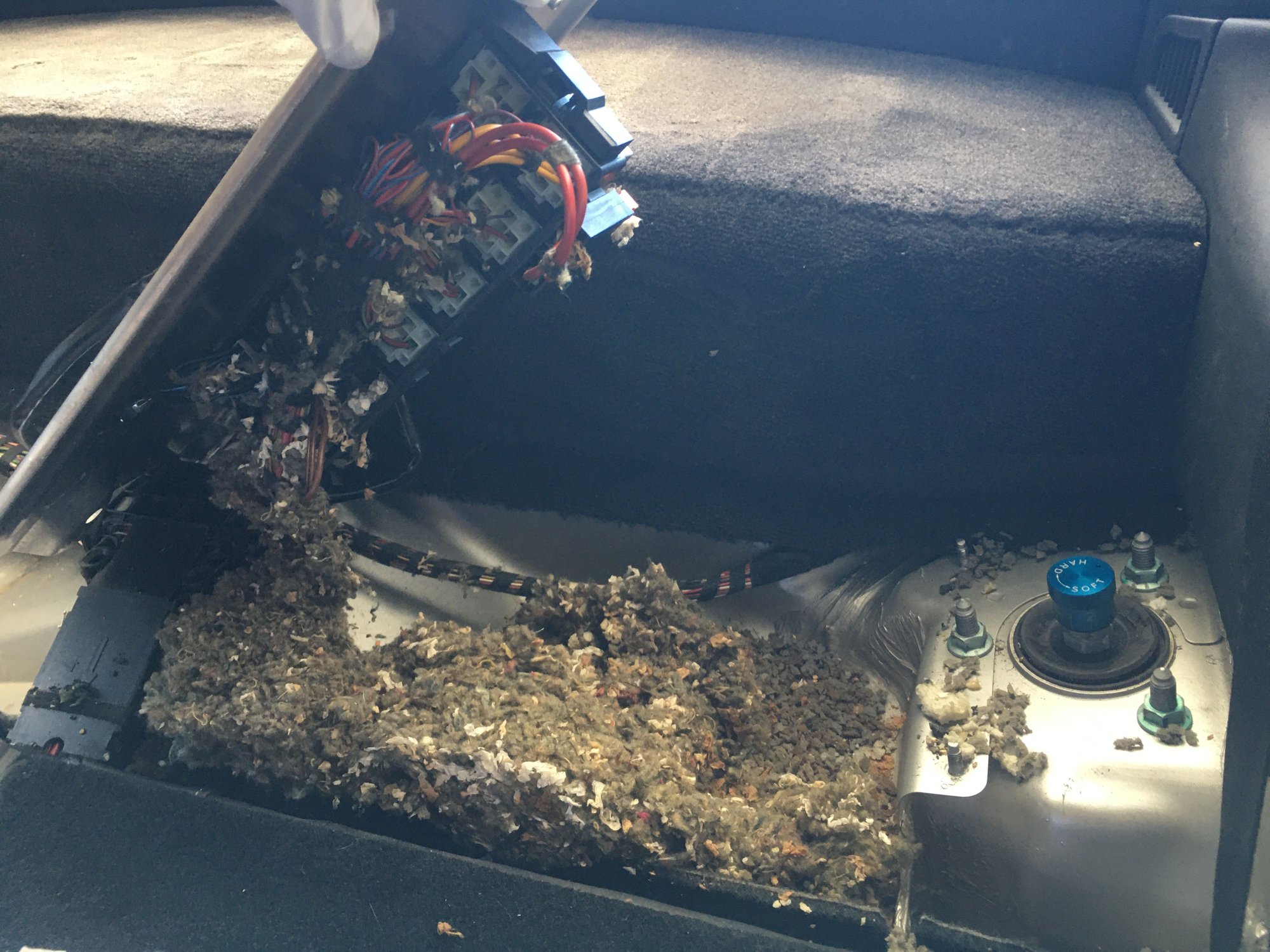

So I decided to look at it for visible faults, re-rack/clean the connector, and this is what I found.
What the ECU area is "supposed to look like"
and this is what the relay side looked like:
and under the relays:
I only found one chewed wire (surprisingly) and it was just the wire covering on the big brown wire that connects to the ground stud.
But I did find some blue corrosion on the back of the relay connectors (it looks like alkaline battery damage, is mouse **** alkaline?)
It looks like the vermin is getting in via the wiring harness opening that goes back on either side of the very aft corners of the cabin.
Have you ever taken that interior out? Got any pics/ tips?
What about those of you that have pulled your engine?
Where does that harness come thru into the engine bay?
Can I get to it with the engine in??
(I am concerned about chew damage on that harness)
I am going to get some electrical contact cleaner and try to rinse off the mouse urine, and see if that helps the intermittent DTC's...

As a follow-up, I cleaned out the rodent debris (where did it come from???), took out the relays, cleaned the sockets with a liberal dousing of contact cleaner, put the relays back in, and went for a drive (after reconnecting the battery and waiting for the e-throttle re-calibration).
The car drove fine, and (currently) no DTCs!!
Paul
Its very corrosive.
Now that you got it cleaned up, I'd treat(spray liberally) all those connectors/prongs/relays/etc, with some WD-40 to stop the corrosion and prevent any more.
Just like "alkaline battery" corrosion, cleaning them is not usually enough, its hard to stop that type corrosion from continuing down the road without an anti corrosive treatment like WD40.

I would should suggest baking soda water mix, spray down the corroded area with the solution then scrub it and rinse it, then spray down with WD40 to repell the water...
Baking soda water mix will neutralize any battery acid/mouse ****/alkaline ...
