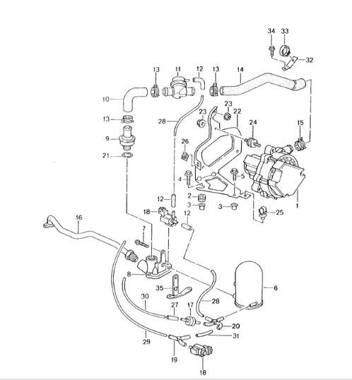

Remove the alternator.
Apply 12 to the air pump, left side of your engine bay. See if air is coming out the output side of hose 14.
Do a smoke test on the vacuum line 12. If there is a leak, fix it.
Apply vacuum using a hand pump to the vacuum port of the control valve, number 11. See if air is coming output side of hose 10.
If air is coming out of hose 10, and you are getting those two error codes, then valve 9 is bad. Change it.

Thank you for sharing the diagram. Super helpful....
