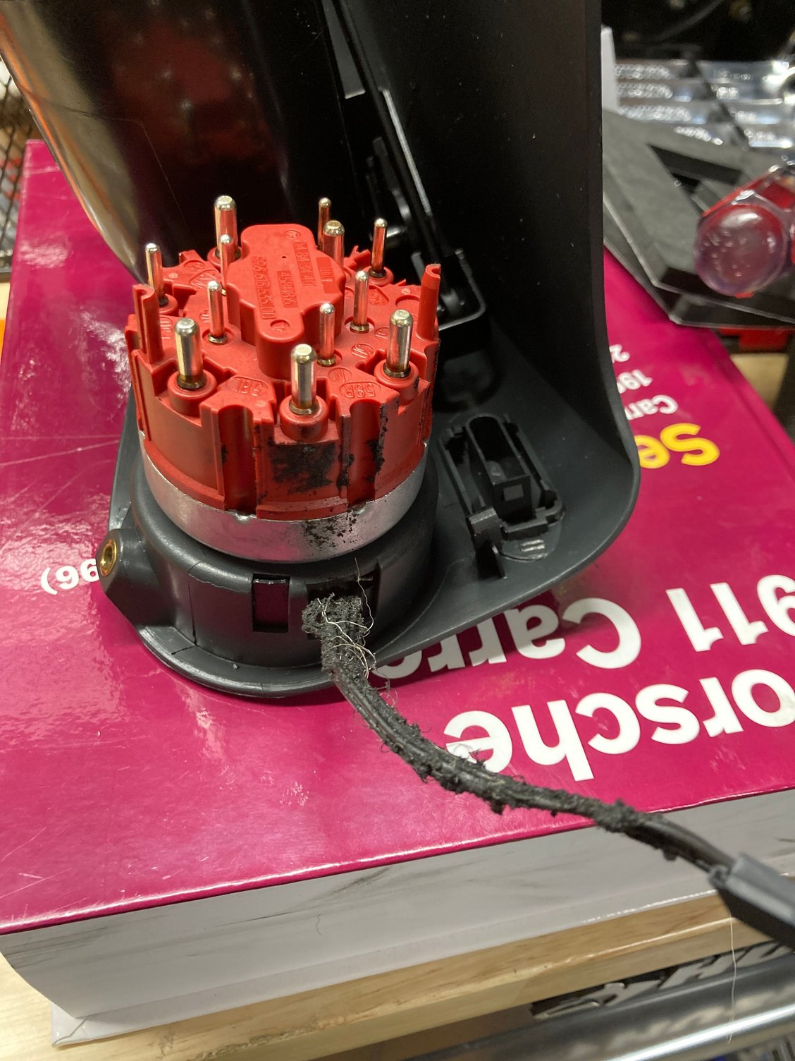

My bet is a short in your connectors or maybe wire harness. As there is not any way for the lights to turn on from the ign switch unless the light switch is already on, (or you have auto on lights in a 996 ?) Just as there is no way for the light switch to feed back to the ign switch to keep engine on, unless both switches were shorted simultaneously. But it would take both switches to be bad at the same time, and you already changed out the ign switch and have the same problem again... And with the plethora of unrelated fault codes it indicates a intermittent short, imo....
The way that switch looks, looks like it was water damaged, looks like it has rust coming out of it. And the back side of it is nasty like it maybe got real hot. That switch needed to be changed out for sure, you did the right thing changing it.
Was your car in a flood, or left out in rain with top down...?

That looks more like dielectric grease on the non-terminal end.
The terminals just look like normal 20 year old copper.

Maybe, but I've never seen brown rusty colored dielectric grease. Most switches I've worked on have a white or clear grease.
As for the terminal end, ya it does look like a 20 year old switch that was in the engine compartment not under the dash. To me it looks like some of that grease leaked out when switch got real hot.
Regardless of ign switch looks, still think there is a intermittent short. I'd start by taking apart all connectors in that circuit and cleaning lubing them and reassembling them correctly, while looking for chafed wires....

That brown stuff is the assembly grease. They are all like that.
The headlight switch absolutely can backfeed the ignition circuits. It has both unswitched power and switched ignition power.
