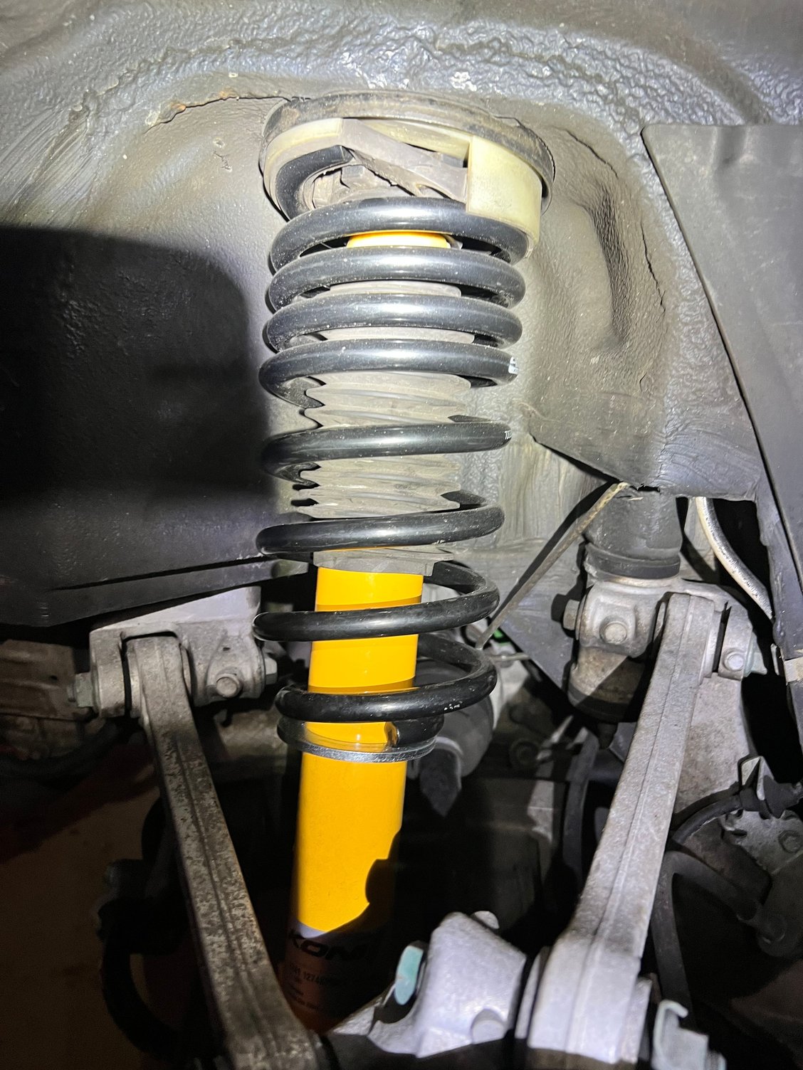

My bad bud, I took the tires off the rear today and saw where the base of the spring hits, it’s more self explanatory than I thought. I saw a diagram on a different site where the spring sat where the damper rod enters, so it didn’t make sense to me. Here’s what mine looks like.
Before I started throwing extra washers on, I'd replace that upper spring insulator and see what happens. It looks like there's something funky going on with yours.
Agreed. Both 4mm and 5mm say they fit my car, does it matter which one? Thanks
