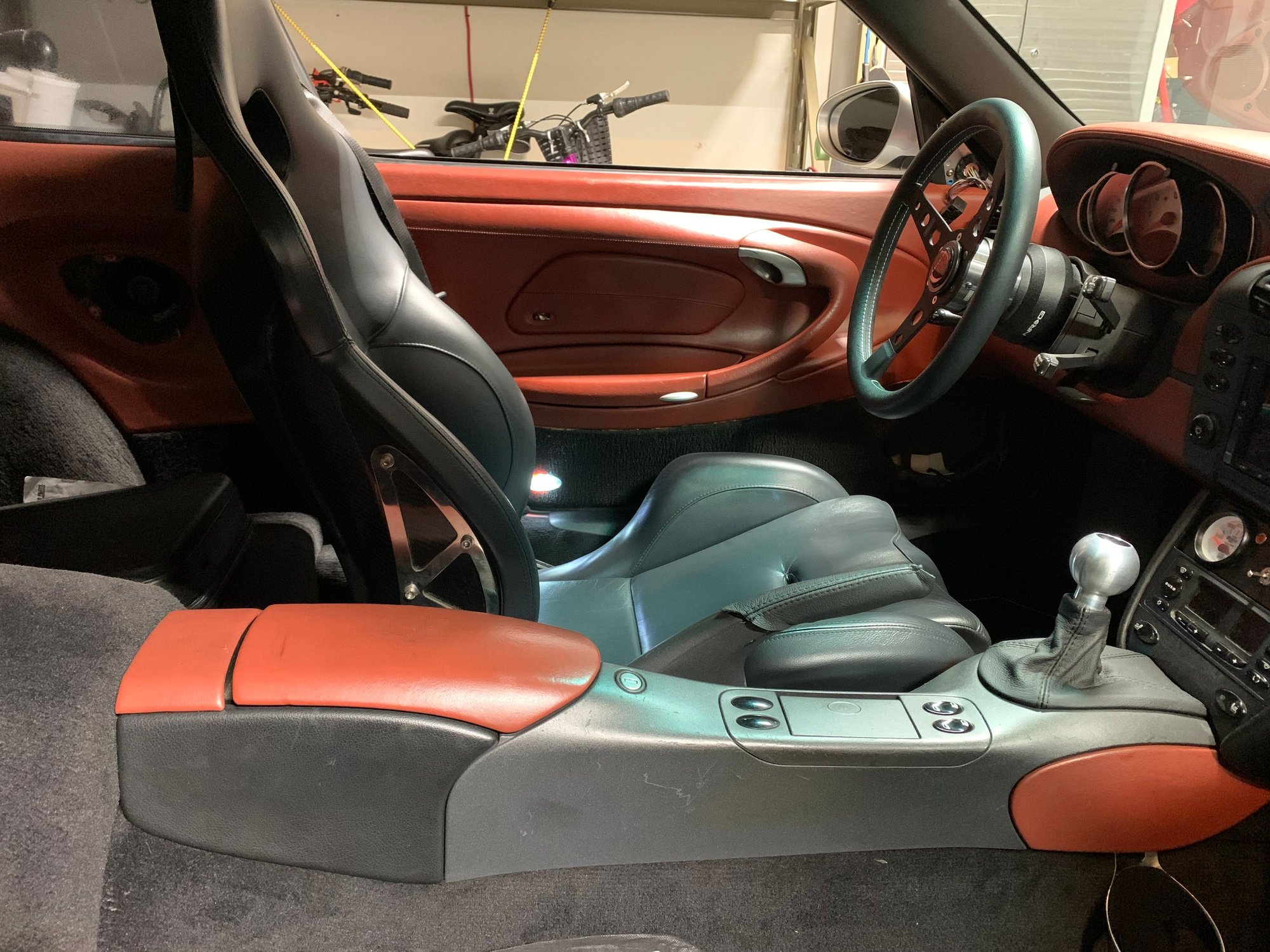

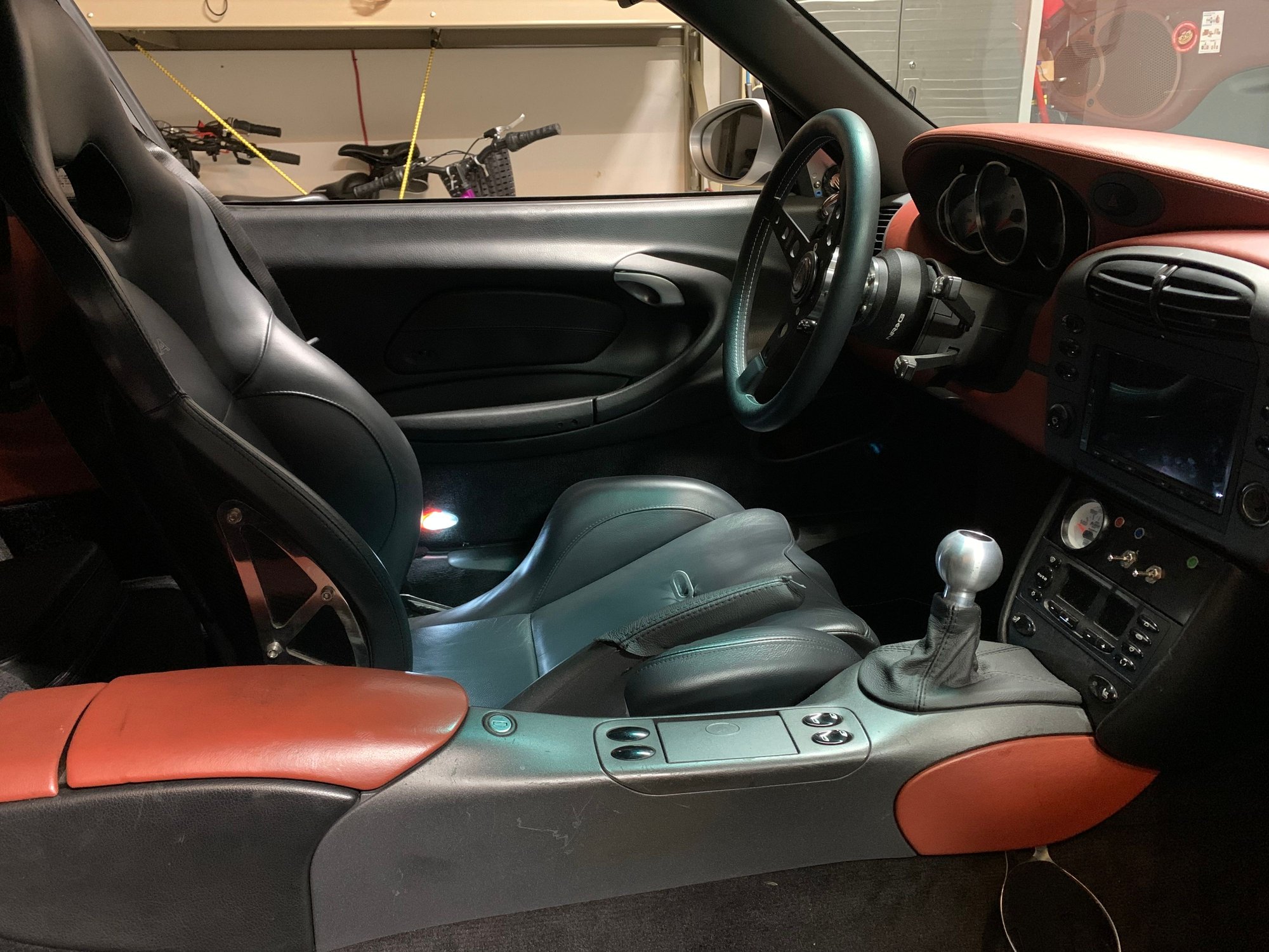

Trying to keep the red dash. Leaning toward red door cards (and inner rear quarter trim).
Carpet, seats, headliner, the A,B, C pillar trim black. Figure the center console will be all black.
think I’m going to follow your lead and get the carpet off Amazon
Picture the console black…and speaker grills in place.

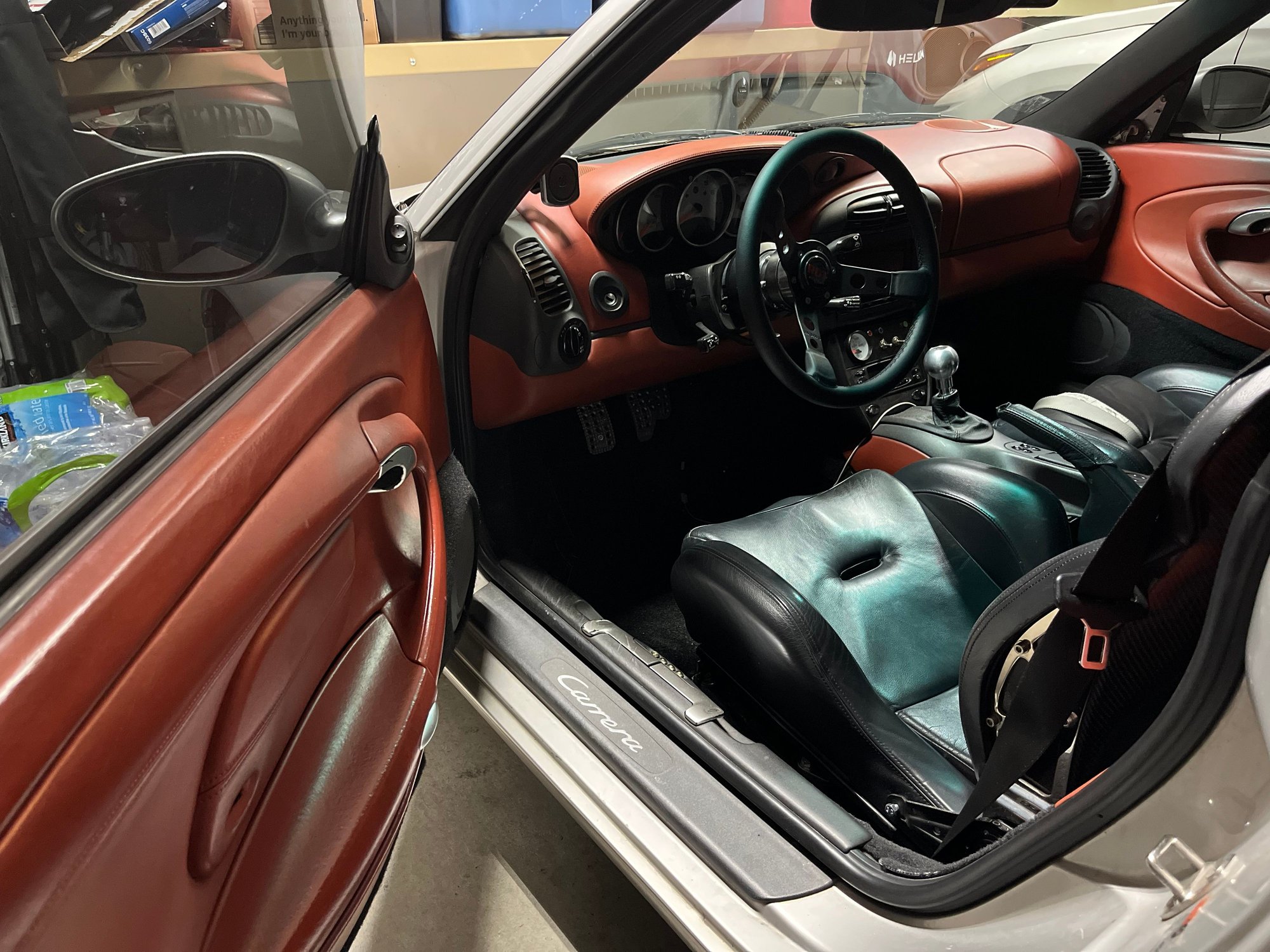

I had used RIT dye to dye some OEM faded black  carpet deeper black. Finally got the color right but stiff. Fortunately that part of the carpet was the rear package shelf and not frequently touched.  Tried to dye the red door carpet black. To stiff. Eventually gave up, removed red door carpet and sourced new black carpet for lower door panels.
