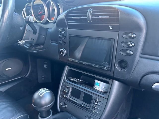

What year is your car? Pre most? I went with an aftermarket HU on my 02 and it works plenty fine with the oem amp.

That’s absurd. All you need is the aftermarket radio and the harness. Maybe like $20 for the harness and antenna adapter. You won’t need a bezel if you stay with a single din

yup I have the Bose system.

welp I’m showing you exactly what they said wouldn’t work.
Old Mar 7, 2025 | 09:38 AM
Vietjdmboi's Avatar
Vietjdmboi
Joined: Mar 2019
Posts: 729
Likes: 206
From: Anaheim
https://cai-store.com/pages/911-boxs...din-conversion
the rca’s on the second plug are not used. Just the single remote turn on wire is. Additionally the first plug provides all the speaker signals from the aftermarket radio to the factory amp.

I believe this is the kit you’ll need for what you’re trying to achieve.
https://cai-store.com/collections/99...y-select-parts
