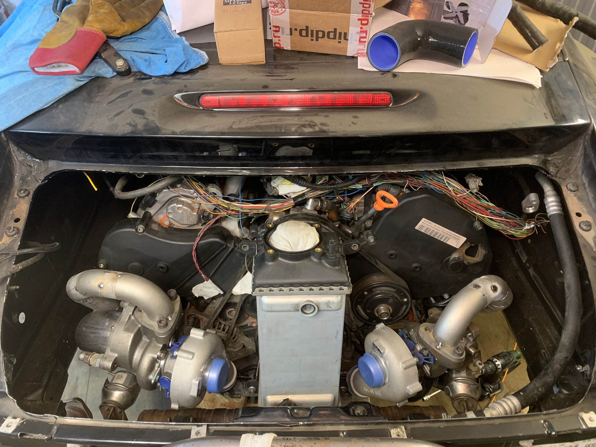

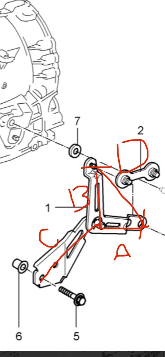

Hello everyone.
I am engaged in the construction of the project 996 + audi 2.7 turbo engine.
Can someone help with the detail? Dimensions are needed for the manufacture of the selector rod.
Length between points.
The ideal result is a drawing ))))

This is a coupe. There shouldn't be many problems with the ECU. In the 99-year-old 911, there is still an analog connection between the units.
The guys in you in the USA are doing LS swap, and don't have big problems with electrics.
The Porsche ECU will be saved so that he thinks everything is fine.

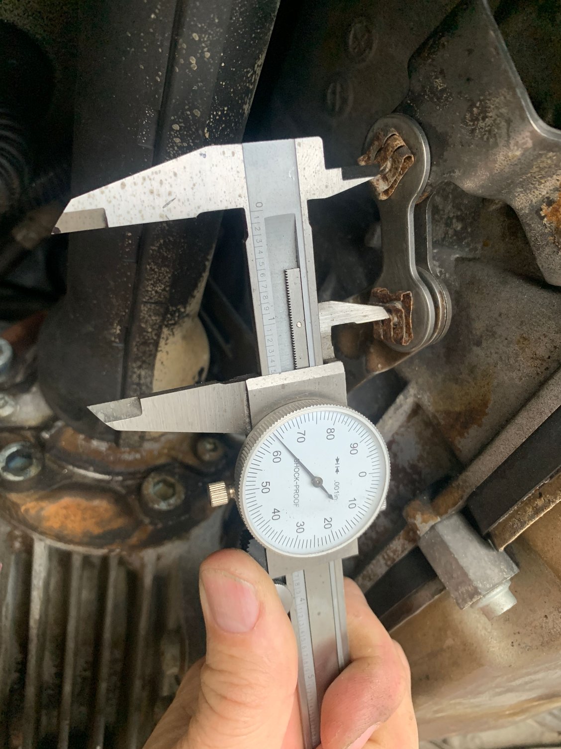

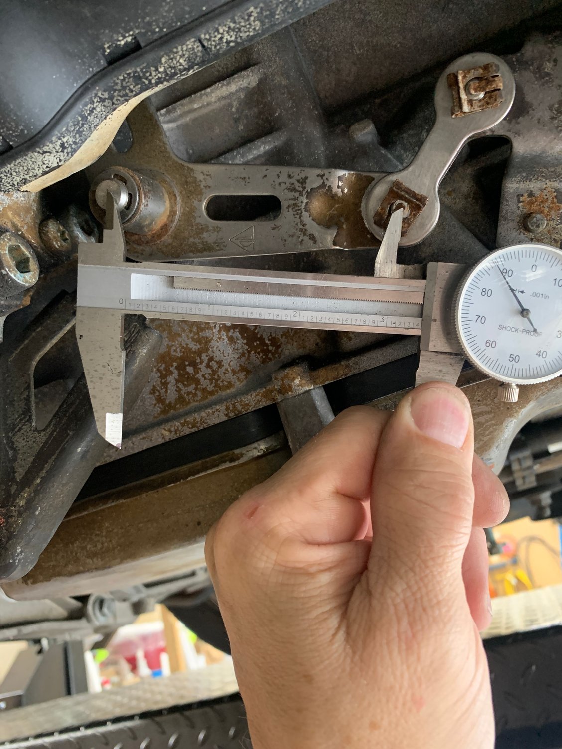

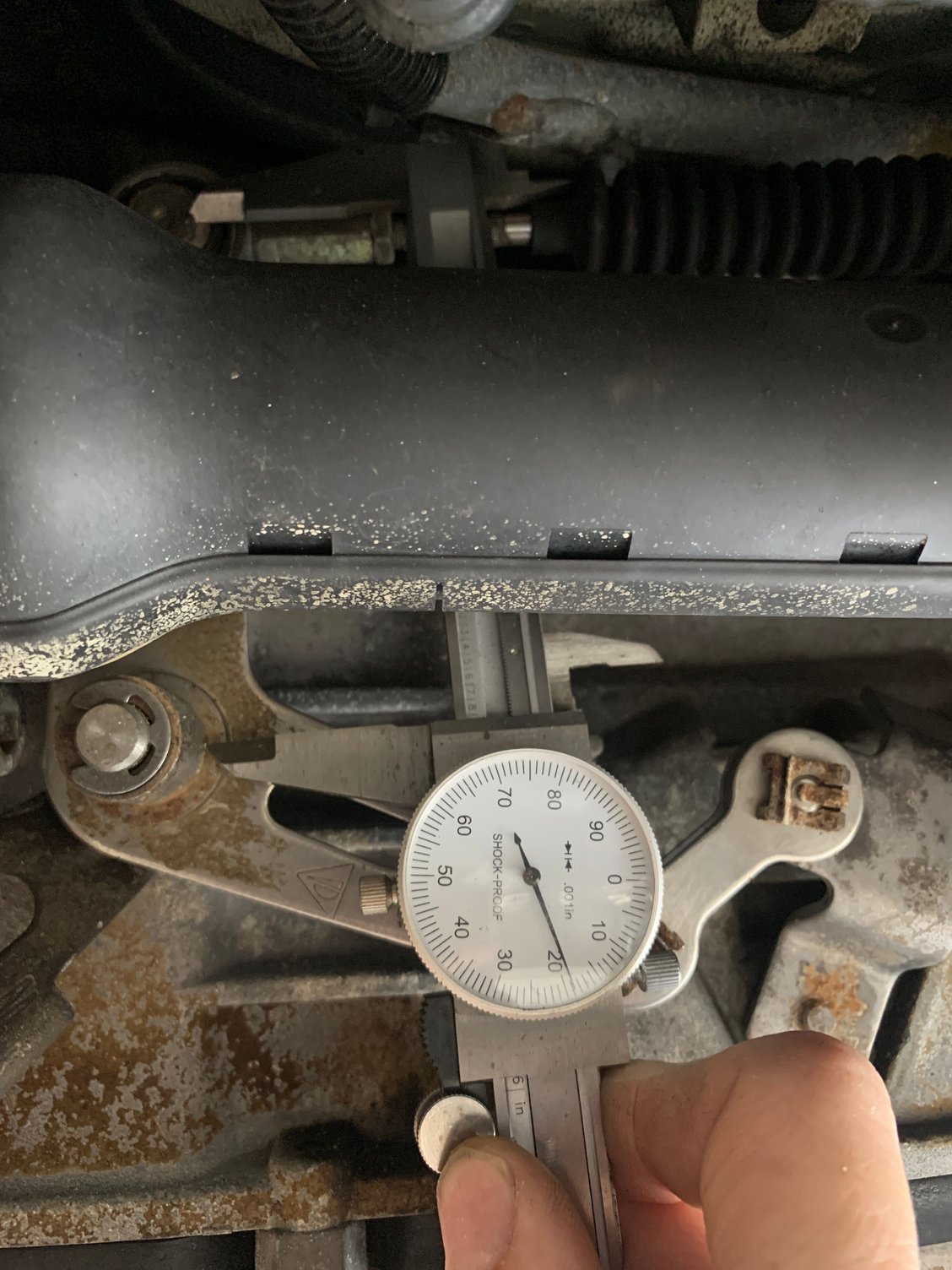

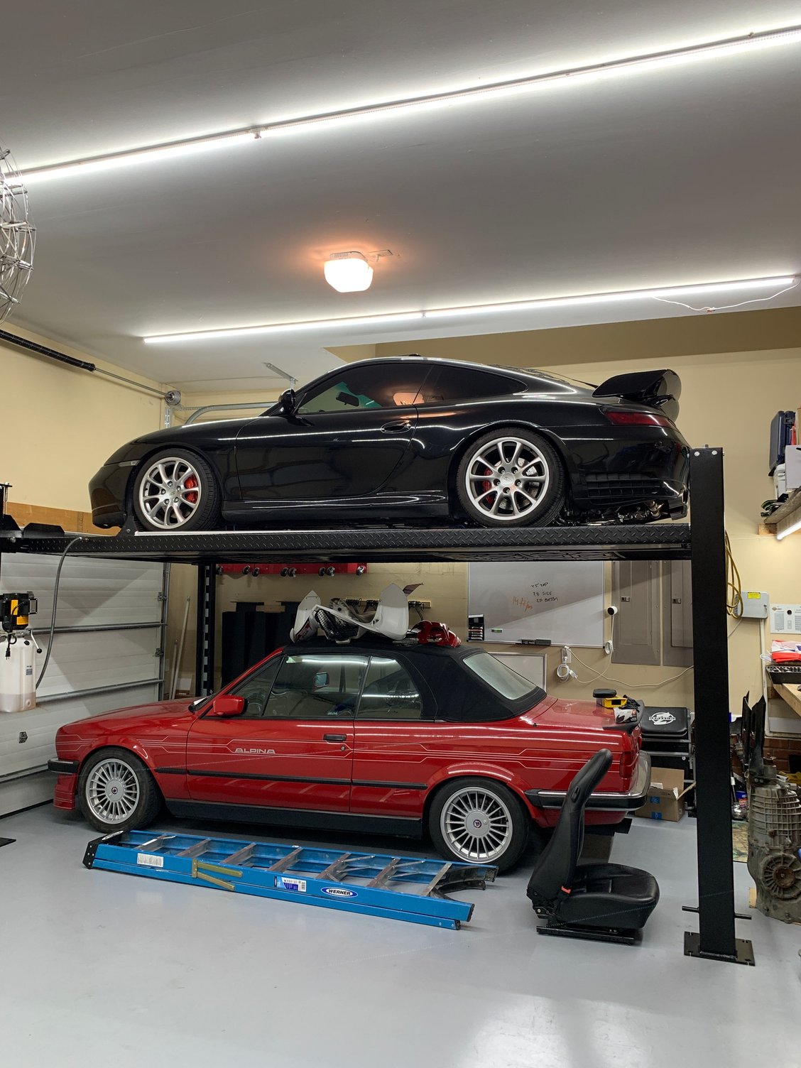

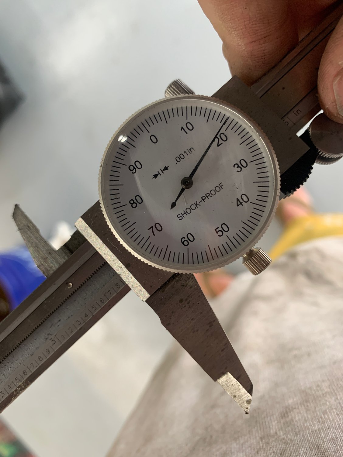

my car is on my lift, trans will be out soon.
Old Mar 11, 2022 | 01:48 PM
red_galstuk's Avatar
red_galstuk
7th Gear
Joined: Jan 2022
Posts: 7
Thank you very much!!! You really helped.
Yes, it's 996.1 1999, but a box with a turbo version.
