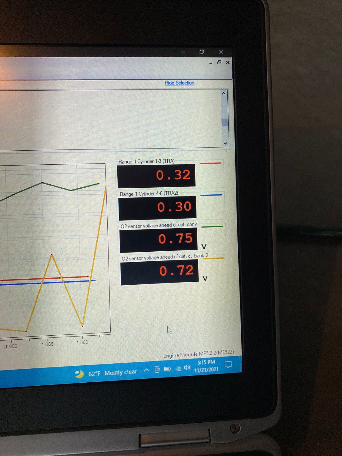

Here are my readings with a hot motor that had been running for almost an hour. It’s at idle, AC compressor off, and the oil cap removed for about 4 minutes.
The O2 voltages both hunt up and down from .09 up to .71.

The TRAs both finally reached greater than .32 after about 7 minutes of idling with the oil cap removed. The codes produced were P0506, P1124, and P1126.
Is my ICV going bad?
With the oil cap put back on, the TRAs both went to -.10 and stayed there.

No, the system is working just as expected when "Commanded Lean", and proves 02 sensor are functioning and fuel trim is functioning.
When "Commanded LEan" by removing oil cap to introduce air that by-passes MAF and TB, the 02sensors react by going to 0.00v then the DME reacts by going -0.36 (rich set point) , and sets codes P1124 and P1126. Code P0506 (IVC) is set due to idle speed has increased due to extra air that is by-passing TB/IVC and MAF, and IVC can no longer lower/control idle speed by reducing by-passed air.
Shows all is working as designed.
