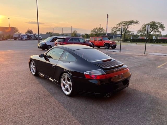

I lowered my 4s with H&r lowering springs. I had to get adjustable toe arms too.
After
Before I believe. Dropped an inch. I haven’t scrapped yet but I’m pretty careful.

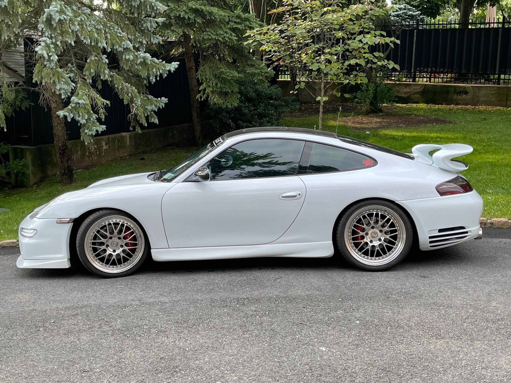

Before me
This RAISED 1.25 inches from previous owner Absolutely perfect now but the slammed look was nice just not in NYC JIC/Cross suspension on 19” HRE 540R

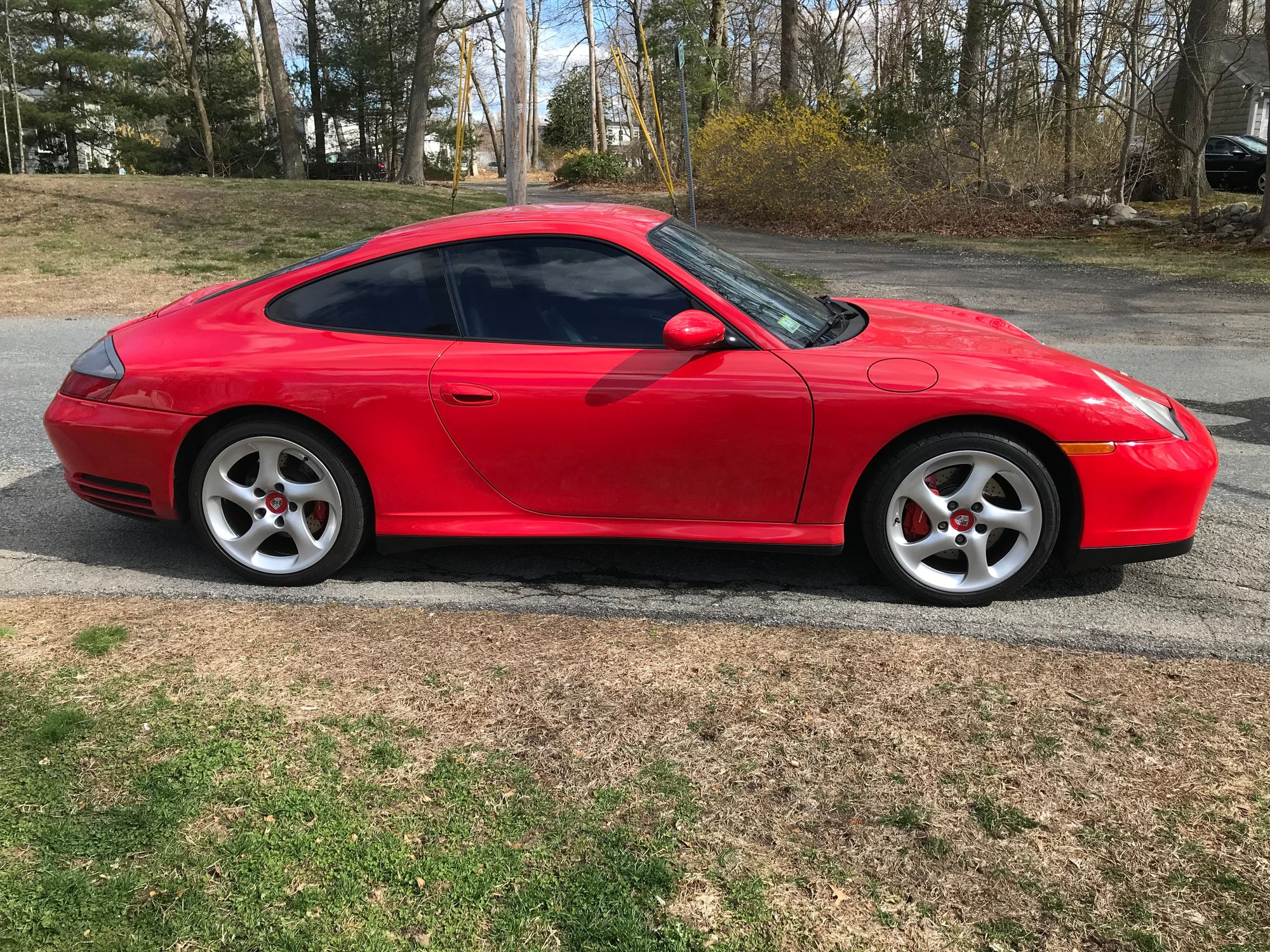

Mine on H&R lowering springs

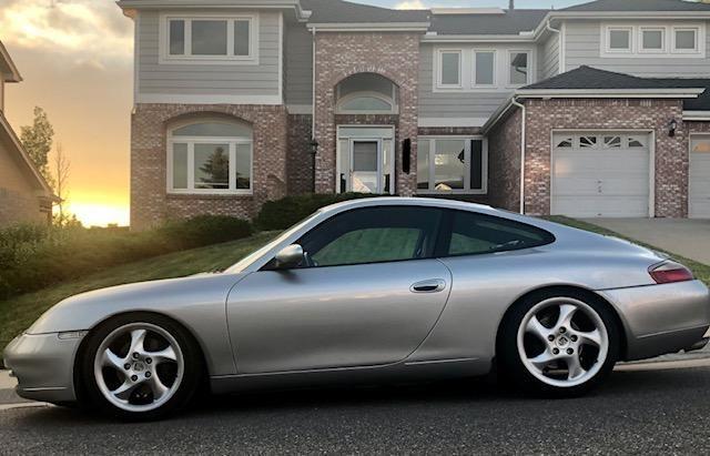

I noticed with mine, it made the rear 18x11’s look smaller so I added 15mm spacers to counter. Not shown above, see below.
H&r, bilstein b8’s and 15mm spacers all around. As mentioned, adjustable toe arms needed. Cost to install was roughly 1700 all in with alignment. I didn’t have the stomach to do it alone.

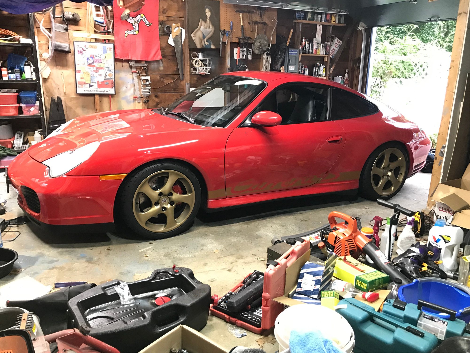

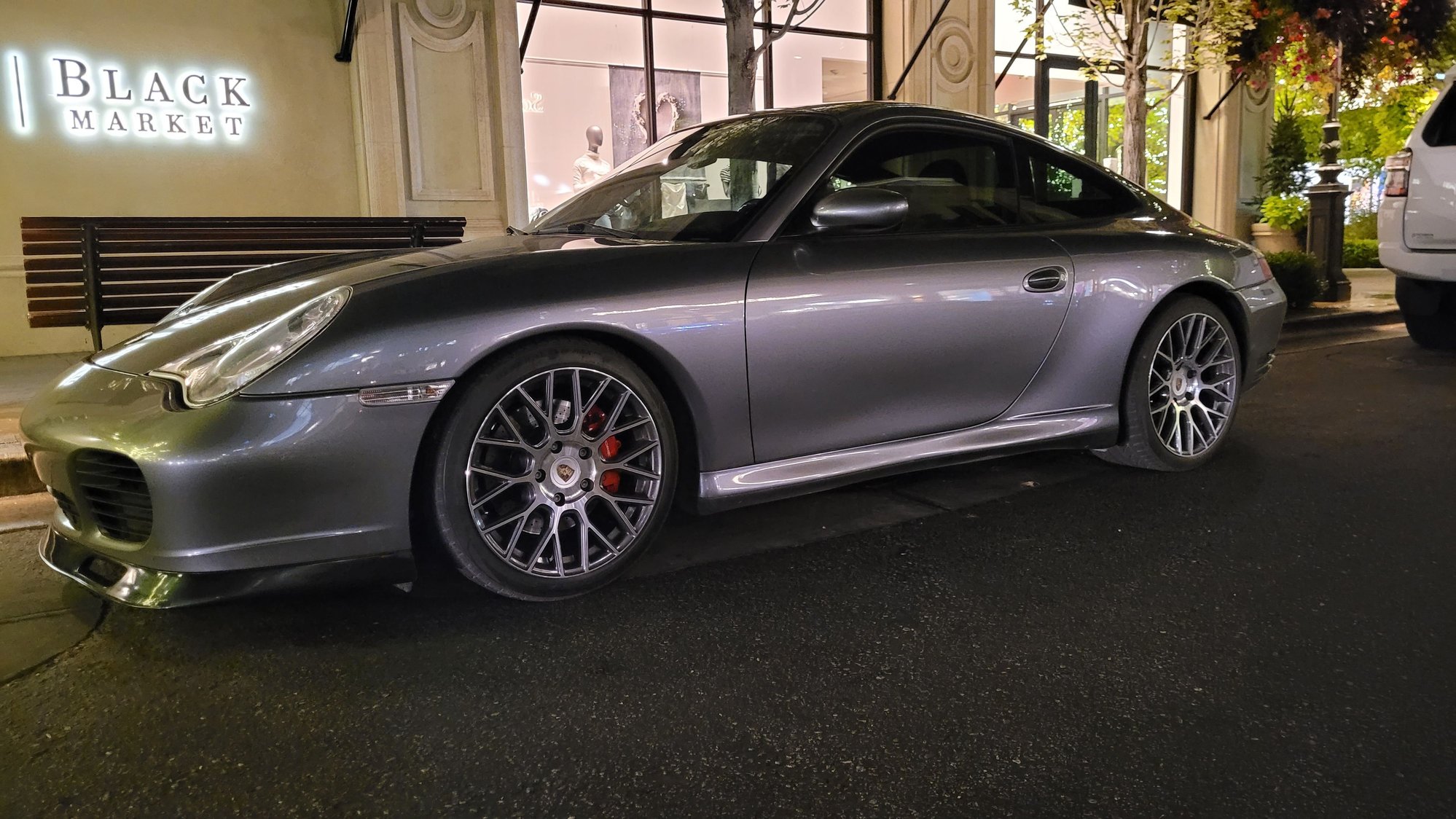

Most coilovers will allow you to go lower than any of the "lowering springs" do. With my PSS10's I was able to get to GT3 height, that was a little low for me so I raised it to GT2 height. Which is 118mm front, 138mm rear. That's 40mm lower in front from stock and 30mm in the rear. I had the car aligned to GT2 specs with the stock rear toe arms, all came in perfect. In the future if I want to go up or down I can, I like that aspect. My vote go coilovers, also the ride quality is night and day better than it was.
Only picture I have so far

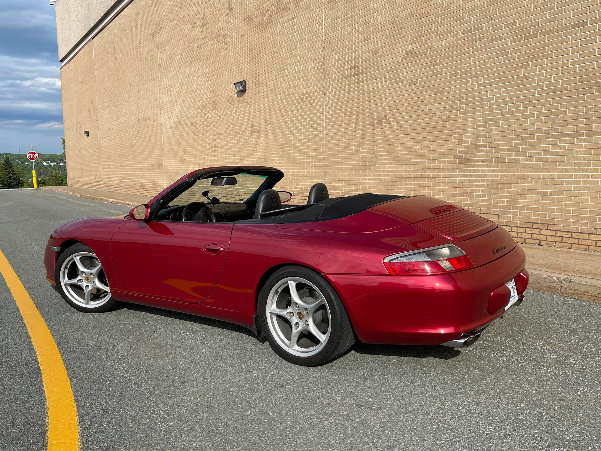

I did Bilstein B8s and H+R Lowering spring on mine. Happy with stance, but also had to buy adjustable toe arms and rear upper control arms to get my specs into something that was tolerable for the street and didn’t absolutely destroy tires. So, be prepared and go in with you eyes open. Coilovers would be nice , as you could maybe raise ride height just a little to get past any alignment issues.

c210rg Thanks for the info. What wheels are you running. My C4S is also Seal Grey so I think seeing what different wheels look like on the actual car. I also see you swapped out the door handles. Was that a PITA or not a big deal and did you have to get them painted to match the car or did they come painted?

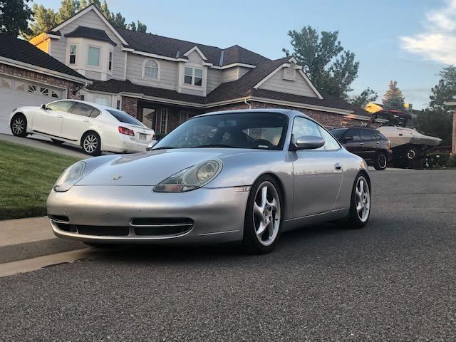

Hey, the wheels are Victor Stabils, Rear 18x10.5 ET-55 Front 18x8.5 ET-45. The original owner who I bought the car from had ordered them in gun metal to try and match the seal grey paint, see picture. The door handles are stock as far as I know. Hope this helps. Here is a link to wheels. https://www.victorequipmentwheels.co...ims-stabil.php

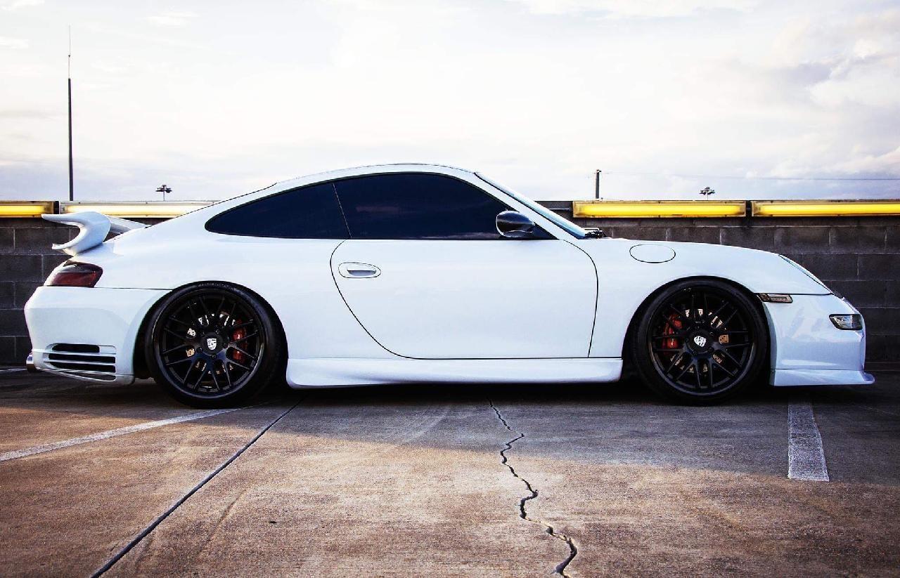

Lowered on Feal coilovers, Tarrett rear adjustable toe links, Powergrid drop links, Eibach sway bars, and rear 996 GT3 LCAs.
File Type: jpg
