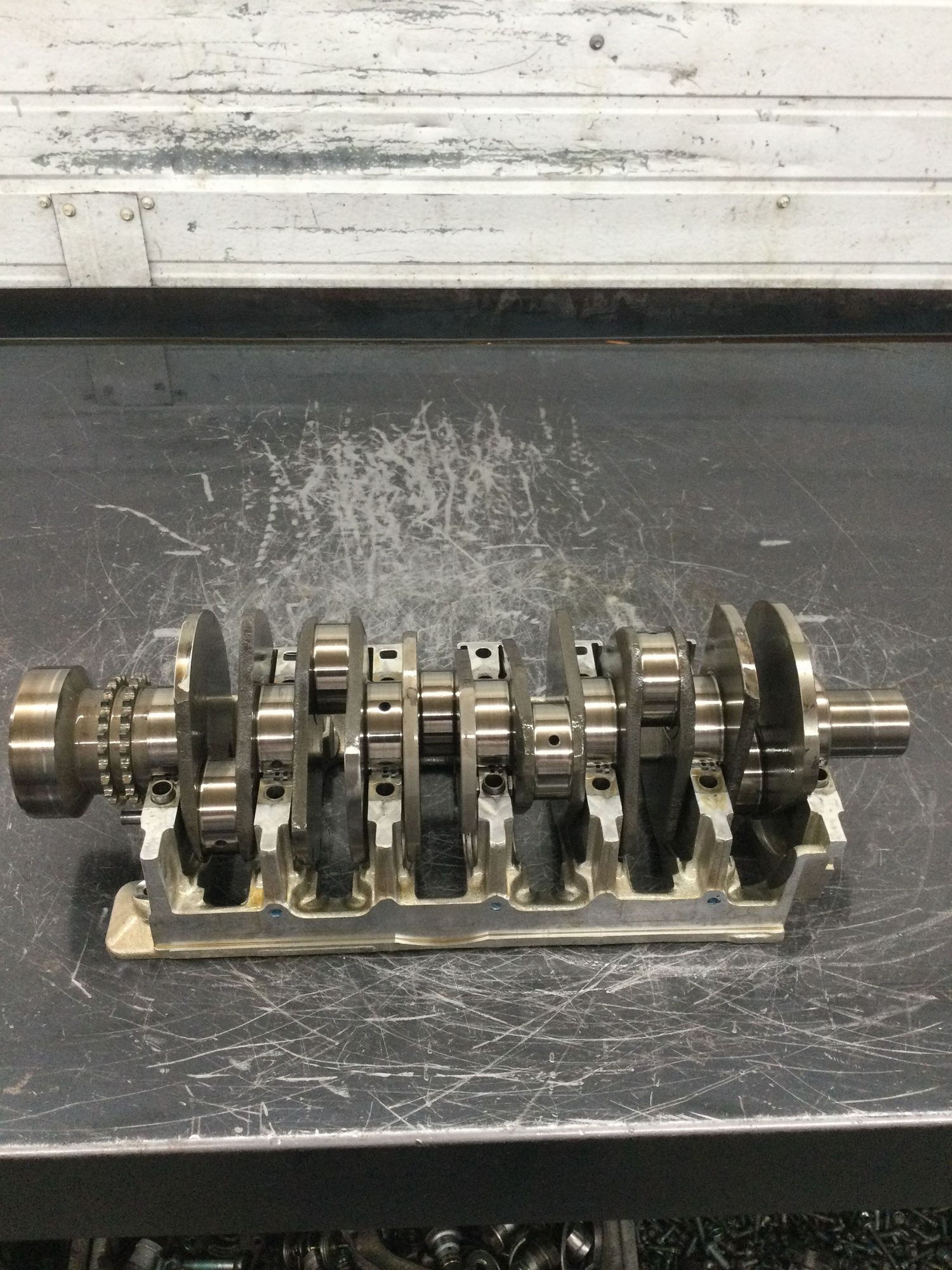

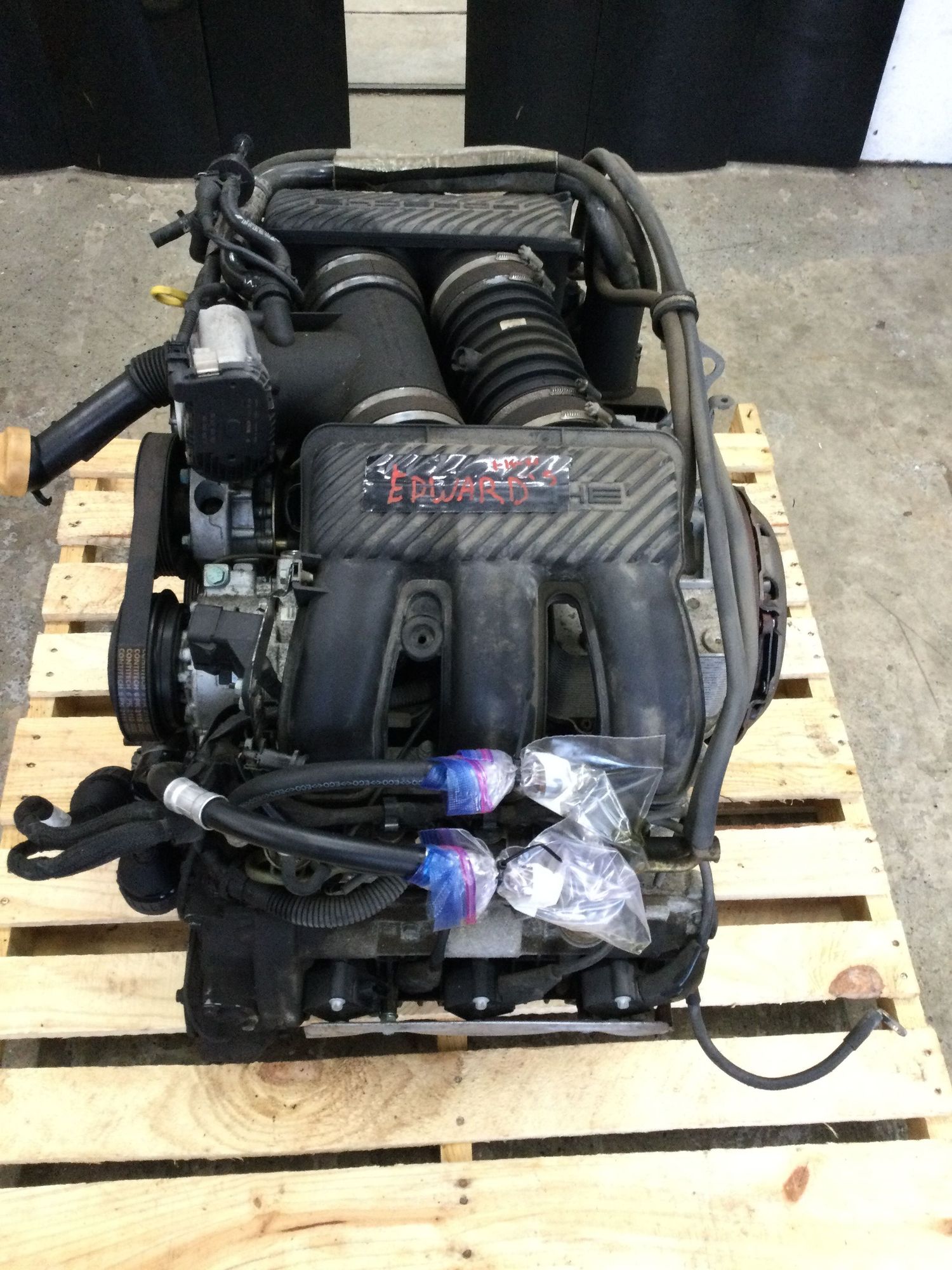

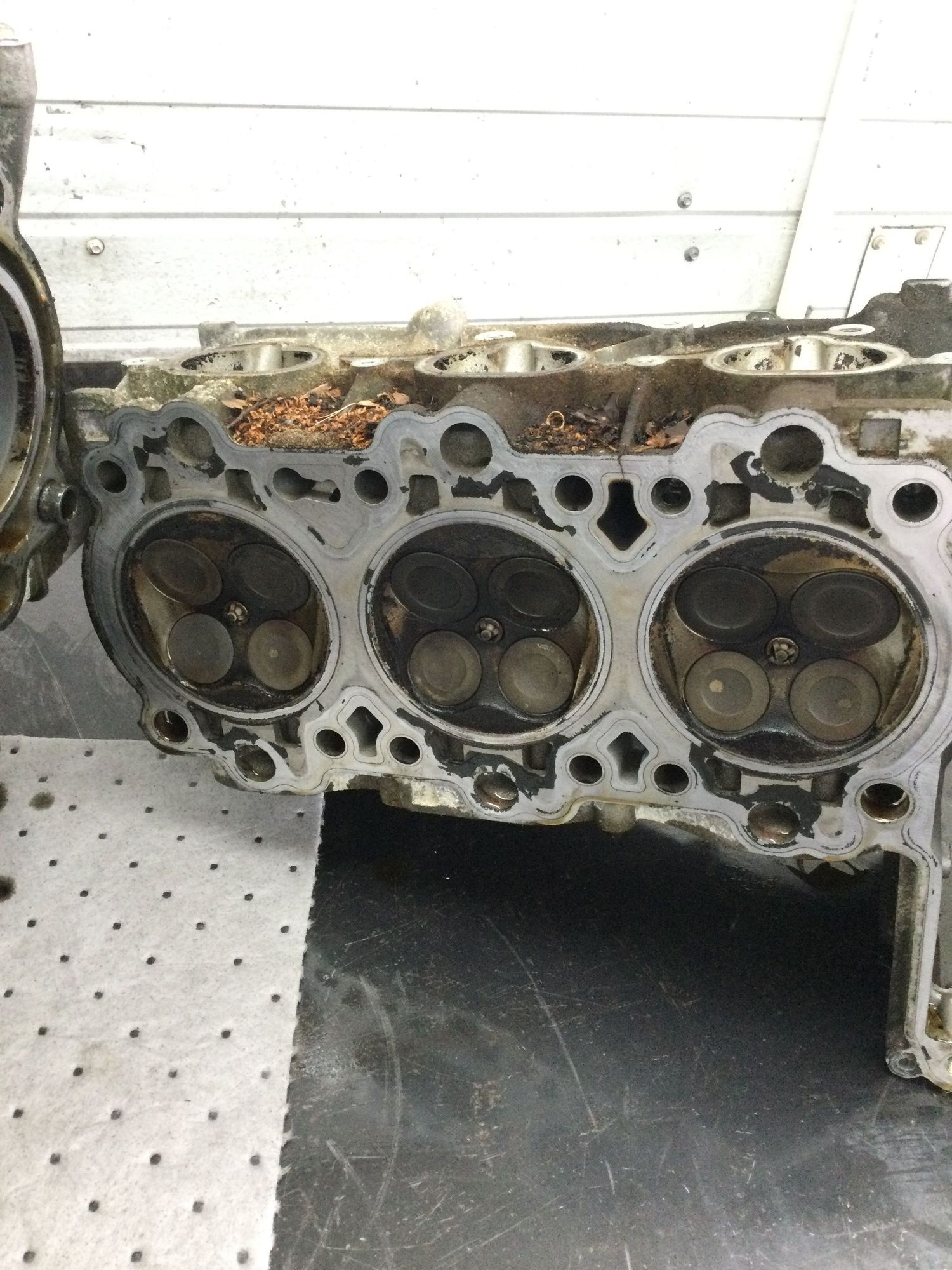

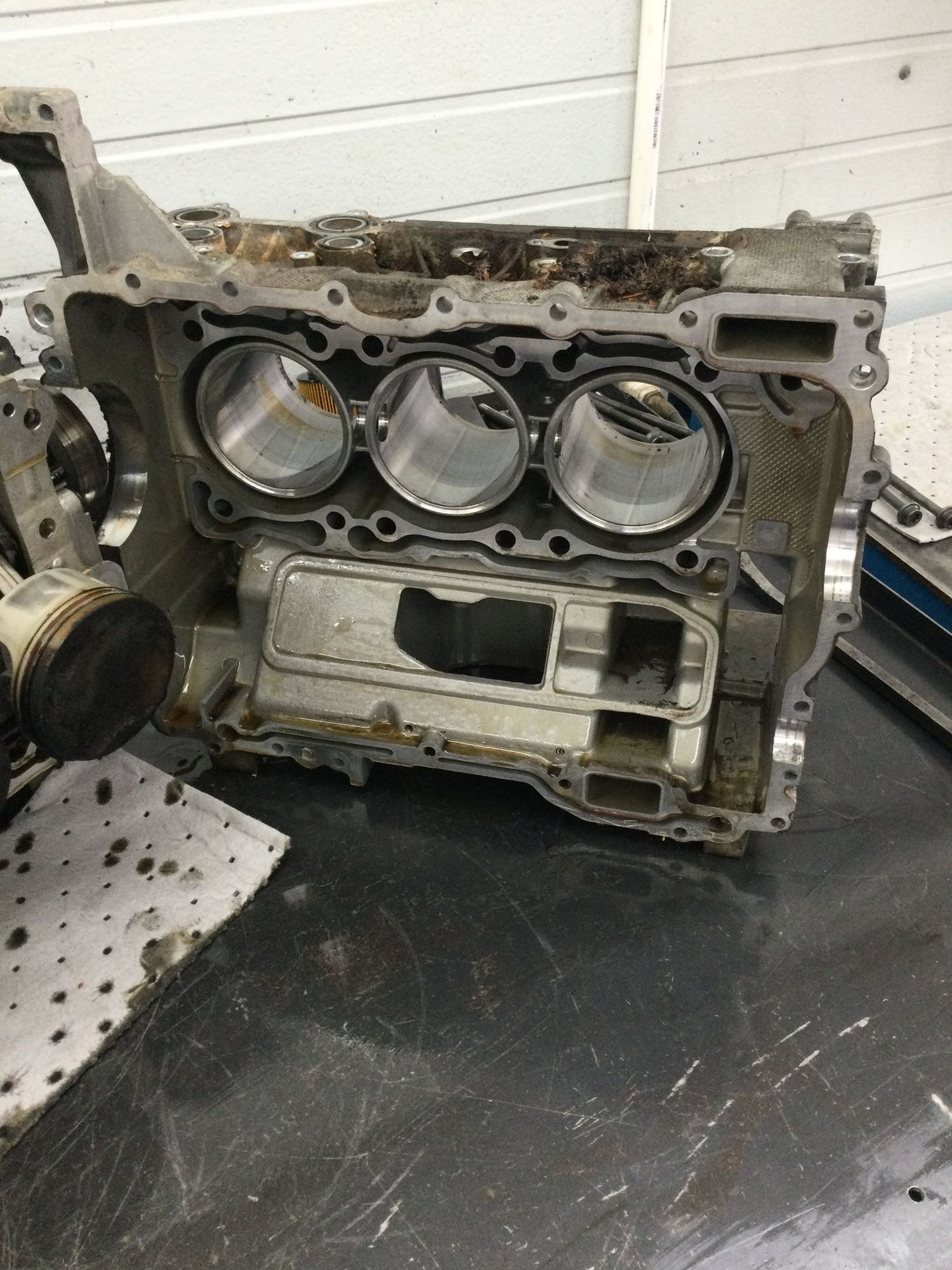

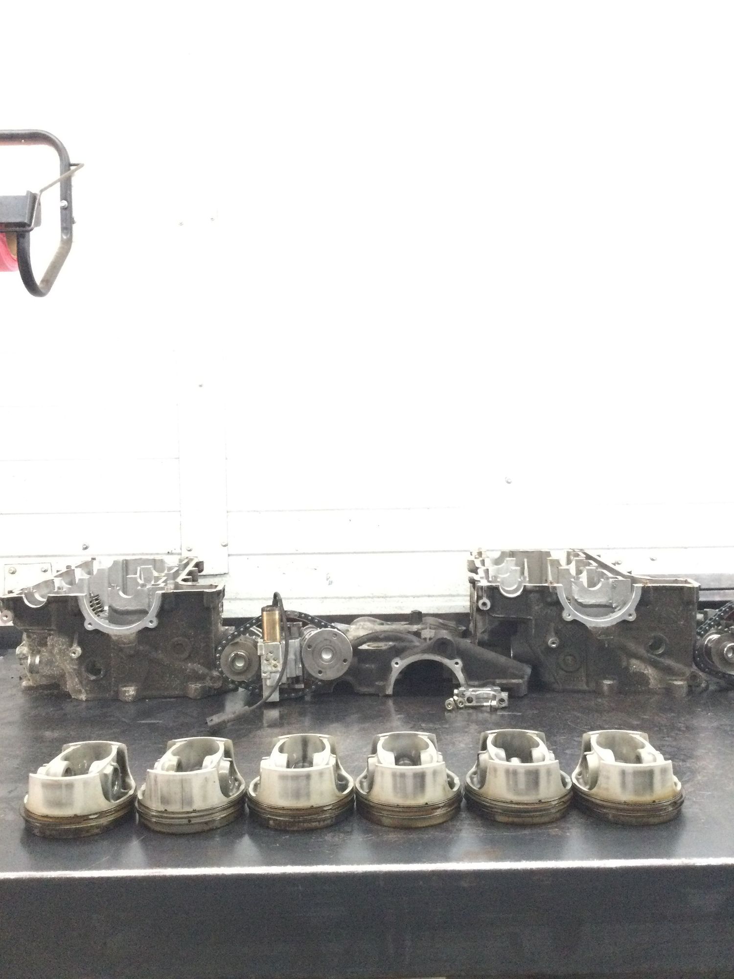

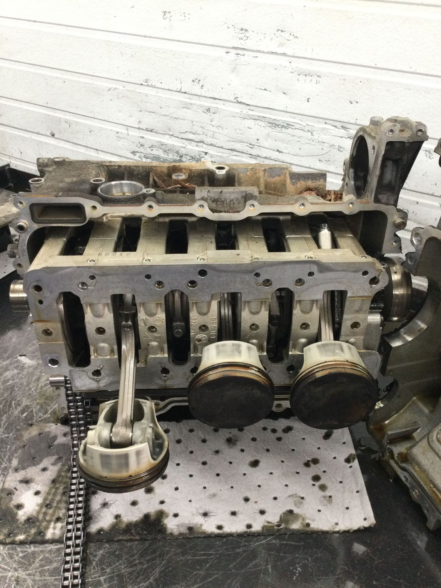

My Stage 1 build has finally started. I had a nice chat with Jonathan@FSI and he sent a bunch of pictures of my engine in various states of disassembly. I've included what I think are the interesting pics with some commentary. Good news for the most part. Things looked good though the piston skirts are showing very early signs of wear that lead to bore scoring.
Arrival!
Heads come off
Valves showing normal wear
Pistons showing normal wear
No bore scoring ... yet
Crankshaft looks pretty good
Early signs of scoring - piston skirts showing wear

Only 35K on the motor. This is an elective build but I was still surprised when Jonathan told me about the early bore scoring signs.

I bet they all have early signs. Jake had mentioned in the webinar that every elective build they see shows some signs

My piston skirts looked like that when I had the case apart, the engine had +200K mile and no bore scoring what so ever. Have detailed pictures of it.

Mine at 153k miles, looks pretty similar on the piston skirts. Bores were clean, nothing even close to catching a fingernail on either the bores or piston skirts. Elective rebuild in progress.

I looked at the components for @blacksquid today, 5/6 cylinders had stage I failure, and 1 if them had stage II failure well underway.

Yours was a full blown, Stage 4 "as bad as it gets" failure.
