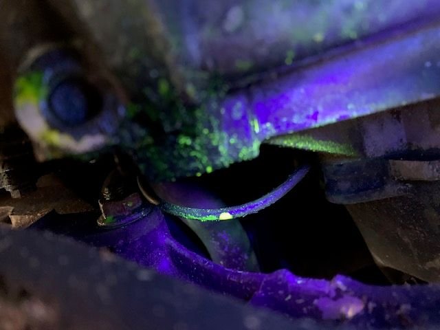

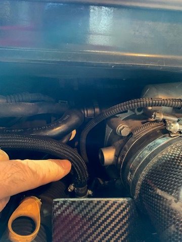

This is the hose that was replaced a few weeks ago after first replaced water pump before figured out this was the leak.

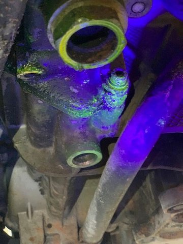

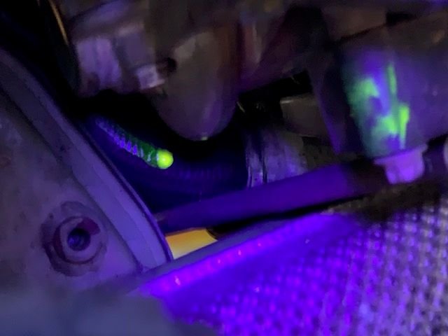

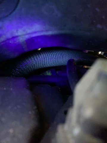

Got underneath to pull the plugs and saw:
No drips, but wet. Has been sitting since Thursday morning
Coil cylinder 3 - definite drip I know this wasn't there when replaced water pump
Variocam? by cylinder 3 - definite drip I know this wasn't there when replaced water pump
Definite drip
No drips, could be left over from prior leak
Coil cylinder 1 - definite drip I know this wasn't there when replaced water pump
Driver's side back of engine were mates to transaxle
Above driver's side bank. Wet.
After replaced the water pump, I pressure tested the system. No pressure drop. As said, the coolant tank is new (still nice and white).
Ideas?
