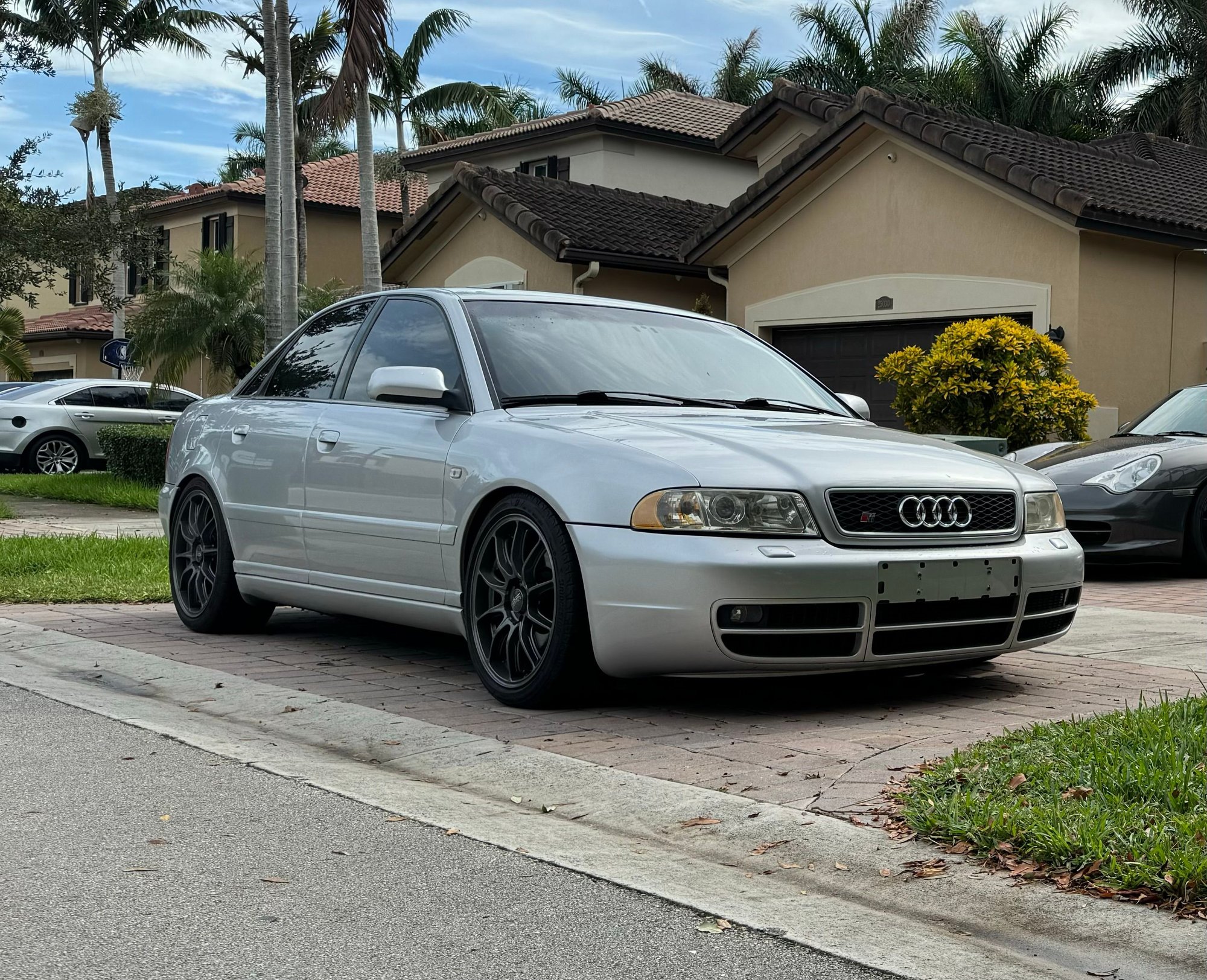

Ended up getting the full piston rebuild kit for the fronts and the seals for the rear via Ohio Performance with the link provided by DeJeeper. Also got a set for my 18Z Brembo upgrade for my Audi S4... need to stop buying cars that need full brake work. Haven't done a caliper rebuild since Auto Tech school and I have all the required tools for the build, gives me a chance to do the annual brake fluid swap as well a full hardware refresh.
The other update is I ordered the Cargraphic Super Sound exhaust from Flat6 Motorsports, they've been good to me in the past and the FVD is providing the install kit. At this point I assume everything is corroded or needs to be replaced. The kit comes with all new clamps, nuts/bolts, and gaskets. I have no idea what cross pipe is in there... don't think I've ever looked, good time to inspect it. Feel pretty confident I'll get most of my 2025 list done before I redeploy in the June/July timeframe.

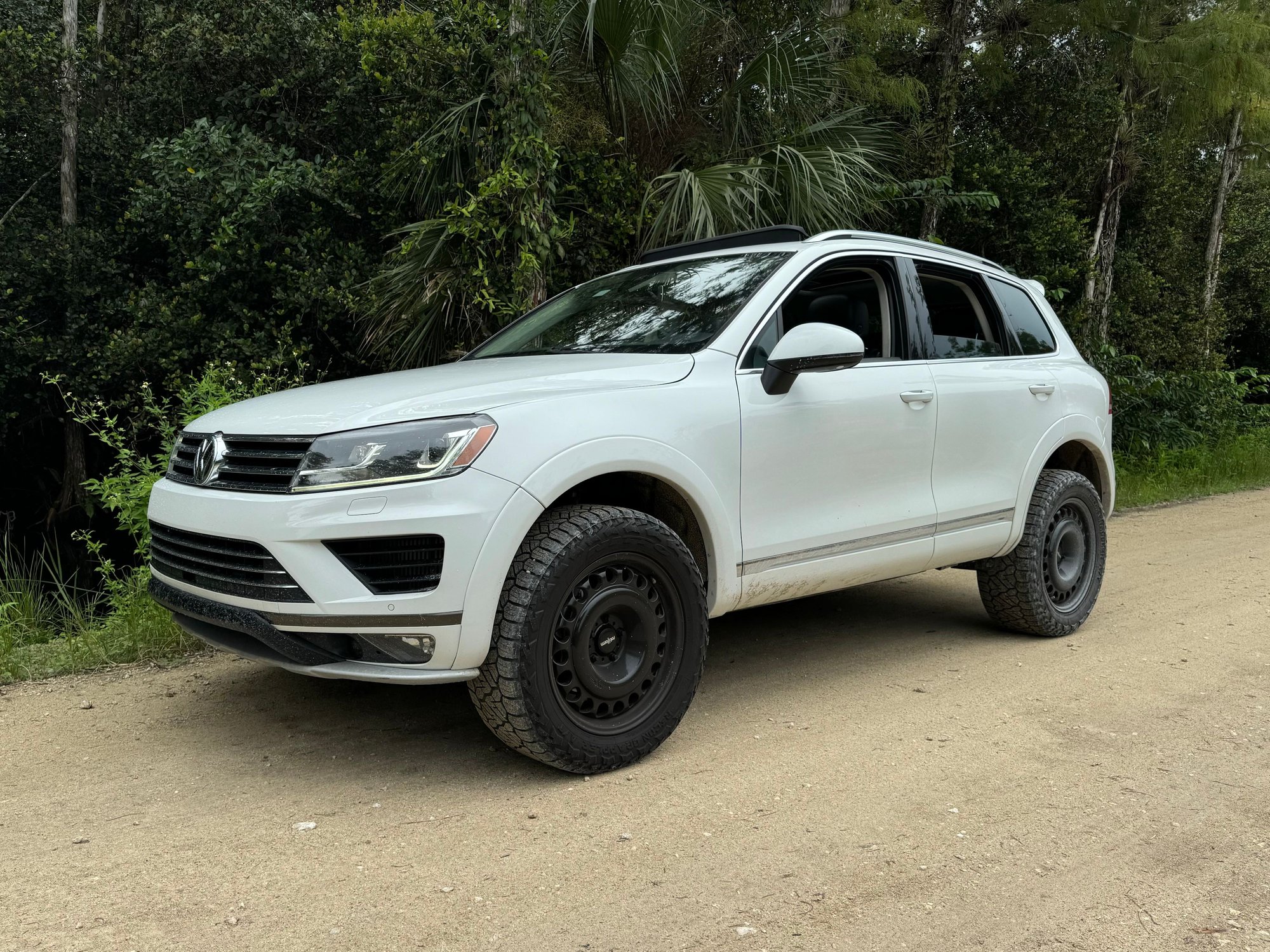

Sadly I need to work on my other cars too. The VW is getting:
Eurowise Roof Rack
Eurowise Trigger controler
Eurowise Ditch Light mounts
Baja Squadron Lights
Kerma TDI intake

My ADD is strong so I'll have to prioritize the cars with the VW being first, she's my daily. Porsche requires the least amount of work(surprised for sure) and the Audi is 25yrs old, the suspension is the one it rolled off the assembly line with.

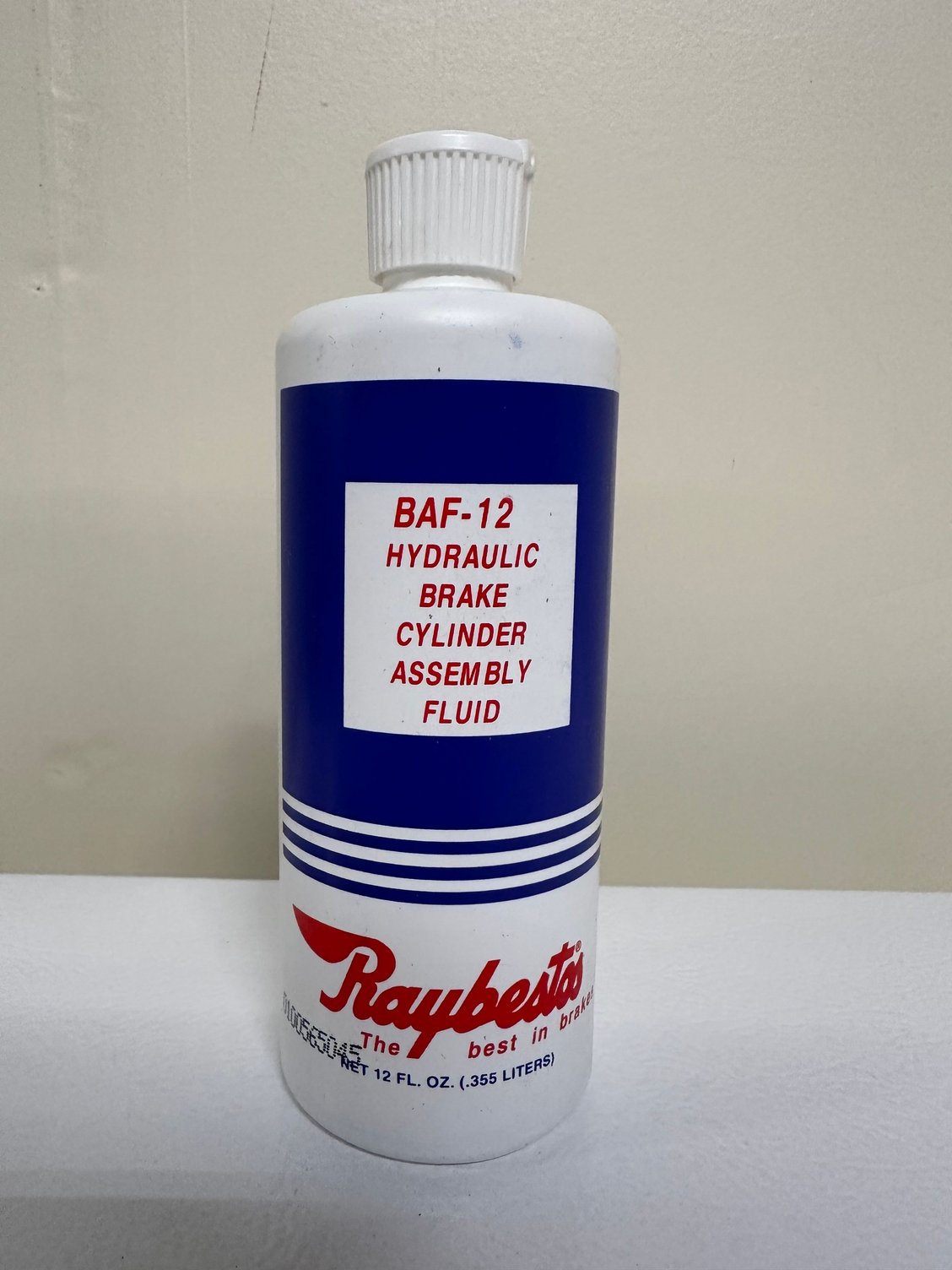

Shoot- I could have thrown a little bottle in the kit - I stopped putting the dropper bottles in about 4 years ago - USPS...
I only use caliper assembly fluid on the piston and never anything on the dust boot! Keep that nice and clean!
On the 18z sometimes they are a little finicky if they have been painted incorrectly. If you have any trouble, get a q-tip and wet it with hairspray. Use that q-tip to wet the outer part of the dust boot and it will then pop right in saving your fingers a lot of pain.

You're reading my mind! Frenkit does have their own single serving bags they put in their non-performance kits. I plan on including them in the future if at all possible!
I have so much of this left over.
