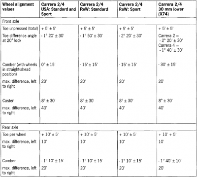

My car is going in to be lowered. Would I use the same numbers or does everything change?

Toe is generally kept the same to prior values but can be changed to improve certain aspects (initial turn-in, straight line running, braking stability to name a few). There's always a trade-off though.
Camber change will result from the lowering and this slightly more negative camber is considered a benefit to the handling of the car.
I believe caster angle is not adjustable on the stock 996 (neither front nor rear).

Those numbers will change when the car is lowered (as I explained in the first reply) in that sense you cant 'keep' them.
But you can 'keep' front and rear toe the same as long as you are willing to have them set back to those specs.
If you are not, then I would wait with lowering the car until you are...
Lowering will result in more toe-out at the front than the 0.5° you have now and in more toe-in at the rear than what you have now.
Since the front toe setting is already out of the factory specified range (spec is toe-in, not toe-out and you have a hell of a lot of it) you must expect greater inner shoulder tyre wear and probably lousy straight line running on anything less than flat roads.
The long and short of it: the car will drive better when you leave it at its current ride height than lowering it without having front and rear toe readjusted.
Look at how front and rear toe factory specs remain the same between different ride heights in a range that covers 40mm. Based on that it's easy to see you should re-adjust toe after lowering.
BTW 5'=5/60=0.0825° (degrees) and 0.5°=0.5x60=30' (minutes) so your front toe is set to a value that is more track oriented than road (good for initial turn-in, not so much for straight line running).
