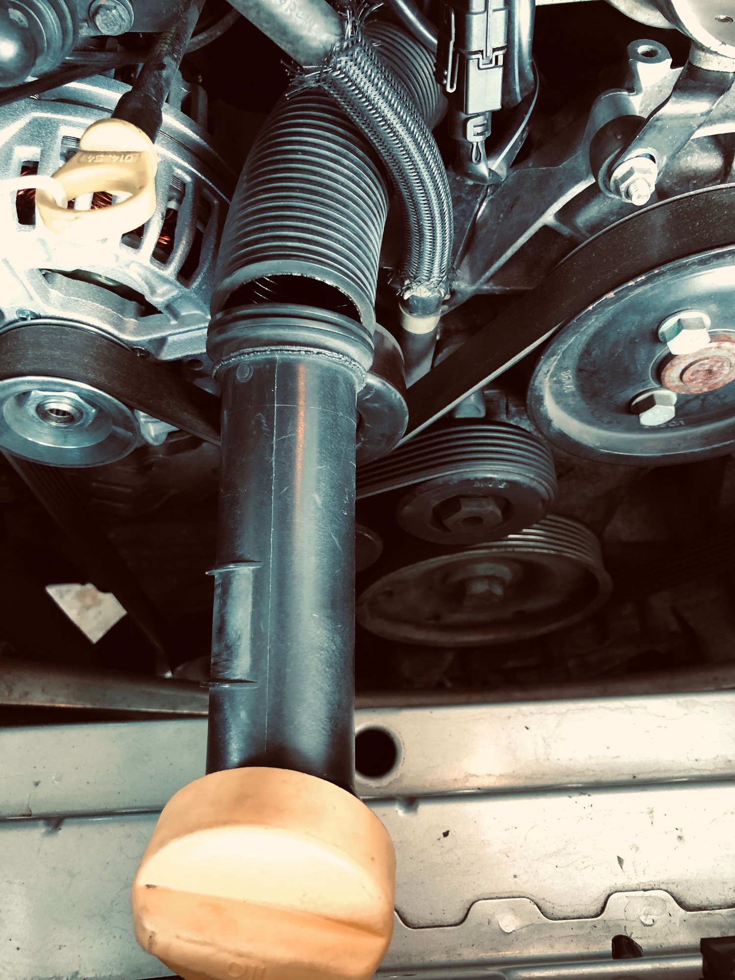

If you’re up to it wrap a piece of duct tape around the area most likely to crack in the oil filler tube and see it you notice a difference in the idle.
here’s a pic of my broken tube. Same crack location as many others I’ve seen. I’m certain there was a crack there before it got to this point. And I handled this thing a dozen times and noticed nothing before one day wrenching it just appeared. Weird.
Not a bad idea. I can give that a shot.
