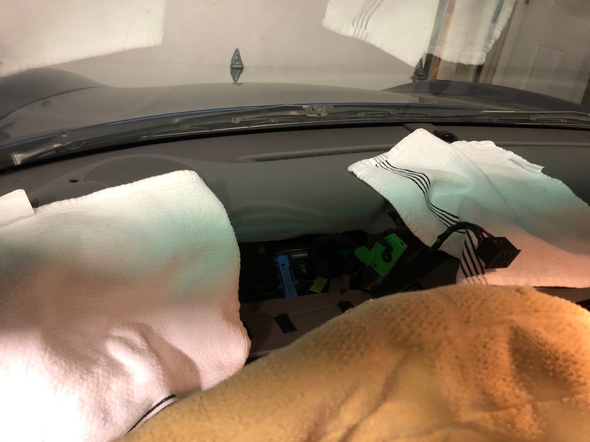

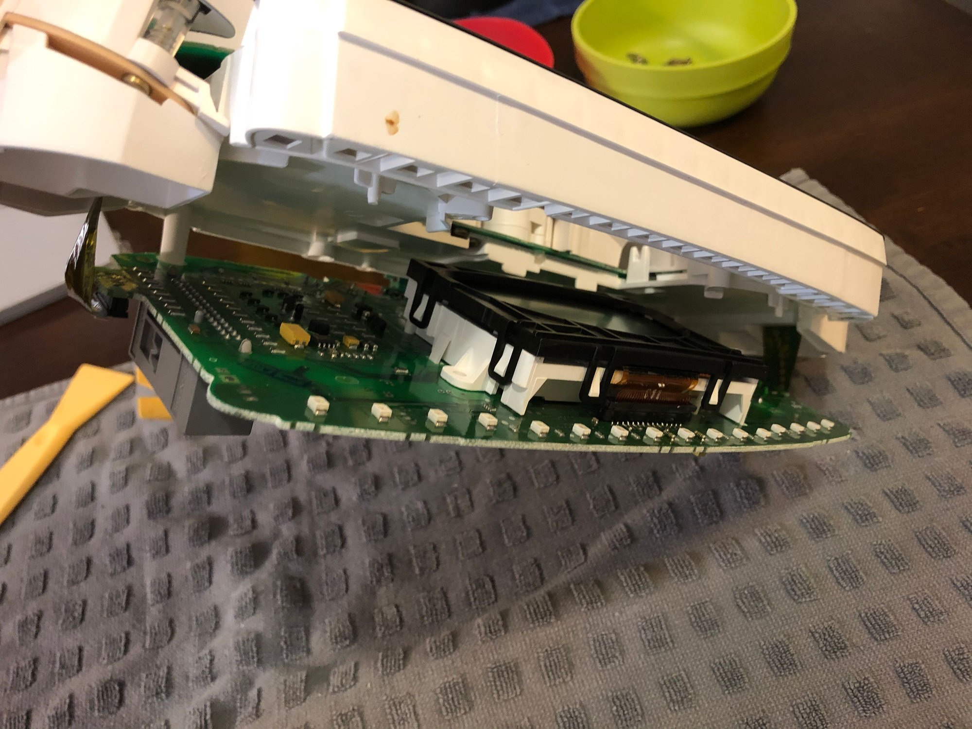

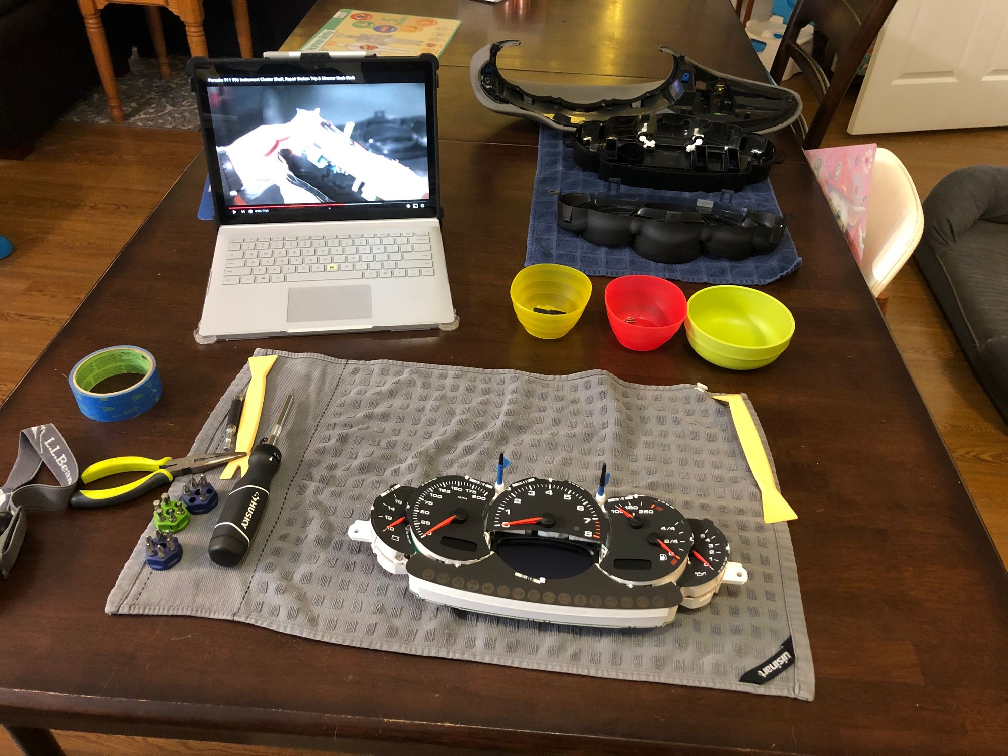

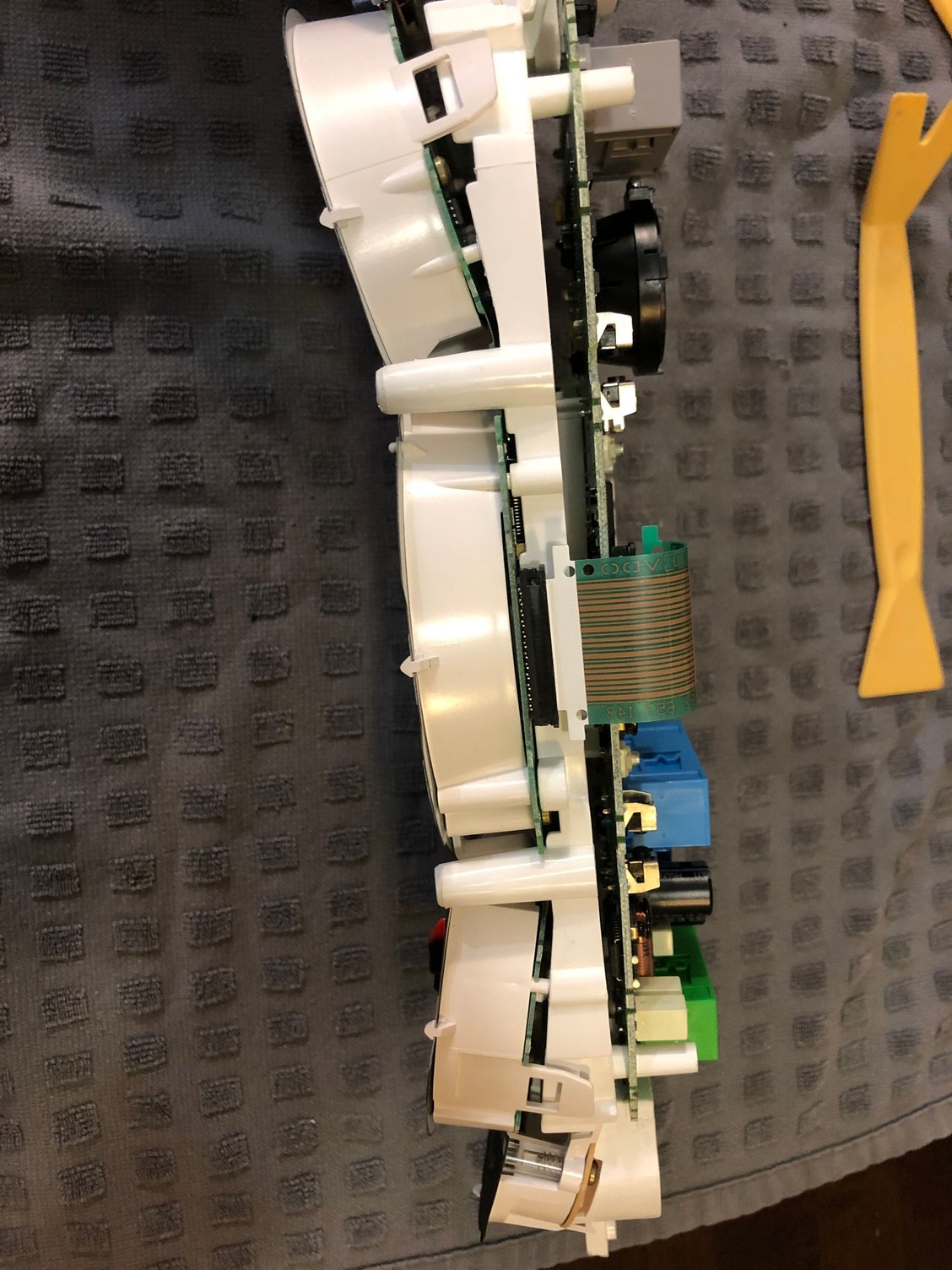

So, tonight, I pulled the cluster from the car and started taking it apart to see if I could find a ground or mating issue with the servo motor for the needle. I got to a point where I no longer felt comfortable pulling apart the circuit boards as I didn’t want to break it while looking around. I did a quick lap of the neighborhood to make sure everything else still worked (which it does, thankfully, except the trip odometer reset) but still no speedo needle. When I put the car in accessory, the needle moves slightly down to below 0 and then back to 0 so I think there must be some electrical connection that is subject to thermal shock and has a mind of its own. Ultimately I have the digital speed and the tach is in the center for a reason, but it would be nice to have this addressed at some point. I’ll add some pictures of how far I got taking things apart. Any advice going forward? There’s nothing wrong with how the car drives and I have no plans to sell it. Thanks, y’all!
