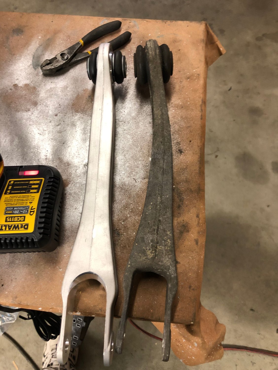

I changed all the control arms and the tie rod ends on 1999 996 Carerra. I took it to an alignment place recommended by two local shops that do Porsche work. On the way home the car tracked great on the high way and the steering wheel is right on. All seemed well. The car handles well, and is much less twitchy with the new control arms etc. A real difference. As you can see one of the rear arms was a little bent by the previous owner...

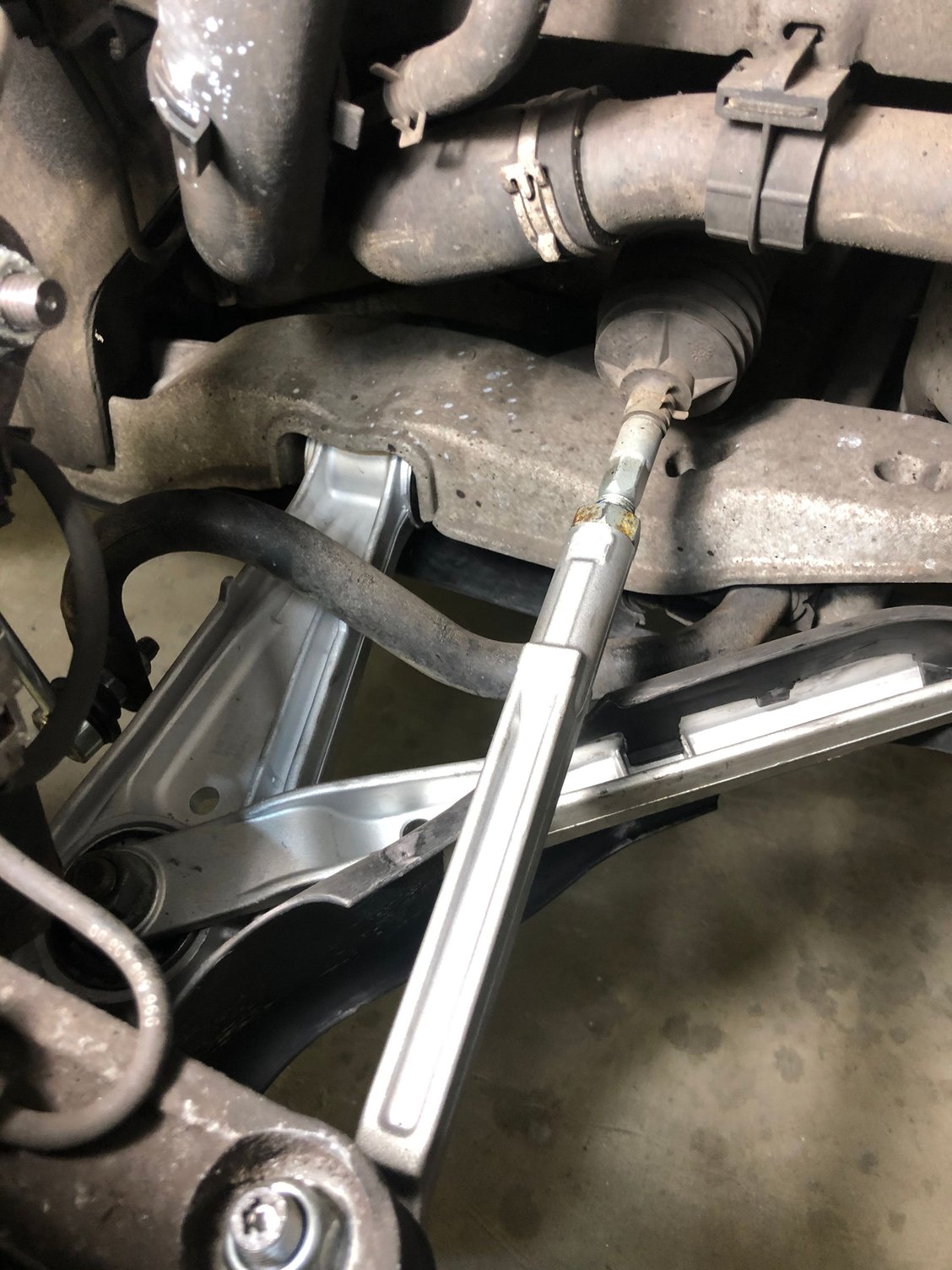

I did the control arms my self and set the cams and the tie rod ends back as close to the previous settings as possible. I marked everything before removal and set it back. That bent control arm was on the rear left.

Will put it on a lift and check all the torque settings too.

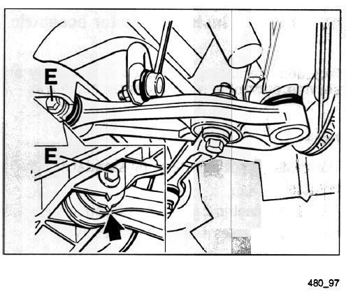

Make sure you aligned the control arm bolt before tightening. There are two notches that need to be aligned.

Pretty sure I did that. I recall it was in the manual to align those. Now I am second guessing myself.... Will crawl under and have to verify that. I did torque it under load as called for ever where these attach to the chassis.
