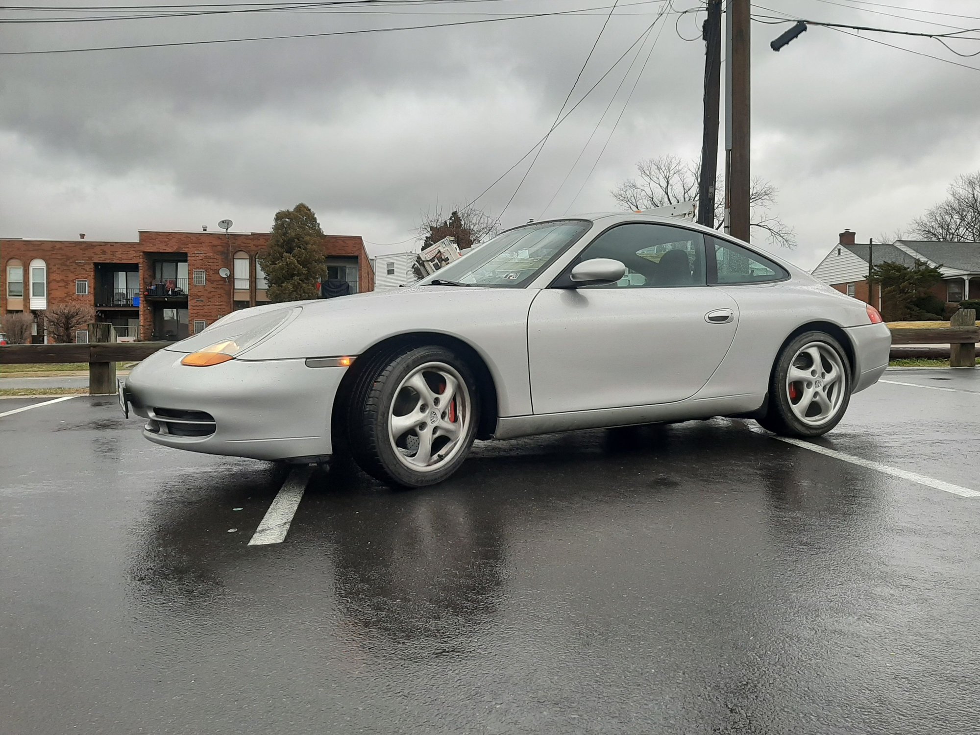

Cant wait until the weather gets nicer. Until then, rainy pictures will have to do
