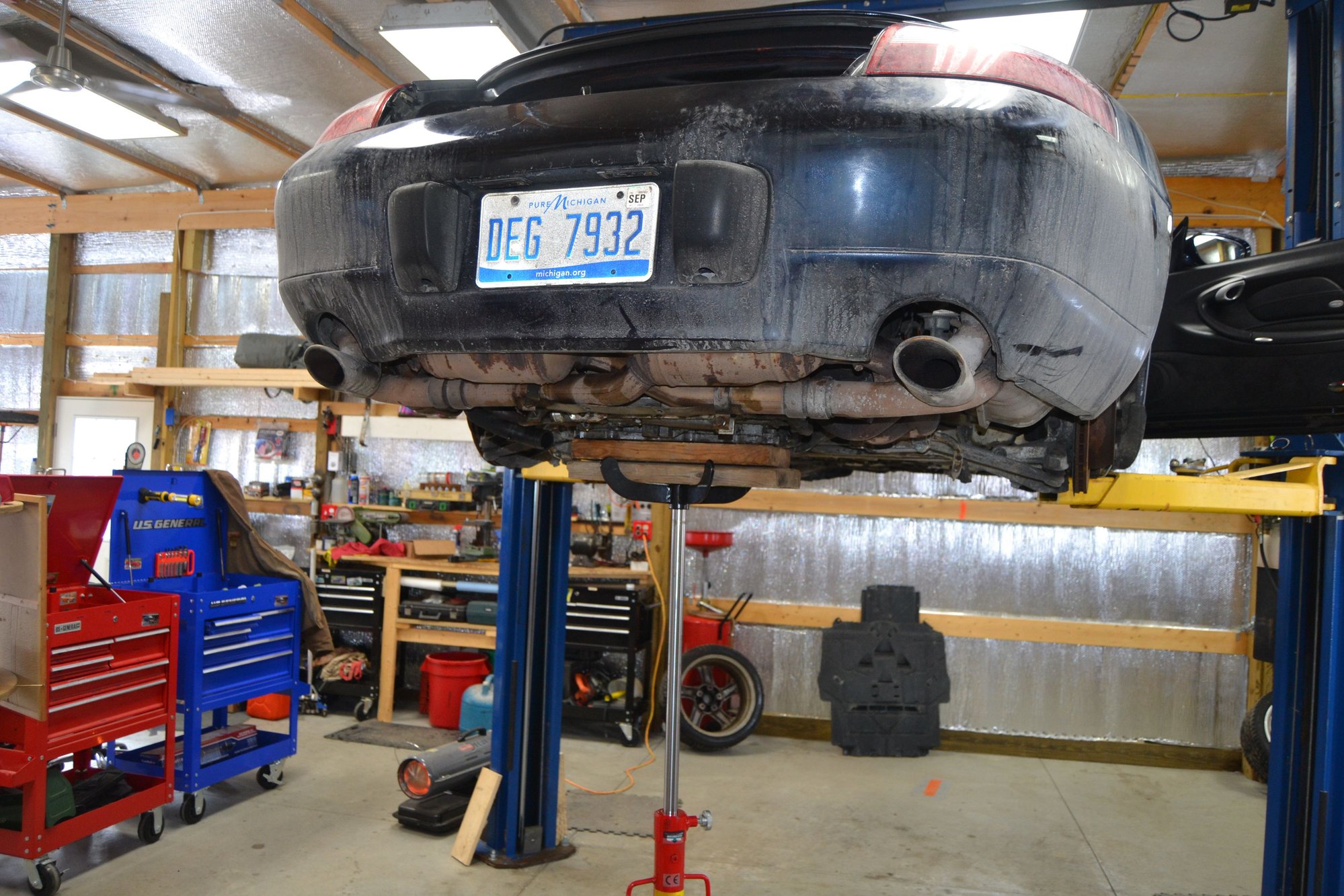

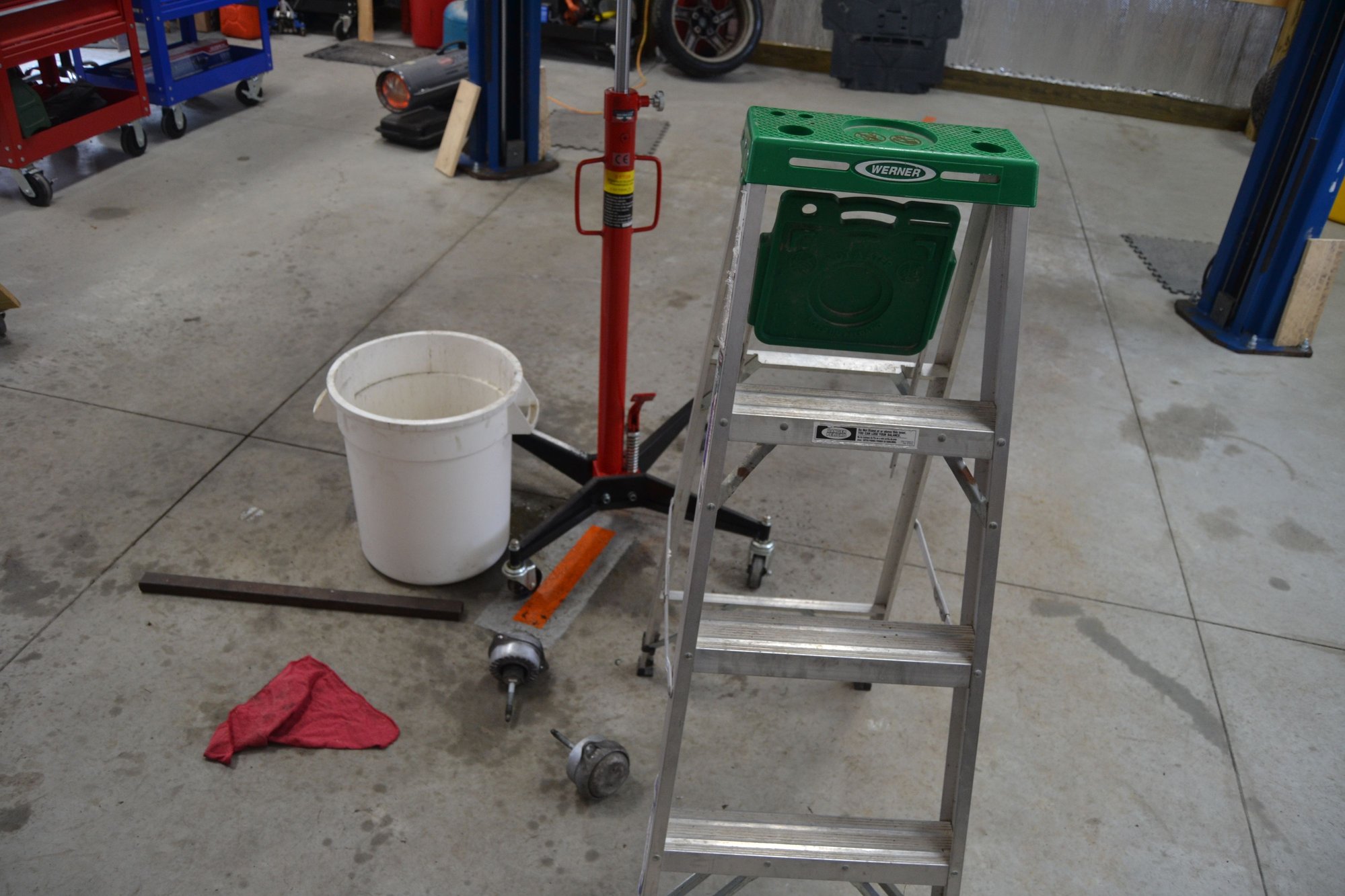

Did mine a few months ago. Same parts, same source. Not sure my after-discount price was that low, but not off by much.
Very easy job. The hard part is getting under the car and removing the nuts off the studs that point downward. But with a lift - that part becomes easy.
But with a lift, you need to support the engine and work from above to remove the upper bolts. I think it took me less than an hour.
