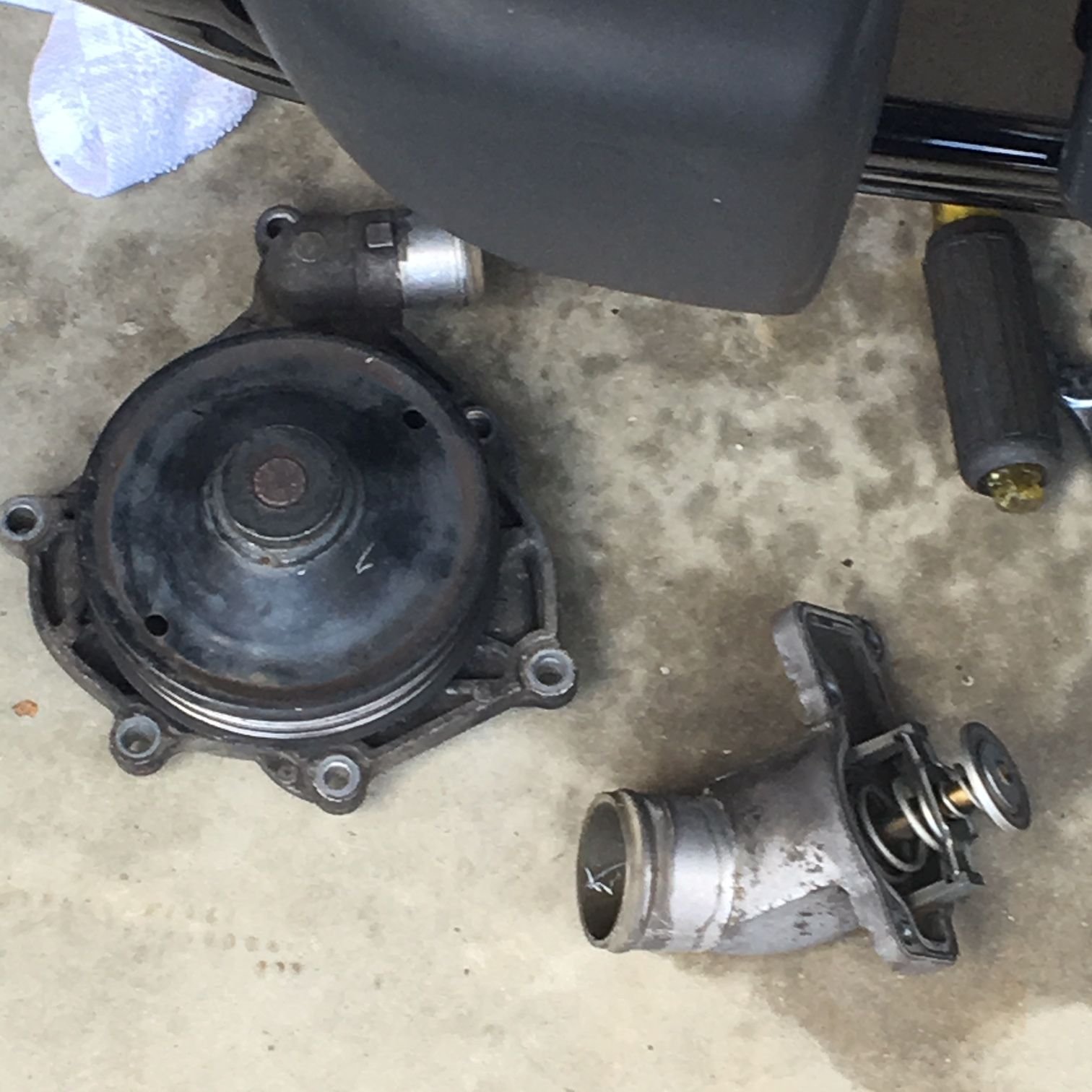

Guess what....after draining the system to change my leaking heater core...I went ahead and checked the water pump....not leaking..but noticeable play in the pulley and noisy bearings....I went ahead and removed the thermostat and water pump....waiting for the new ones to arrive to replace...by the way...Original water pump and thermostat....99 996

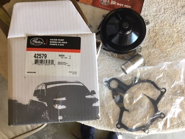

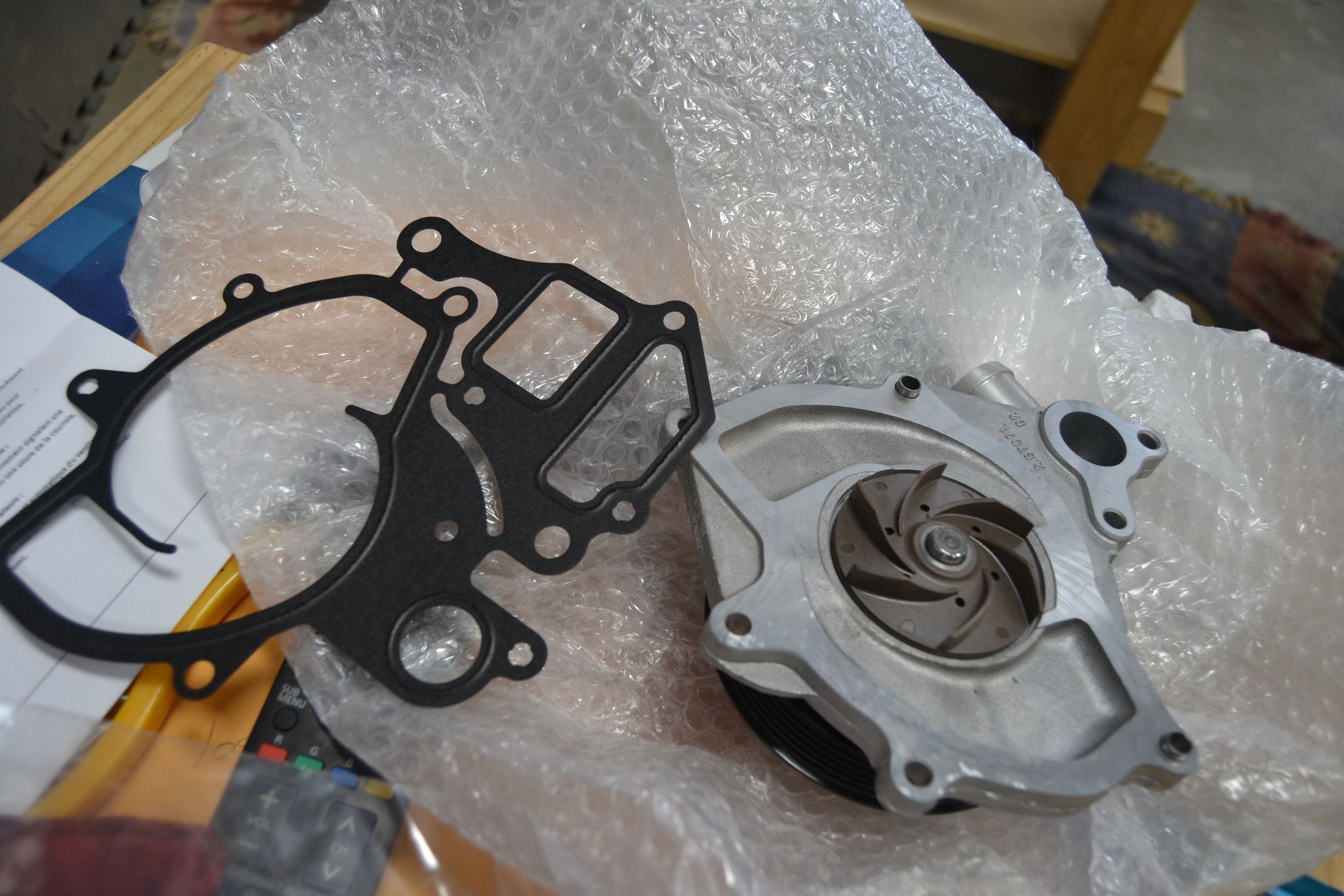

Unfricken believable, I just opened my Pierburg water pump box and they sent me an EGR valve of what I have no idea.

Maybe it's the latest upgraded type water pump? Sorry for that...where did you order it from?
Did you receive an EGR instead of the water pump?
The EGR is a gas recirculation valve, frequently used in turbo diesel for recirculating part of the exhaust gases to the intake to reduce the temperature in the chamber and with that, the polution
WTF ???
At least I got the right thing....
