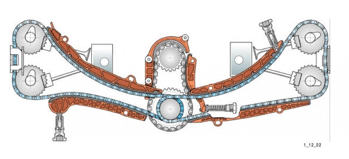

Cam deviation is the difference between where the cam timing should be and where it is. Bank 1 and Bank 2 indicate the side of the engine. Bank 1 is for cylinders 1, 2 and 3. Bank 2 is for cylinders 4, 5 and 6. Each bank has its own timing which is ran by a chain. If that chain is off a tooth, the tensioner pads or guides are bad, chain stretched and many other reasons can cause timing to be off can be detected by looking at the Cam Deviation.

"If that chain is off a tooth, the tensioner pads or guides are bad, chain stretched and many other reasons can cause timing to be off can be detected by looking at the Cam Deviation." Sorry, when you say tooth I think of a tooth on a sprocket. Bare with me on this one since I am always confused by all this. The cams adjusts the values that adjust airflow into the cylinders, is that correct? The cam runs off a chain that is connected to the IMSB which is powered by a chain from the crank. Is that all right? So is the cam deviation just saying the they are not opening as they should because of timing of the opening and closing or not opening/closing enough? Believe it or not, I have probably googled this 10 times. I shouldn't have sprayed paint in my garage without a mask.
