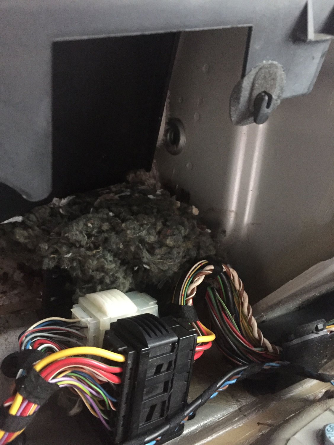

I have an 02 C4S with the ABS PSM light on. Having read many forums I replaced the brake switch which did nothing. Felt the MAF is probably fine as the car runs perfectly. I bought a Schwaben scanner and found a fault code for the left rear wheel speed sensor. I replaced it and although I have tried to clear it the code re appears without as much as starting or moving the car. I disconnected the right rear one and sure enough the code for it appeared and I was able to clear it once reconnected. I also have LED taillights and they were installed about the time this occurred, I unplugged them but since the schwaben is pointing to the wheel speed sensor my gut says its still in that circuit. I was about to order a replacement kit for the connection to the wheel speed sensor but mice have eaten away at a couple wires elsewhere so i'm wondering if there is a way to test the circuit before I cut into the harness? I was going to try a continuity test but read that doesn't work plus I don't know which pins to use .

I’ve already replaced the sensor yet still getting the code that’s it’s failed so I suspect the harness leading to it which is a known problem

I was about to replace the wiring harness that feeds the wheel sensor on that wheel as I’ve read they are a known problem where they attach to the wheel. Having pulled the seats and carpet to check the wiring prior to ordering one I found a wire chewed
off. Fixed! Yahoo! I had already replaced the brake switch and wheel speed sensor to that wheel. I should have swapped wheel speed sensors prior to buying one but was following the advice of a local Porsche mechanic as he read the code originally. I bought a Schwaben to clear the code myself after replacing the sensor. My suggestion to anyone working on one of these is to buy a code reader before replacing parts that are known to be troublesome. I was worried sick thinking it was my $1k LED lights or worse the ABS pump @ $3K.
