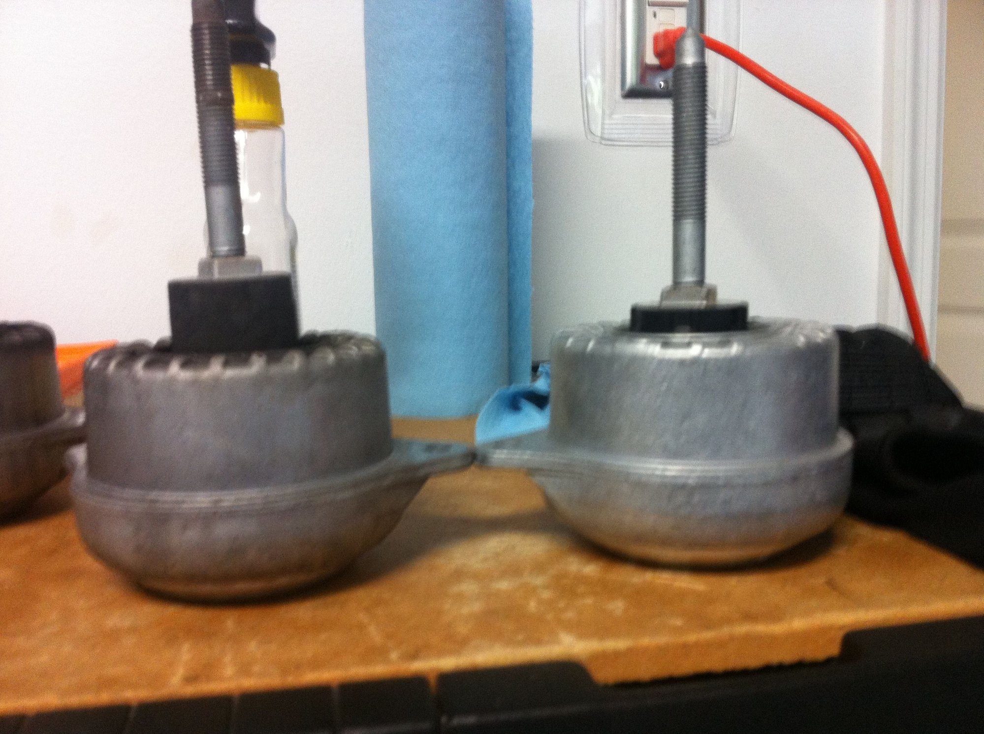

New motor mount versus old motor mount. With the weight of the engine suspended from the old mount I'm sure it probably dropped down another 1/4". I replaced mine with OE Porsche motor mounts. They were not that expensive. Makes a real difference in how the car feels.
