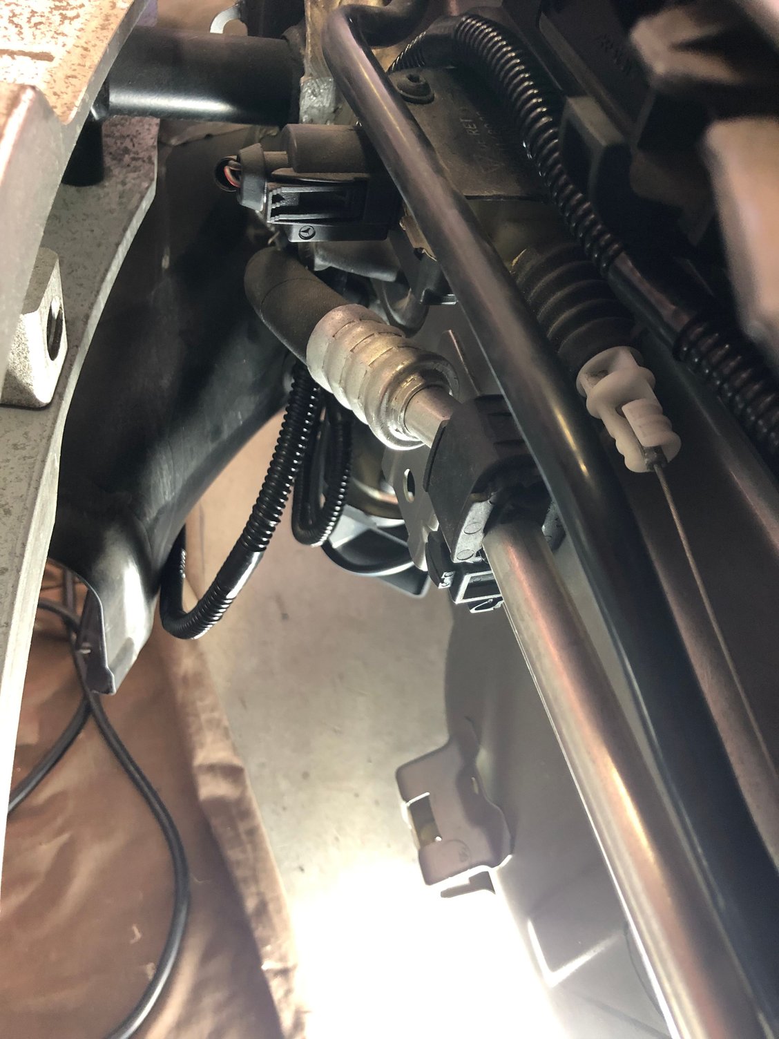

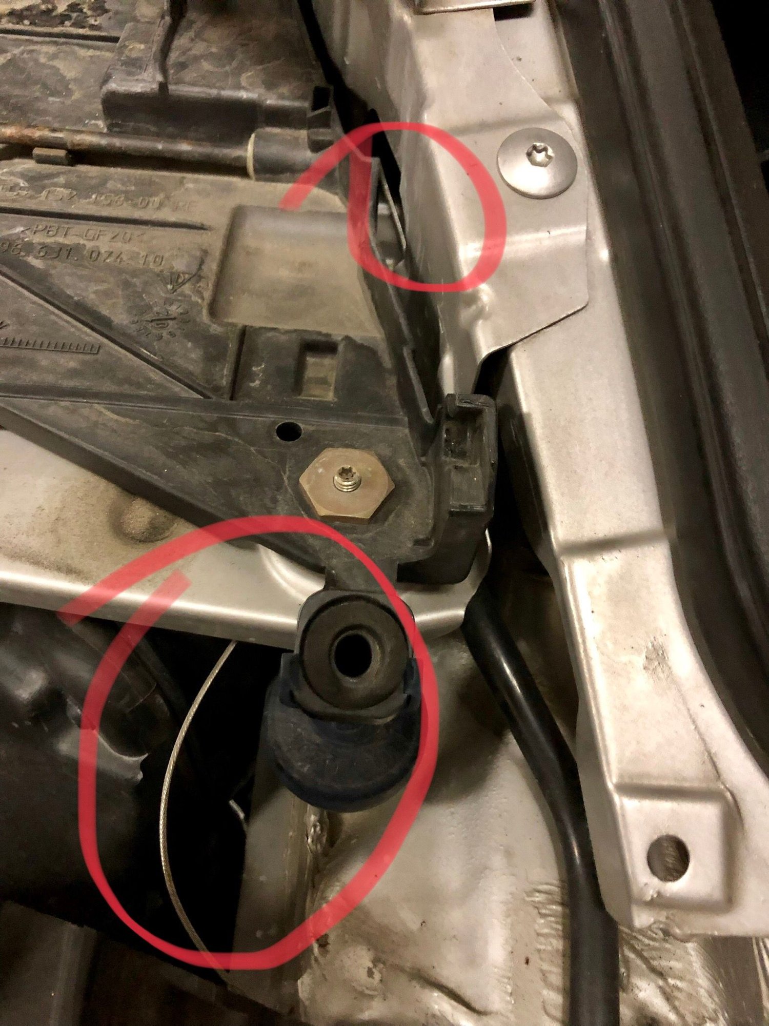

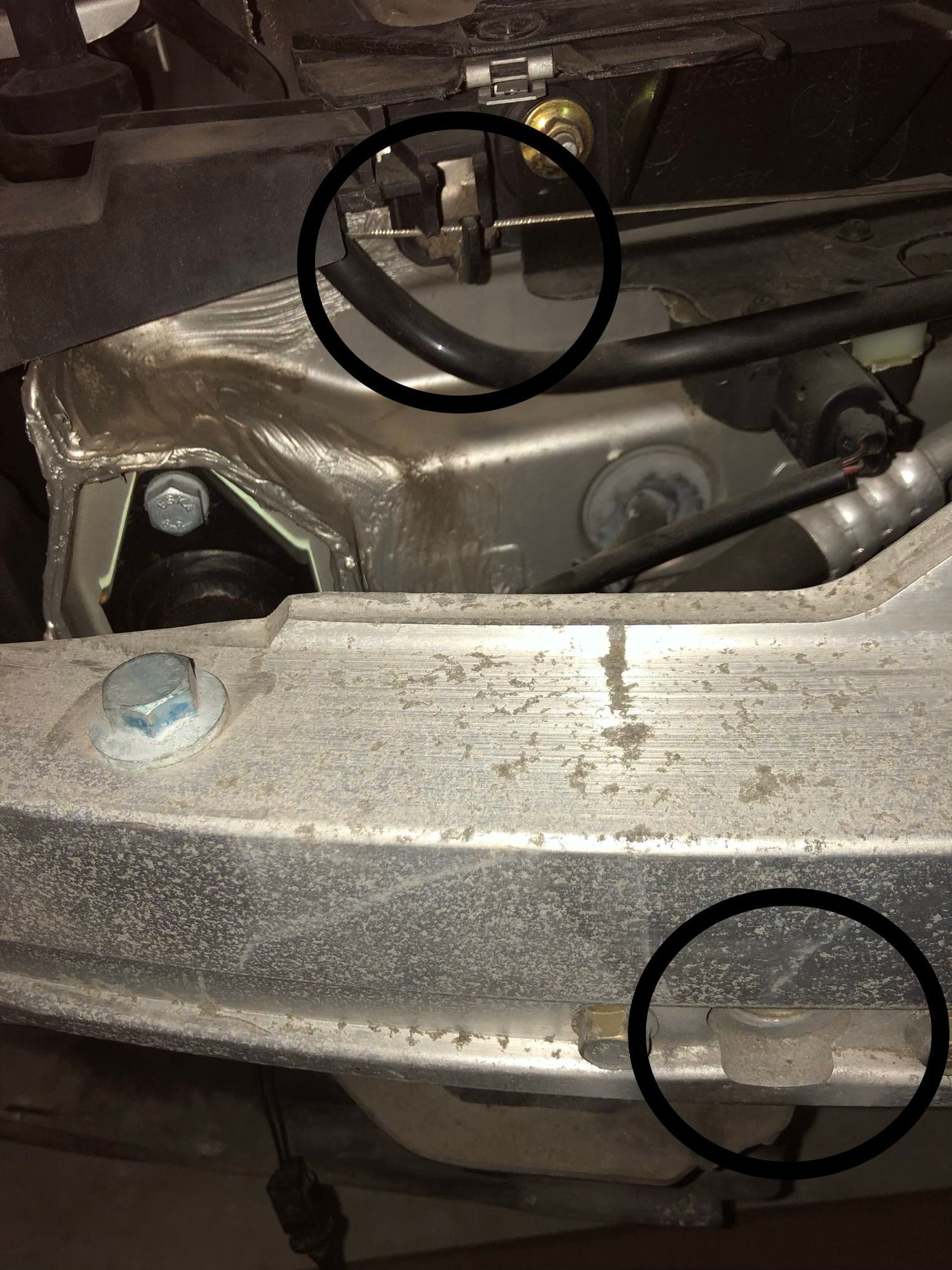

So when removing the front bumper to clean the radiators I noticed this cable after removing the passenger side headlight. It runs to the frunk release mechanism. The looped end is feed up to a location that I don’t think can be accessed without the headlight removed. Bottom circle shows the cable running aft and the top circle is the location of the loop. Any ideas? Thanks in advance.

Thanks for the suggestion. Wouldn’t this reroute cause the cable to bind in the keeper it is routed through (top circle) due to the tow hook location (bottom circle)?

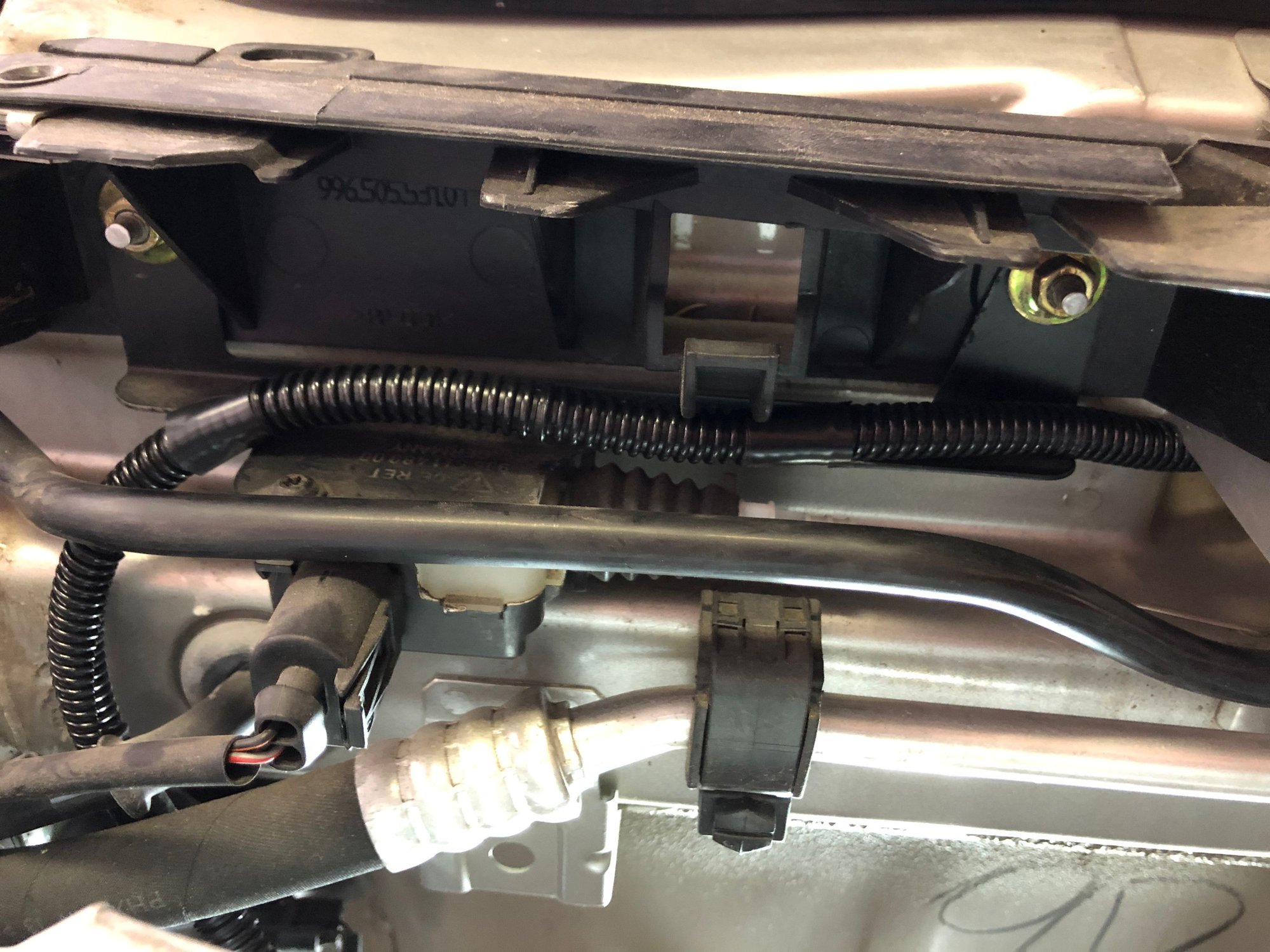

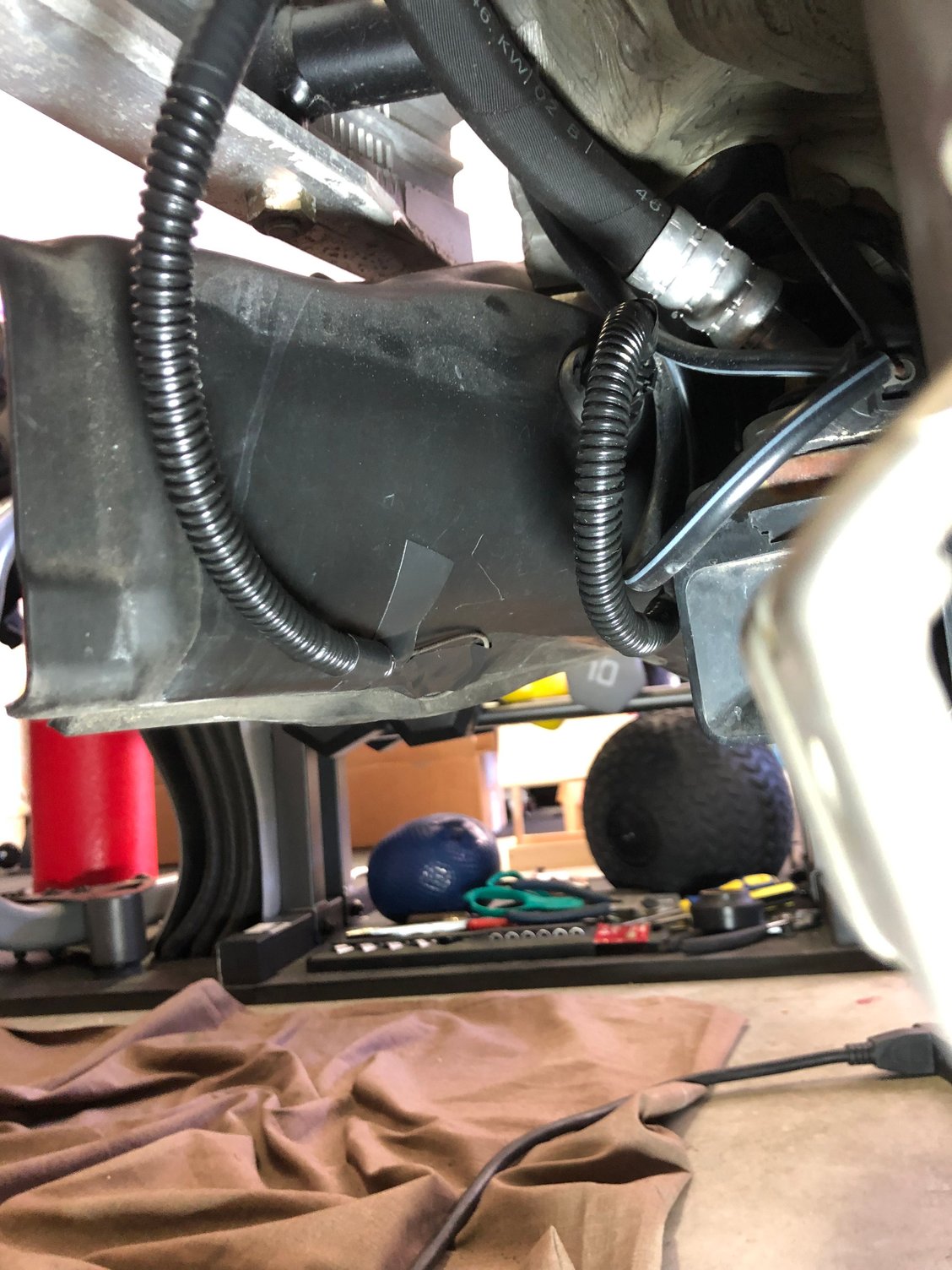

My solution. I removed it from the keeper and placed it in a loom. The end is taped to the passenger side duct. I can reach it from the far right large hole in the bottom of the bumper. It works fine and does not bind on anything.
