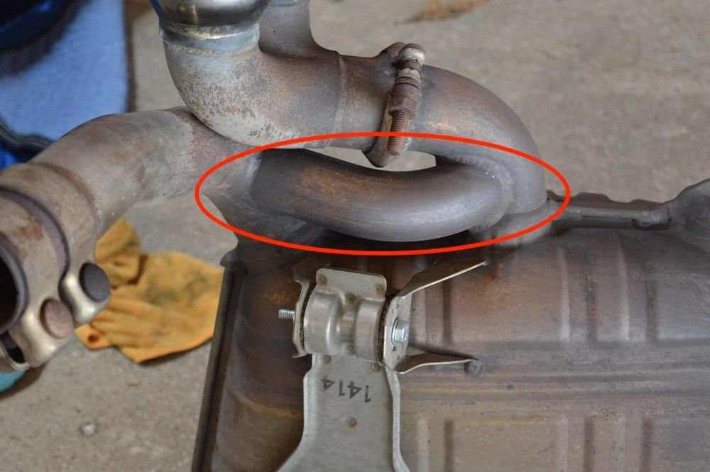

Someone PLEASE explain ..... Fister (or Gundo) is the short pipe welded from the intake to the exhaust side of the muffler....what is the "other" mod called, the one where the "sealed "port" at the other end of the muffler is opened and a pipe run to the exhaust side of the muffler???

Look at the photo Vipertag313 posted showing the Fister and the Gundo mods. Notice the bypass pipes - Fister and Gundo are two different designs. When the sealed opening is removed, it is the Gundo mod.

Default Fister Style Modification
@dak911
First photo below shows actual the 996 muffler with the Fister cross-pipe.
There are a few versions of the welded in inlet/outlet cross pipe. Fister locates and TIG welds the cross-pipe on the engine side of the muffler just above the mounting bracket and many local shops locate it on outside/bumper cover side of the muffler and MIG weld it. Locating it on the bumper cover side places the cross pipe very close to the bumper cover (heat) however there is insulation inside the bumper cover.
The Fister design and welding is clearly the least visible and best, however the mod is not visible outside the car so perhaps it does not matter.
