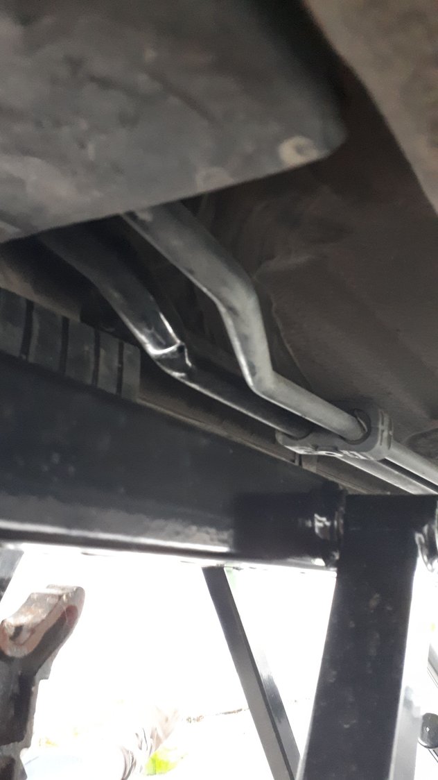

Hi guys,
Im trying to figure out what type of hose this is.
Ob the passenger side of my 02' C4S it goes from around the fuel tank to the back of the car.
The hose has been damaged by someone who tried to lift the car..
Its not leaking or anything and I guess the damages have been done few years ago.
I just want to see if it can be problem on the long term.
I guess this is a heater hose or something but I prefer have your opinion.
This is the front passenger side just behind the front wheel.
As you can see its close to the car jacking point.
Thanks
Hugo

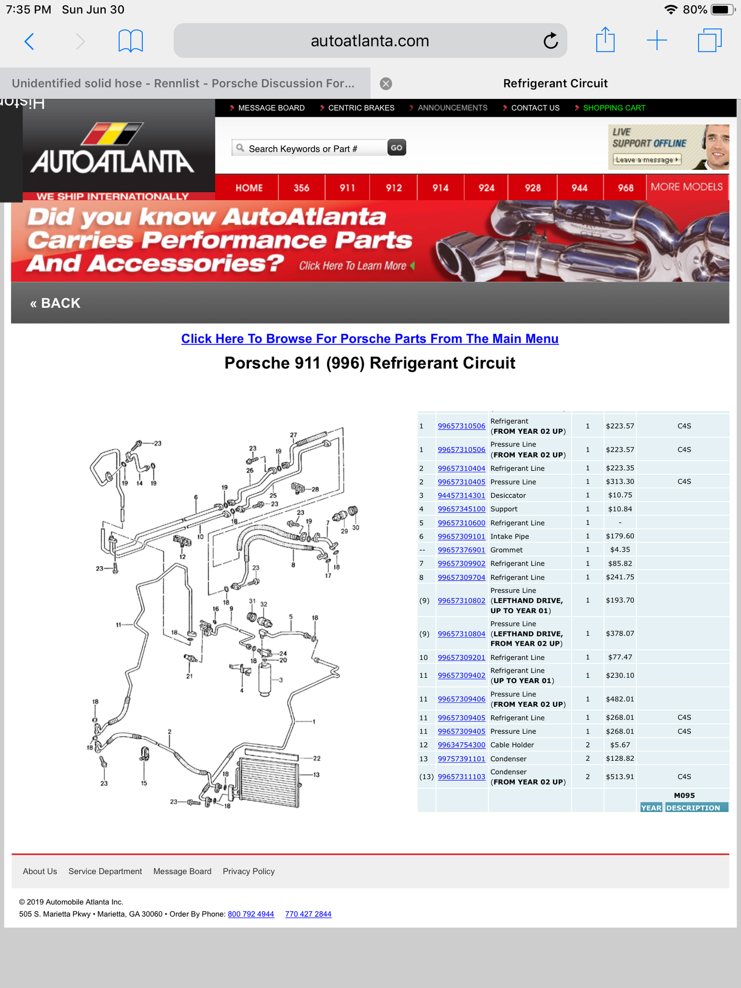

A/C refrigerant line.
item 10 in the pic
Old Jun 30, 2019 | 08:50 PM
Os7213's Avatar
Os7213
Joined: Jul 2018
Posts: 272
Likes: 39
From: Qc,Canada
Thank you!
From the position I think its part No 6.
Ill put that on my to do list...
