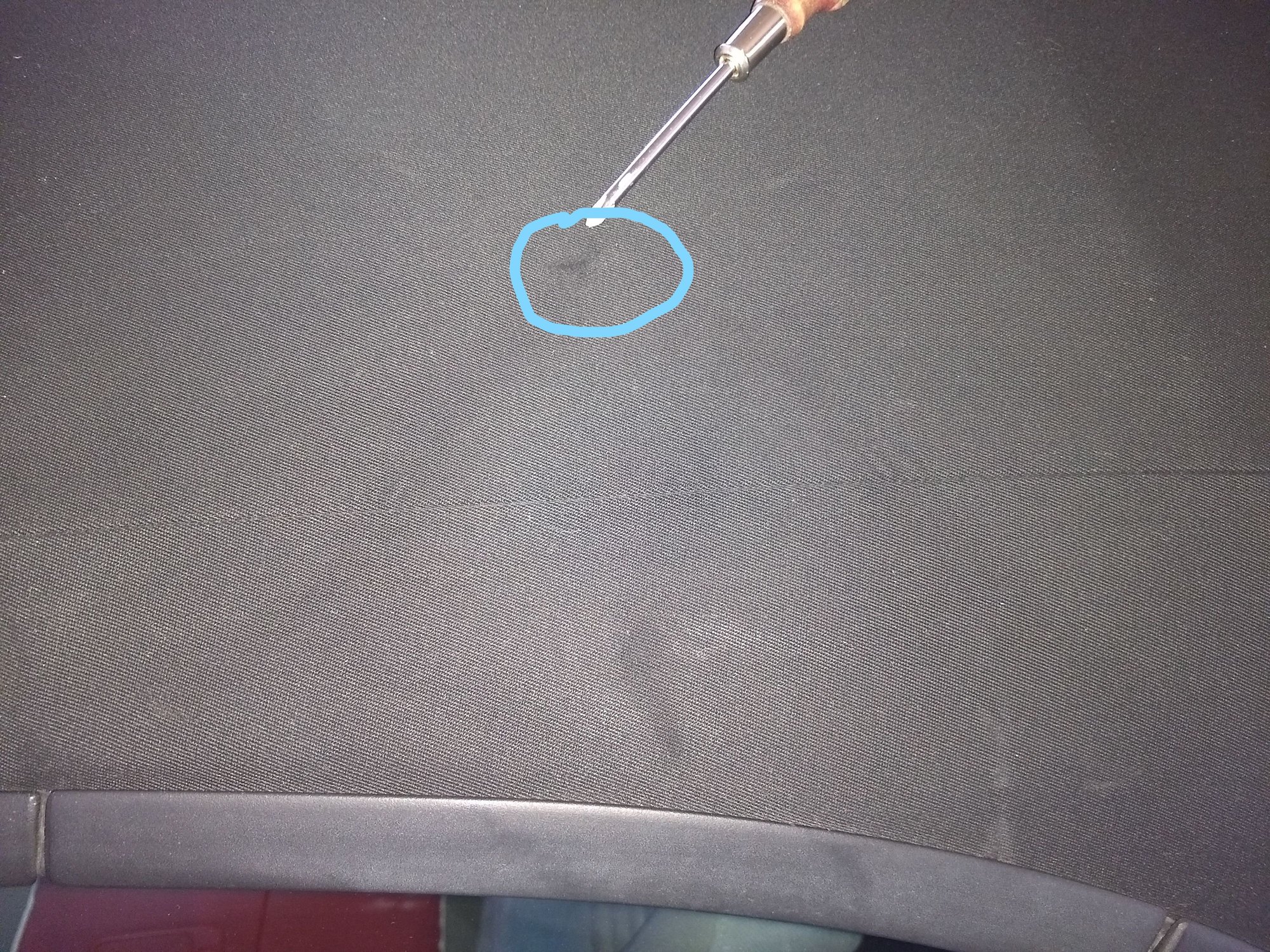

It sure was an easy process to get at the hydronic fluid reservoir.
My problem occurred when I thought I was done.
I drove around with the top down all day.
Then the **** hit the fan. I put the top up at the end of the day.
Thats when I noticed a problem the material almost too dead center. I hope I could stick my key it along with some smaller ones. M not overly worried about them. I can deal with this using a pool patch from inside the car.
What ah need is the solution. At the back of the car in the center is what looks like a latch of some sort. It has a plastic flap. I much have installed it wrong. Let this be a warning to anyone going in there.
So upon inspection I find the piece laying off to the side.
Might be snapped off I’m sure I can get a used one for cheap.
Question is what did I do wrong?
Has anyone else experienced this?
I just got the dang thing road ready .
bummer

I’ll put up some pictures tomorrow. I believe I know what occurred. After I put the tray back on in the very back there is a lock mechanism I think. I believe it’s used to lock in the back section of the cab. There areas a cheap flap that is likely used prevent the fabrics from getting pinched. I may have installed it improperly. When I lowered the top it got the pinch/holes. One is big enough to put the key in the others are smaller. I already looked for patches and there are some good choices. If I can get the patch on inside it will be barely noticeable.
Am I mistaken or are all the 1999 Carrera tops vinyl?
Im so bummed out. I try hard to do things right. It sucks when it blows up in your face..
i need to repair this perfectly.?
do bummed out

I had the same thing happen about 1 month after having a new top installed. Have 2 small cuts in the fabric now :-( The plastic cover you mentioned has a spring loaded flap that protects the top from snagging on the cowl latch catch. The plastic gets old and brittle and breaks easily. New one was pretty cheap and easy to replace. Think it had a couple of plastic torx head screws. Replacing this will fix the problem. Guessing by your description it is part #9 in this diagram? http://www.autoatlanta.com/porsche-p...section=811-12
